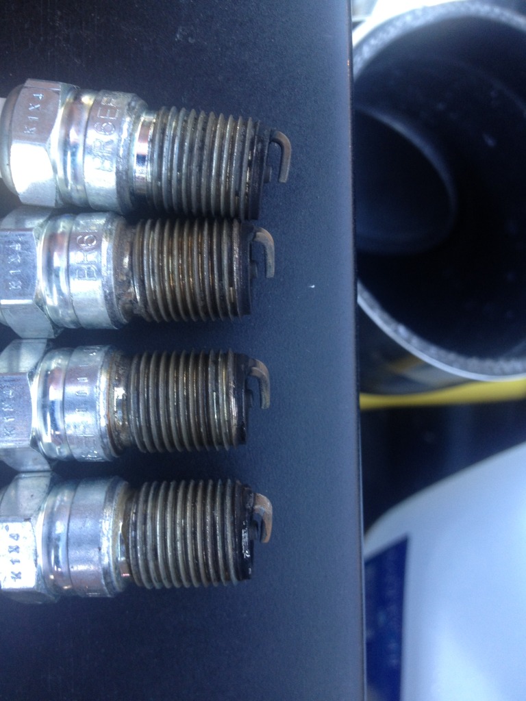

Passenger side plugs
Bottom is 2 top is 8
2-I couldn't fit my gauge in about .01
4- .04
6- .04
8- .036
All started at .032. Br6ef plugs

Wooo, not a good sign on the #2. How long have those plugs been in there? Mileage wise?

Since I put the procharger on. Maybe 5-6k miles
Drivers side plugs were all between .033-.040

Ya #2 looks like it got slammed some....

It also looks like it was a tad hot

Idk. I did drop it as it was coming out. Not sure if it tip hit the ground
