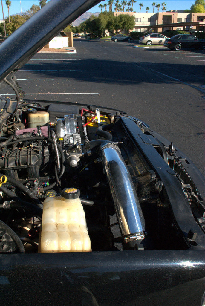

its a ebay 27x8x4 and I upgraded to a 4" intake tube. I ditched the stock MAF and wired in a aftermarket IAT sensor.
Old Dec 29, 2012 | 07:17 PM
  #1028
GMCtrk's Avatar
iTrader: (27)
Posts: 12,275
Likes: 19
From: Dallas
Nice man. The new intake tube looks slick.
