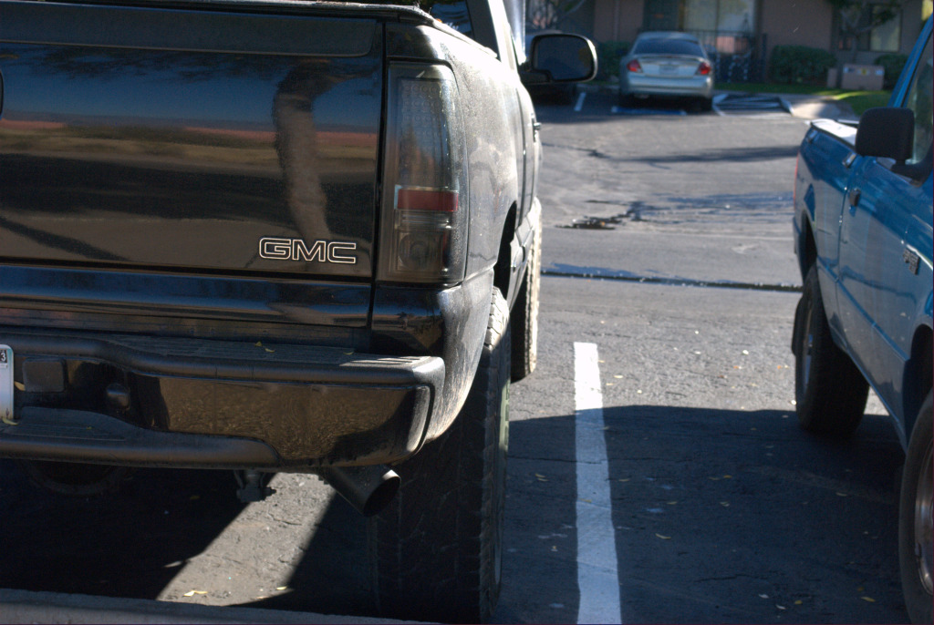

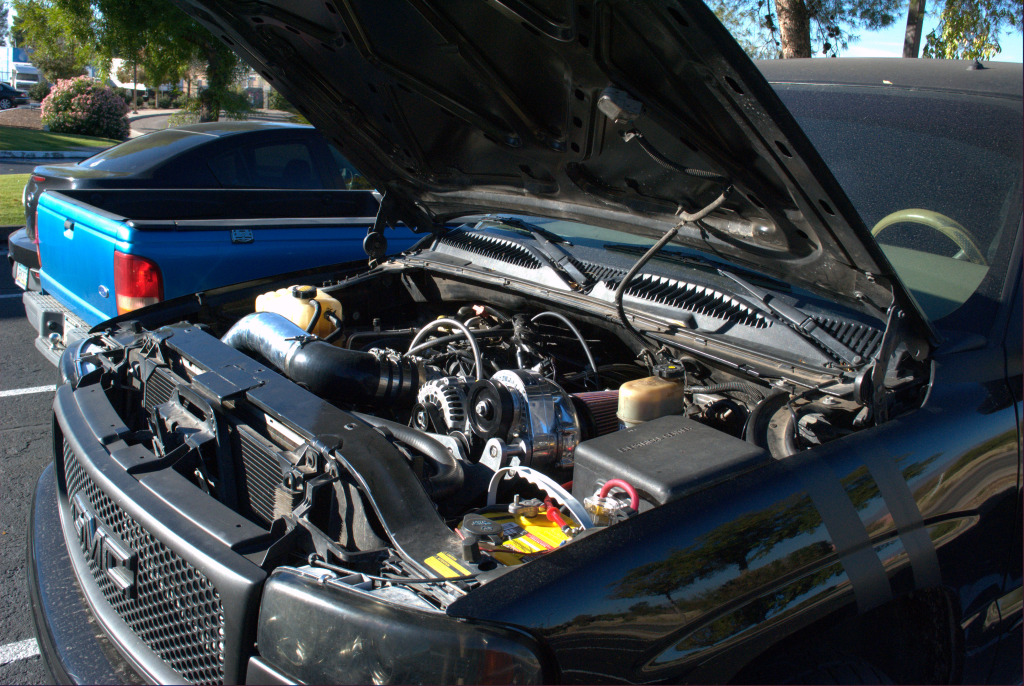

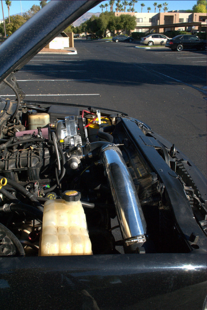

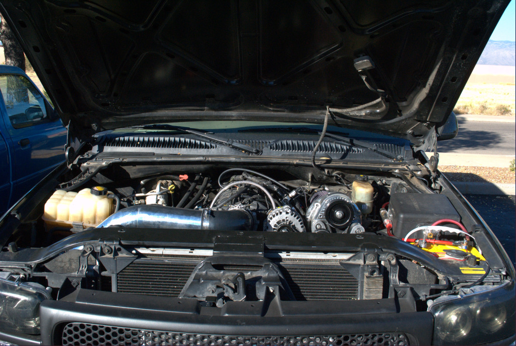

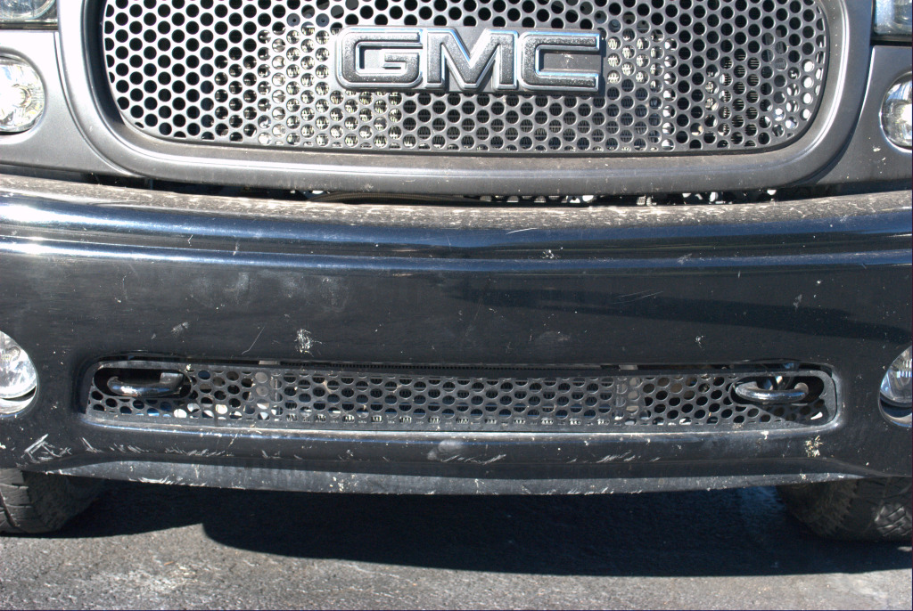

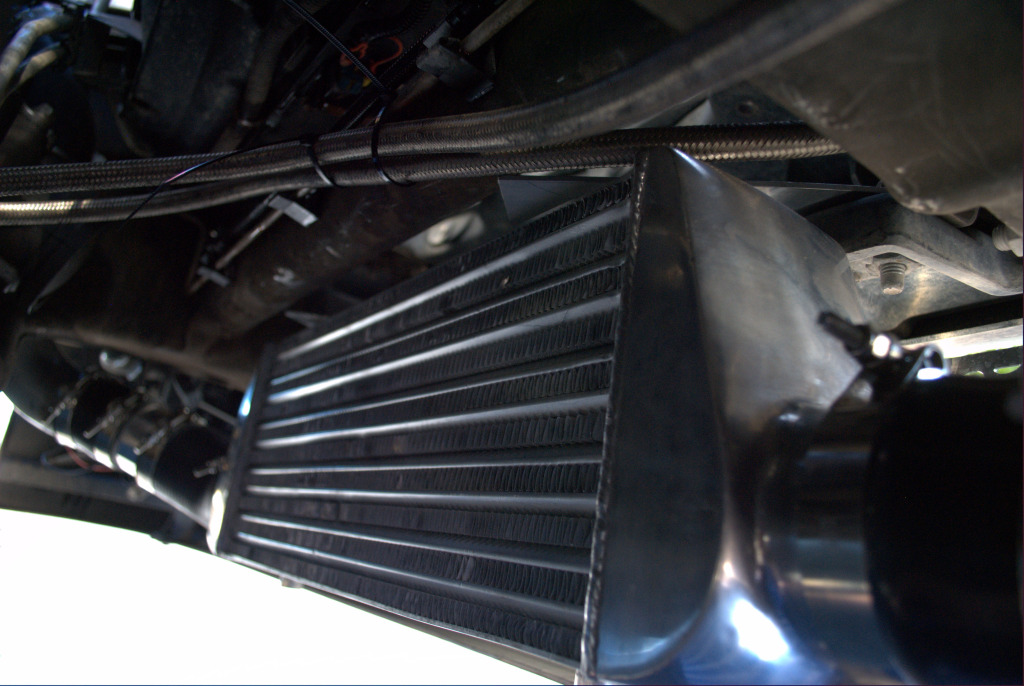

nice. Im about 5.5k left on mine. What fuel line? I found a slight leak at idle where I had the -6an plug in the FPR, must have been spraying even worse when the pressure went up to about 62 because it never went over that. I swapped it out for a strait cut -6an with oring and no more drip. so once the truck is back on the road I'll see what it does.
I took some decent pictures with my nikon. Truck is very dirty and I cant wash it so.
all of the scratches are from my off roading adventures. soon to be fixed.

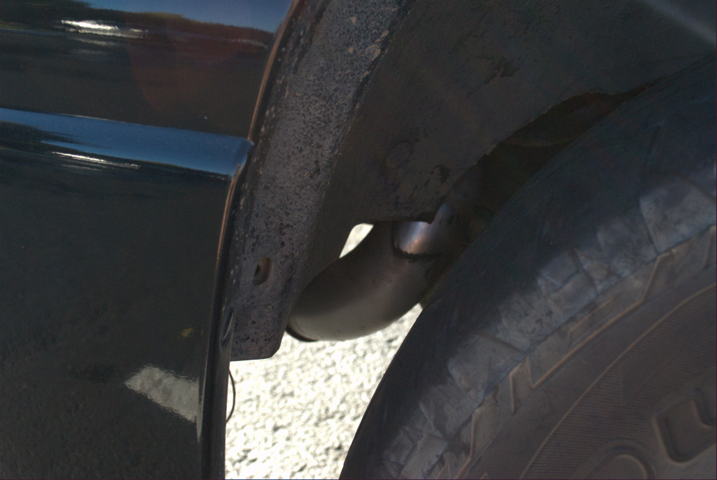

this is where the tire was rubbing on the tube on the drivers side. I was able to move it down and in so it will not rub anymore
and a pic of the 4" tail pipe
