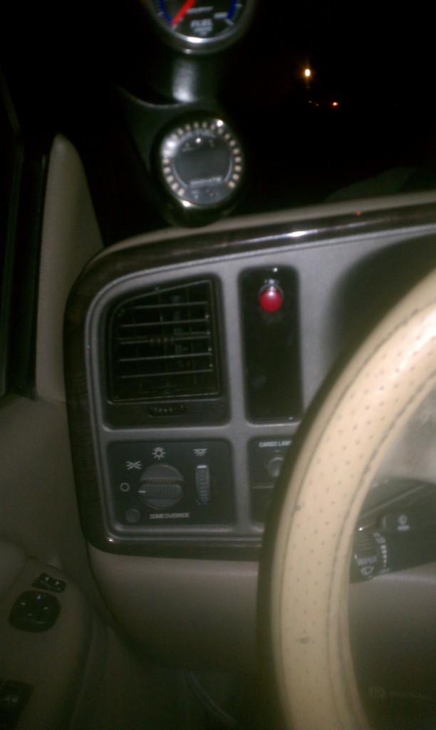

Valet mode/two step activation switch.
Just loaded the updated tune to activate the two step. Set it at 2600rpm for now. I'll raise it if it works
