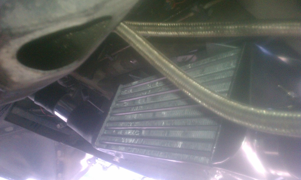

Got the intercooler mounted
its right behind the lower grill. About 4" away from the grill so it should allow for the coolest air possible. Will eventually make a shroud to force the air strait through the intercooler. Just need a 3" 45* bend to connect the intercooler to the intake pipe.
And some nice new shiny t-bolt clamps to hold everything together

Why the switch of intercoolers? I was always under the impression those procharger cores were farely decent.

The procharger intercooler is decent. My iat went from 100 to 170 on a 9 second pull from 70-120. It was 80 outside. The new intercooler will allow the air to flow directly through the intercooler. Which will help the iat.

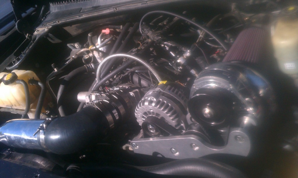

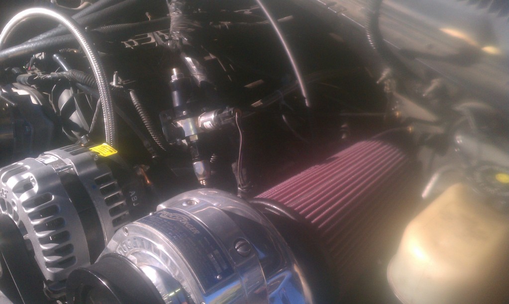

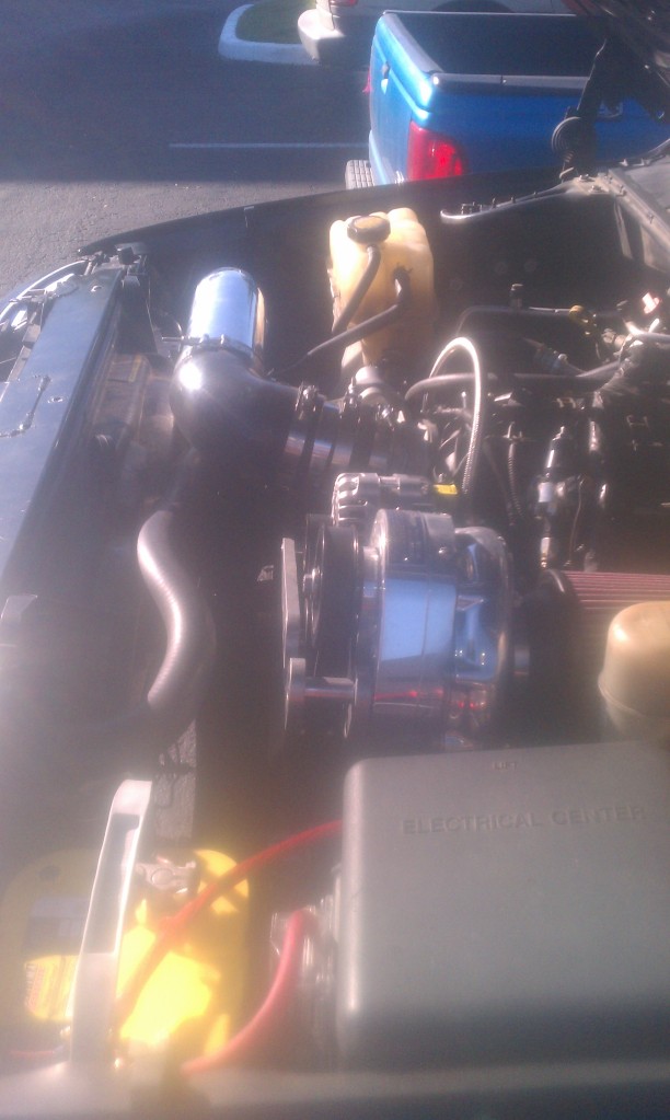

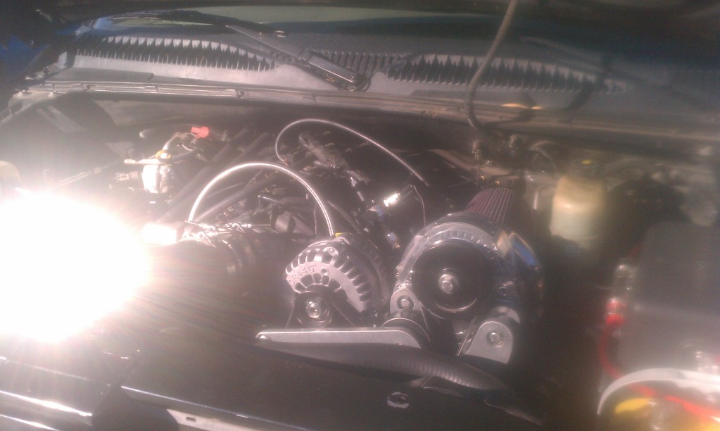

Picked up the intake tube with the bungs welded in this morning. Got the iat sensor installed and everything tightened down. Still need a 1/8npt bolt for the meth injection bung to seal it up until I get the meth kit installed. But it felt good to hear the truck start again.
