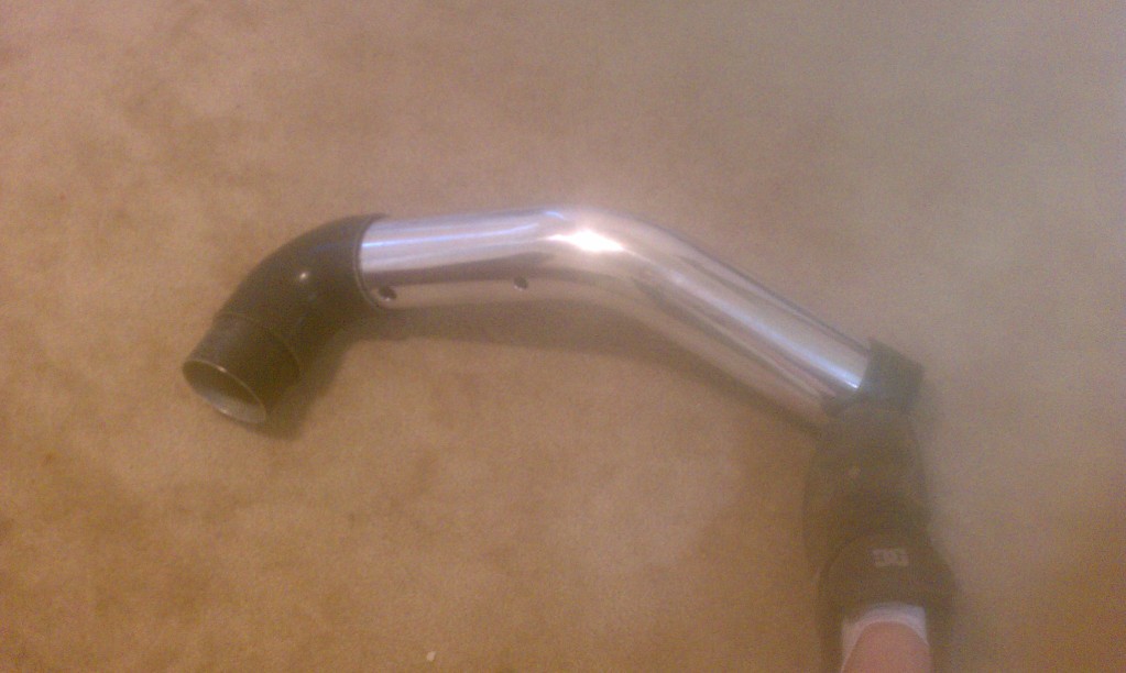

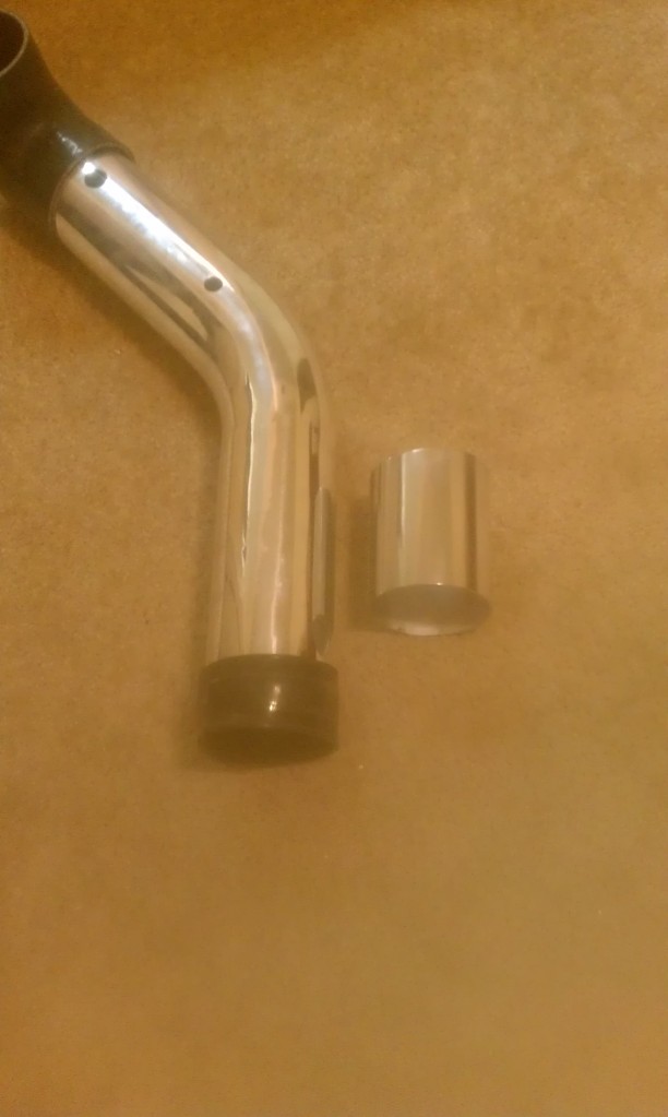

sanded the black paint off. left with this
started polishing it
next to the chromed intake tube
the holes in the tube are for the IAT sensor and the Meth nozzle

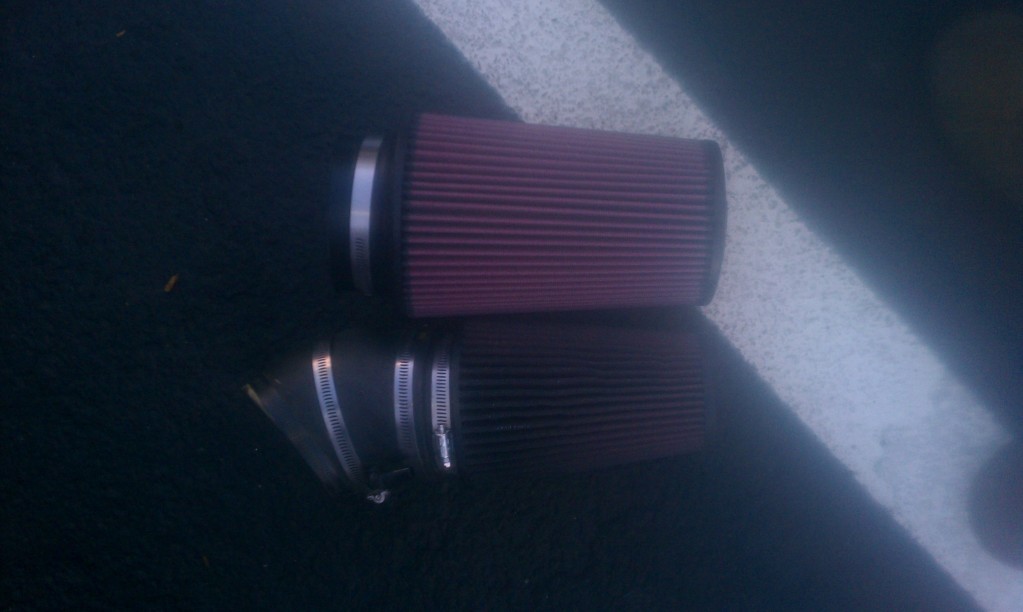

well since the truck is down I figured it would be a good time to start doing some of the things I have been putting off.

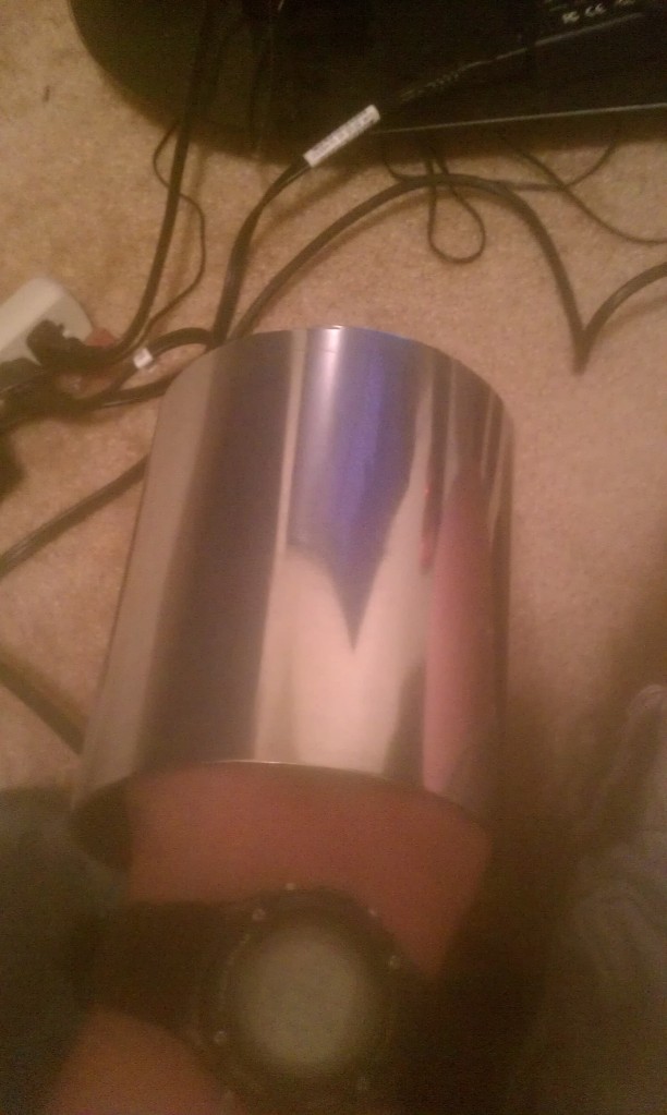

New filter

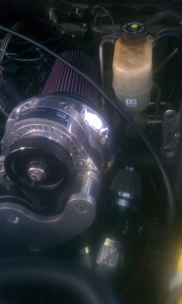

the By-pass valve with filter

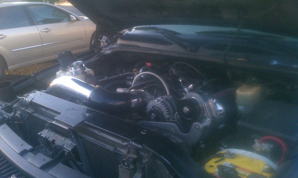

started mounting the intake tube
need to figure something out, the tube is hitting the hood. I may remove the cloth stuff under the hood.

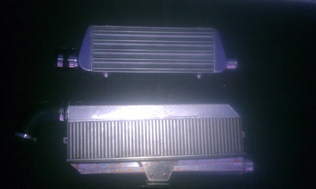

top is the new FMIC, bottom is the Procharger 3 core
the new intercooler is a 27x8x4 with a 24x8x3.5 core. should work nicely. Just need to figure out how I want to mount it. Will have to trim some of the bumper supports to get it to fit right behind the bumper and will need a few more 3" 90* bends, or I can keep it strait and mount it about 1.5" back directly under the efans. that way would be easier.
I also got the piece on the drivers side moved to where it wont rub. I may be dropping the truck 1/2 once I get some shocks that fit. Currently running Bilstein 5100 for a 0-2" lift
