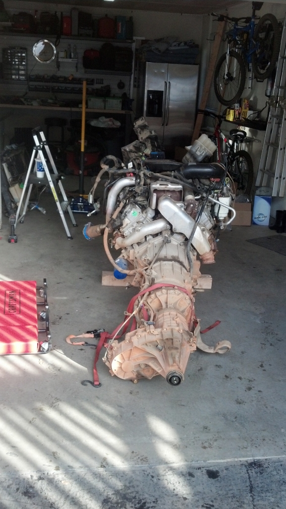

Got the driveline pulled this afternoon. What a bitch! The wheels on my cherry picker started sinking into the asphalt since there was so much weight. The beast is finally in the garage with the neighbor's help.

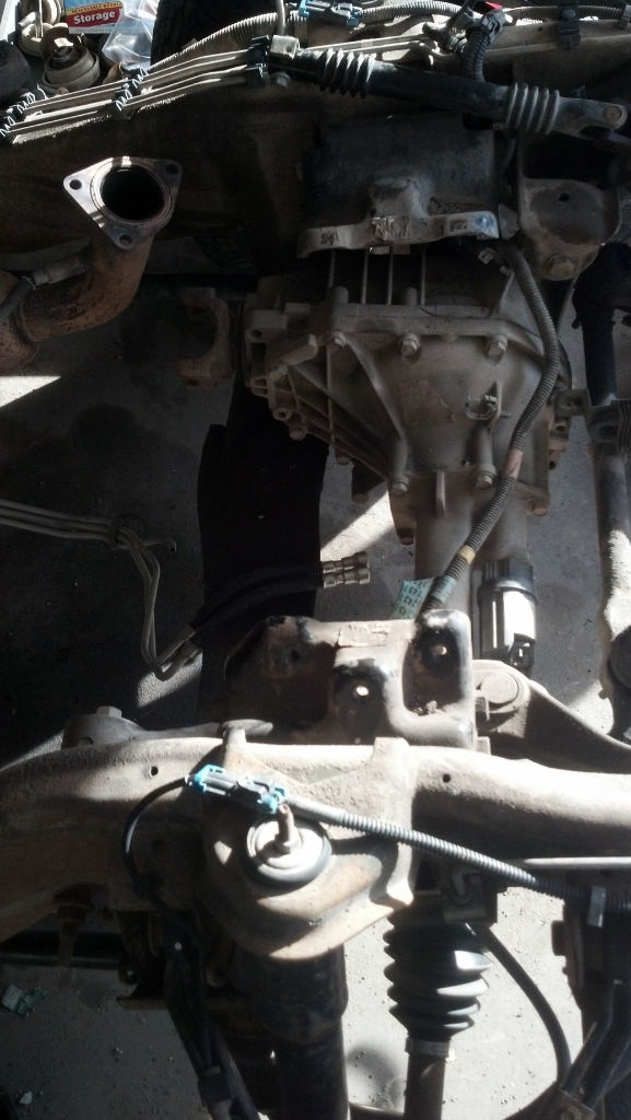

Finally got to take a look at the motor mounts. The driver's side is in the same position on both the 1/2 ton and 3/4 frames, but the passenger side sits about 3" further forward on the passenger side. I was planning on running adapter plates to get the LS mounts to bolt up to the Duramax, anyone have thoughts on whether or not I can just make up that 3" difference in the adapter plate? Or am I going to have to cut and weld the 1/2 ton frame pad?
1/2 ton frame, the two frame pads are the same distance from the front of the truck:

3/4 ton frame...the passenger frame pad is forward of the driver's side by about 3"

Hmmm....from his pics, it doesn't look like he is compensating for the 3" difference between the two sides. I'll shoot him a message.
Hey Chris, just a random thought here....
Any chance that GM has two different sets of holes in the engine block for the right side engine mount? Perhaps the vans mount differently than the trucks?
