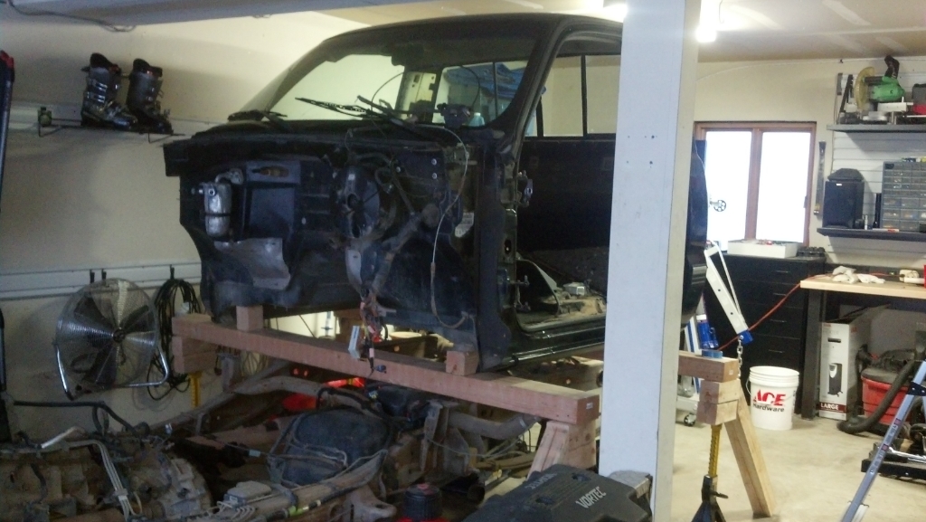

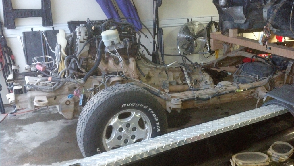

Teardown progress. Took me about 4 hours to get the body up off the frame...what a pain in the *** without a lift.

Why not just use straps through the body and an engine hoist to lift it up? Poor mans lift
My hoist won't go up far enough If it wasn't snowing all day today I would have built an A frame in the driveway and used the winch on my 2011 and a ****** block to lift it up.

Body is off, Now what are you going to do with it???

**** if I know, lol. Just leave it there until it's ready to go back on the frame.

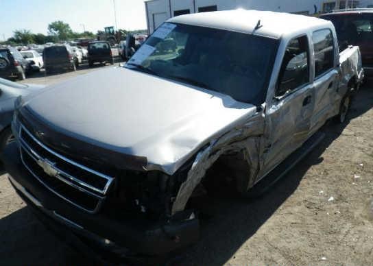

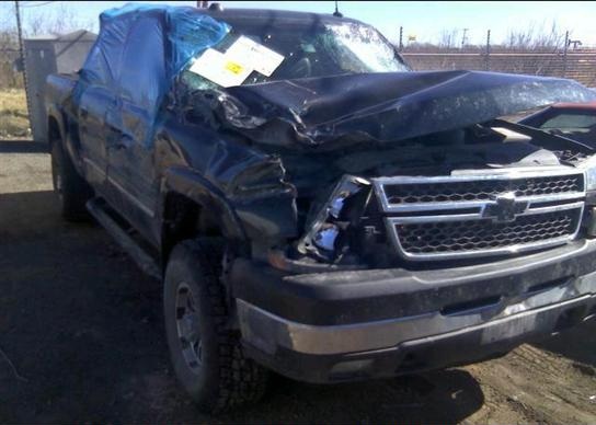

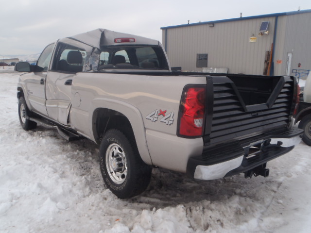

These three are coming up for auction this week. Trying to decide if the one with the front wheel ripped off is worth bidding on, it's an LBZ, and the other two are LLY. I still haven't figured out exactly what is required to put the 2500 front suspension on the 1500.
