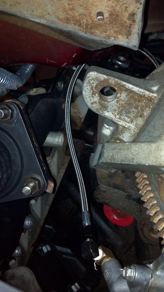

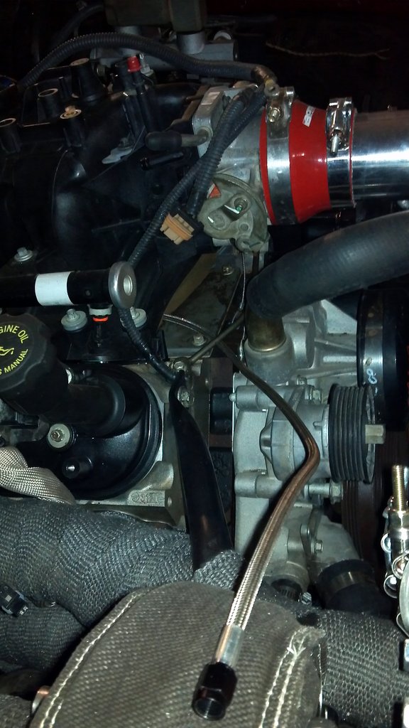

Hey man you think you can get me a picture of the feed line.
I didn't make it to the shop last night, I'll do it tonight.

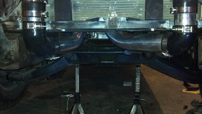

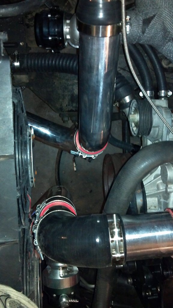

Originally Posted by SuperStepside
I has some questions.
Any pics on the intercooler mounting and pipe setup? Also for the tranny crossmember is that a custom made one? Ive seen other people just move the stock crossmember back and re-drill new holes which I was planning on doing.
Forgot about the A2A mounts I made lol, I'll make some more lol
From the turbo to underneath the intake:
From the oil supply going up:
Old Aug 31, 2012 | 08:02 AM
  #76
SuperStepside's Avatar
Joined: Apr 2012
Posts: 53
From: Miami, FL
Looks good. I see you notched the core support to get the pipes to tuck closer. Good idea. Is the sway bar on the truck in this pic? Looks like you'll have good ground clearance when you get it on the ground.
Nope, I'm not using sway bar lol, I was digging through some of my older pictures and found this one, kinda shows the brackets.
