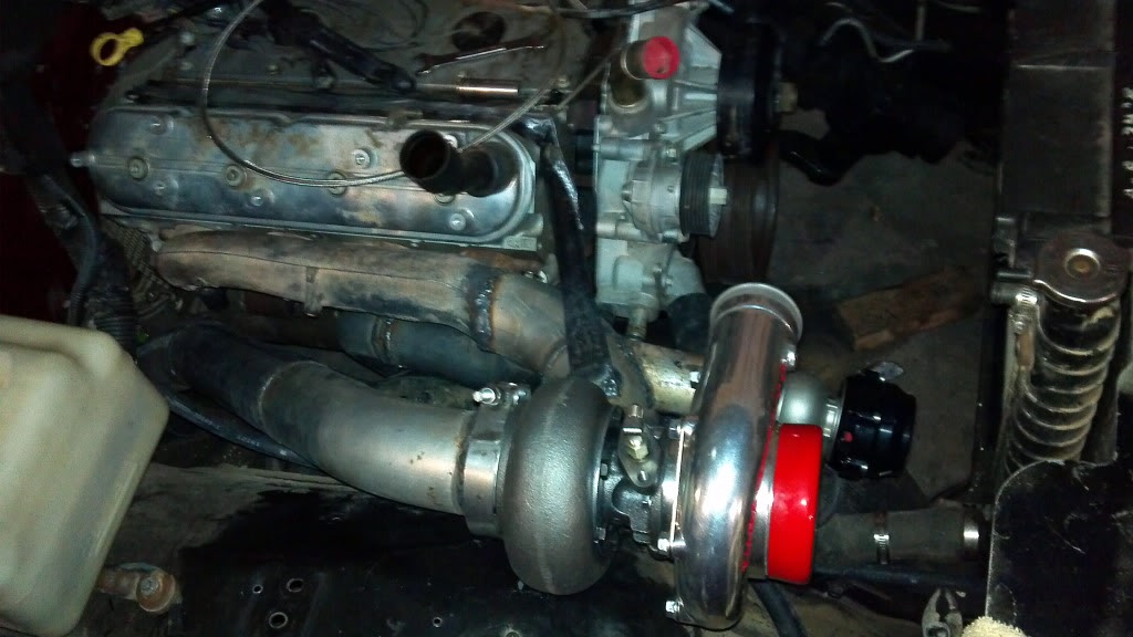

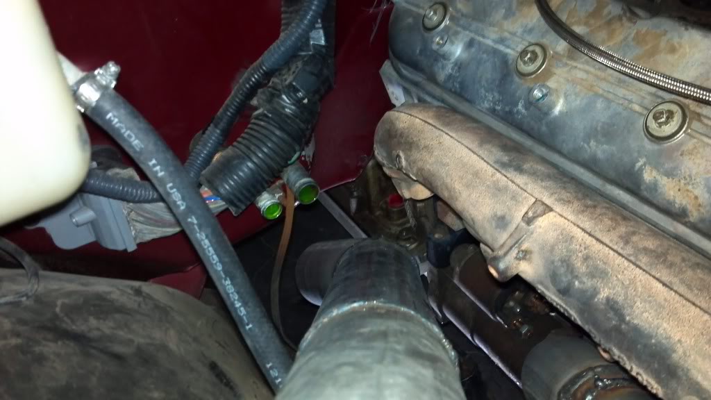

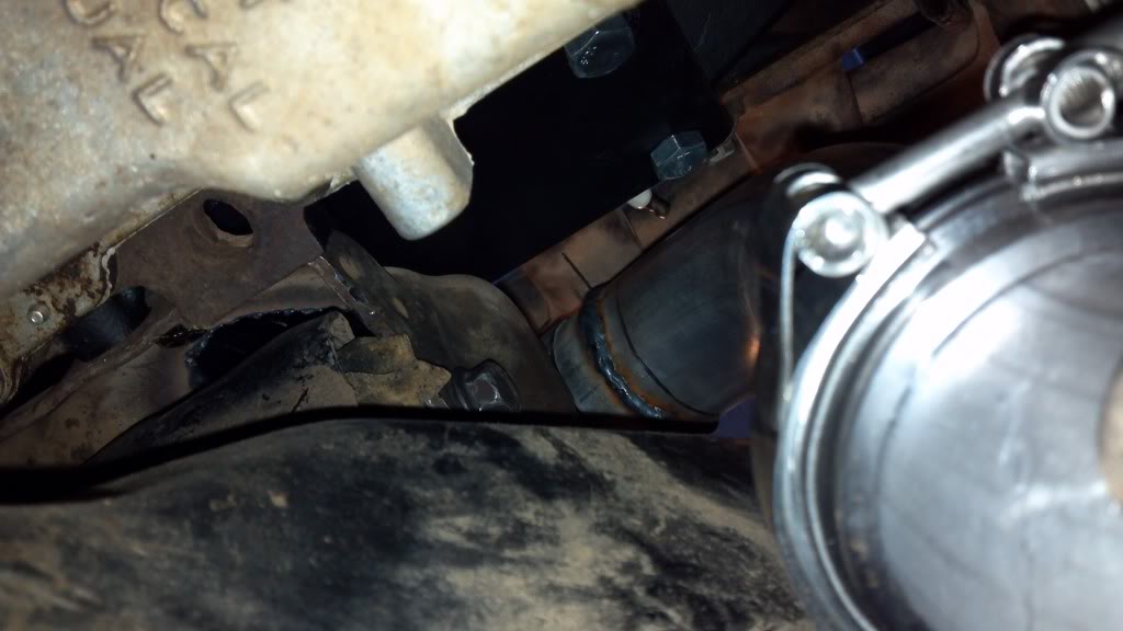

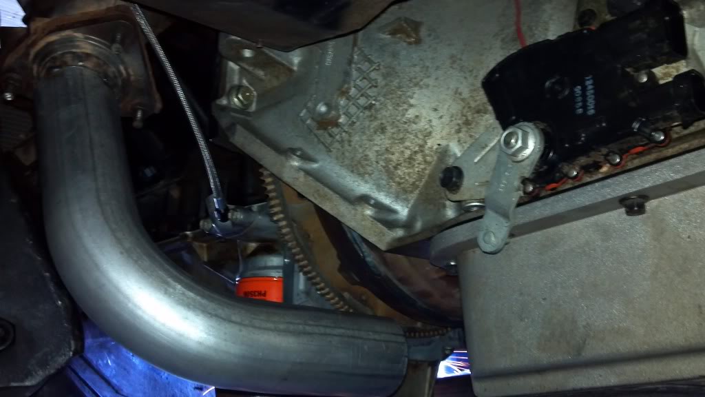

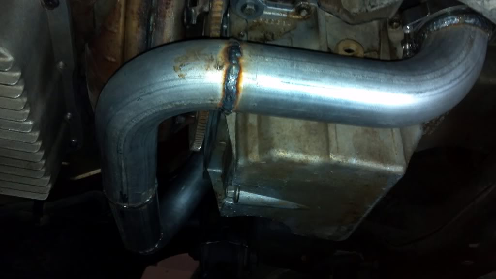

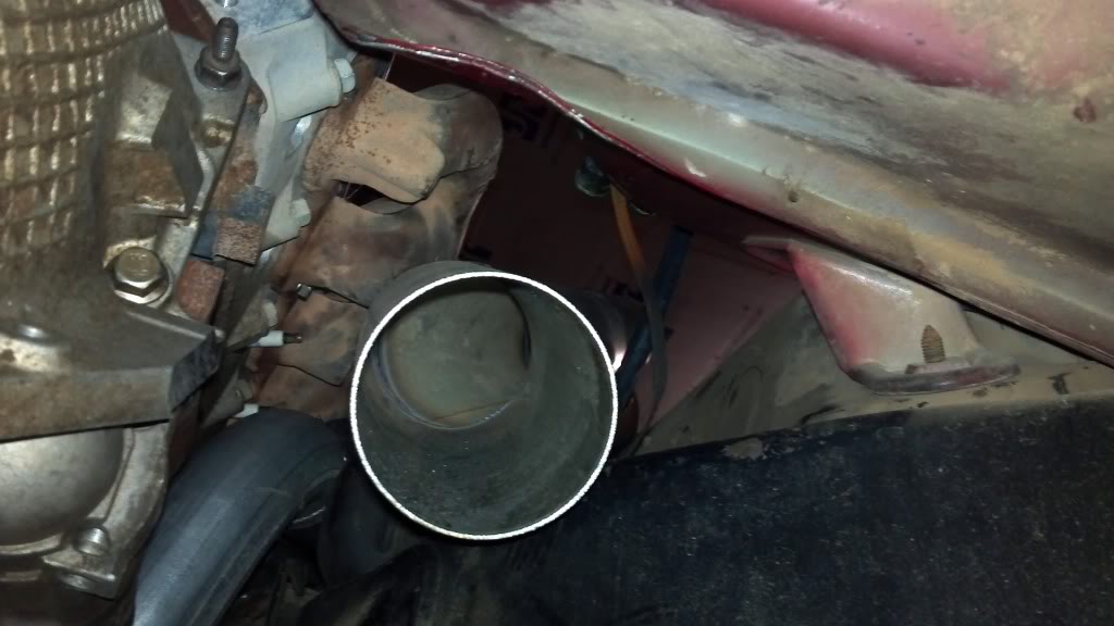

Updates!!
These are uncleaned welds, I still have alot of work to do!!
Crossover:

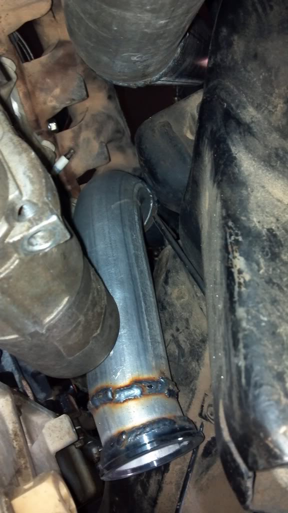

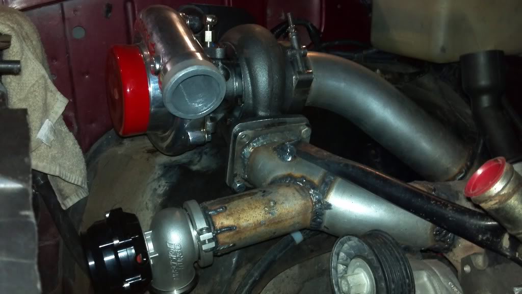

Down Pipe, LOTS of clearance, plenty for a 4"!!:
And the rest: And yes I'll be running a down pipe for my wategate too.
