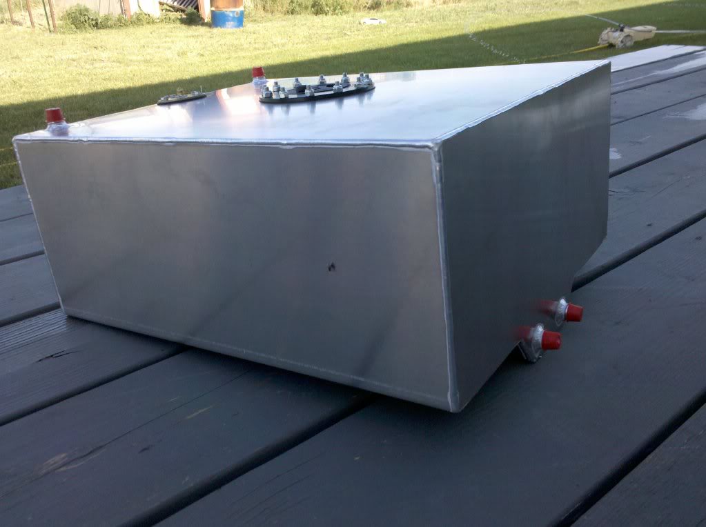

-Bed mounted fuel cell with in-line Bosch 044 pump and 95# injectors

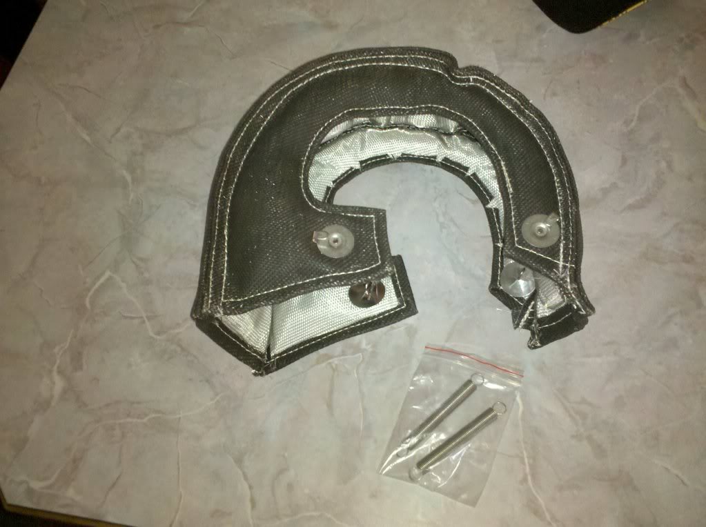

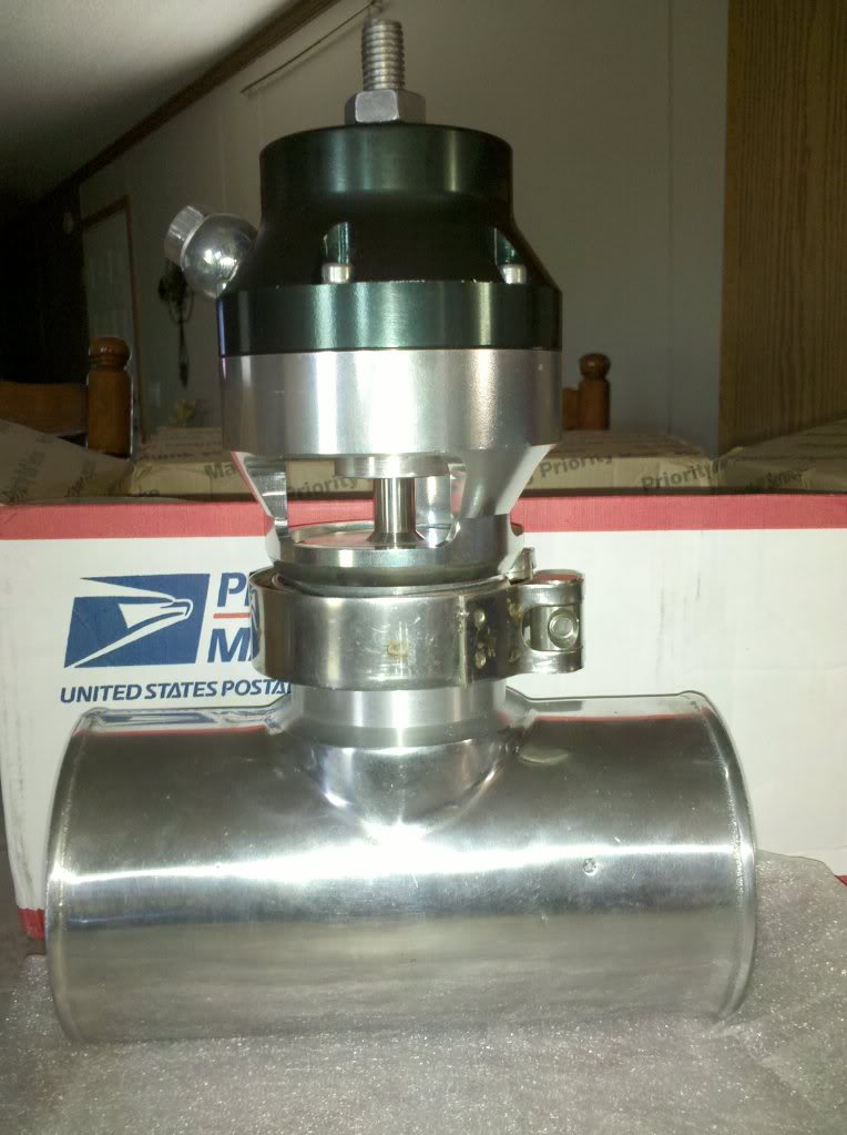

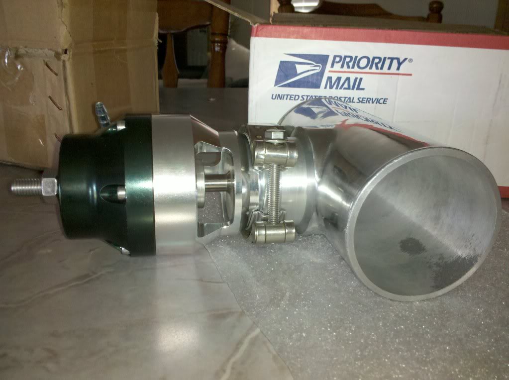

I also got me "eBay" BOV in the mail yesterday, I'm actually impressed for $75, although I did order a black one and this one is really dark green:

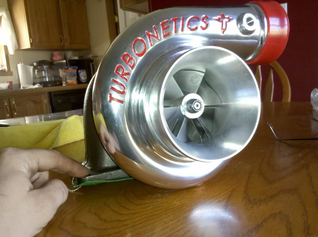

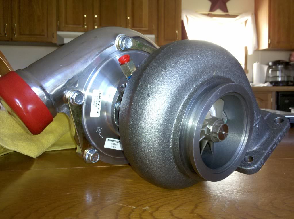

Turbo has been ordered!!
Its a Turbonetics Hurricane Vanessa 7668 76mm .96 a/r
Details: Turbo, Hurricane 7668 Vanessa

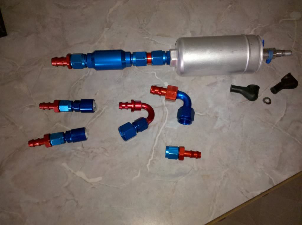

Moar parts!

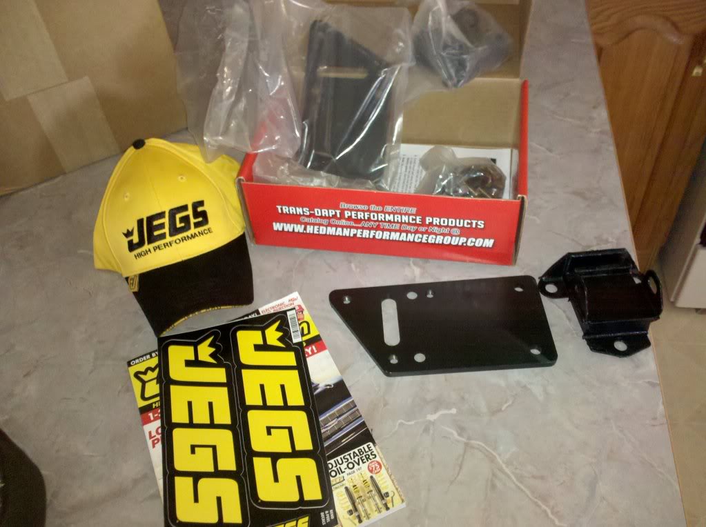

Trans-Dapt #4595

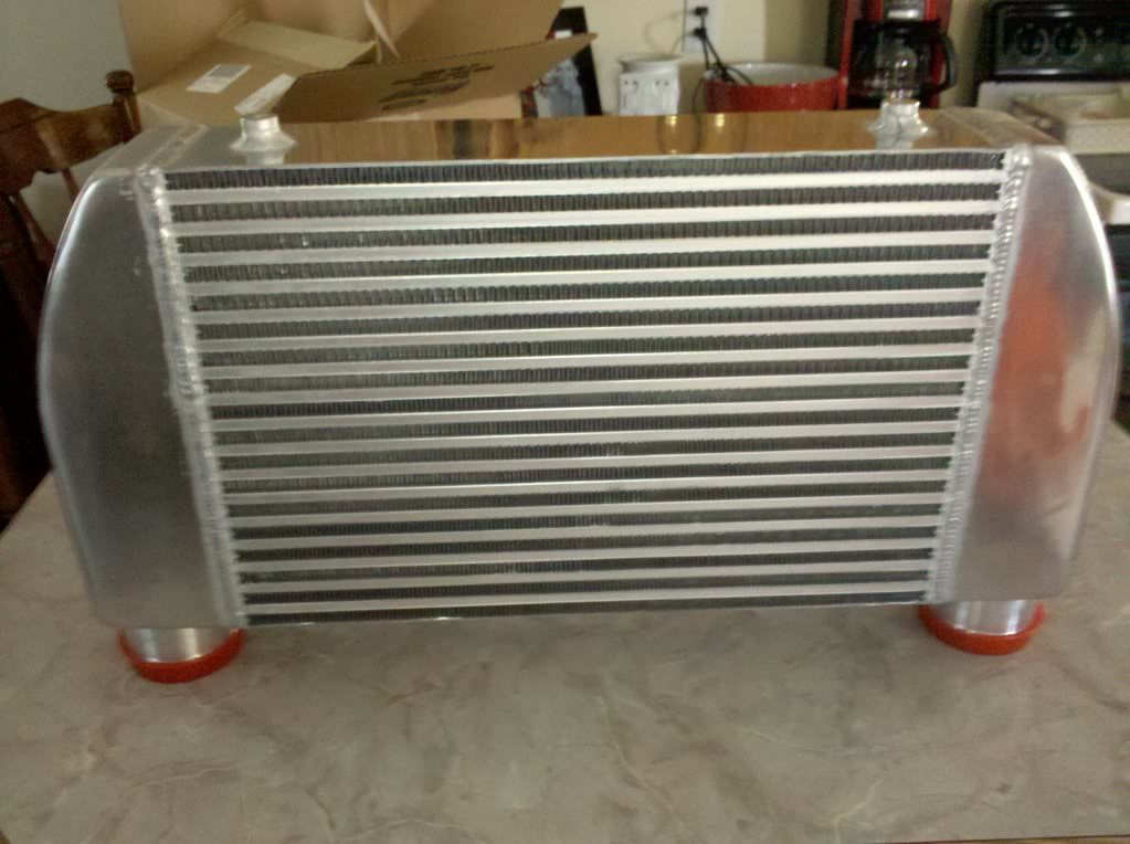

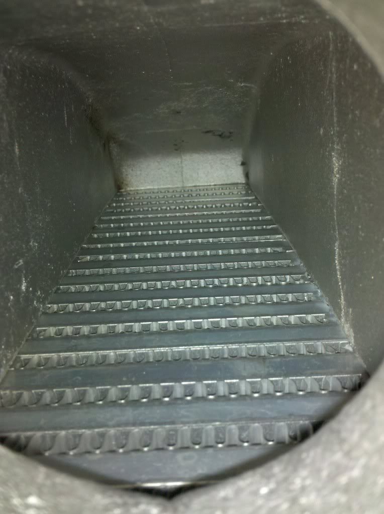

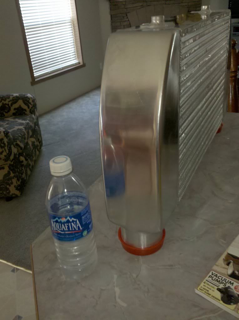

CX racing intercooler part # IC0008:
Core Size: 18"X12"X4"
Overall Size: 25"x16"x4"
3" Inlet & Outlet on the Side
4" Core

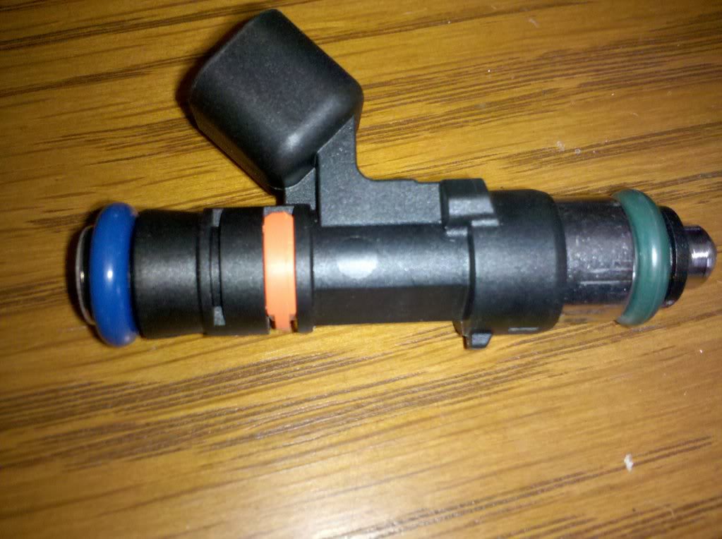

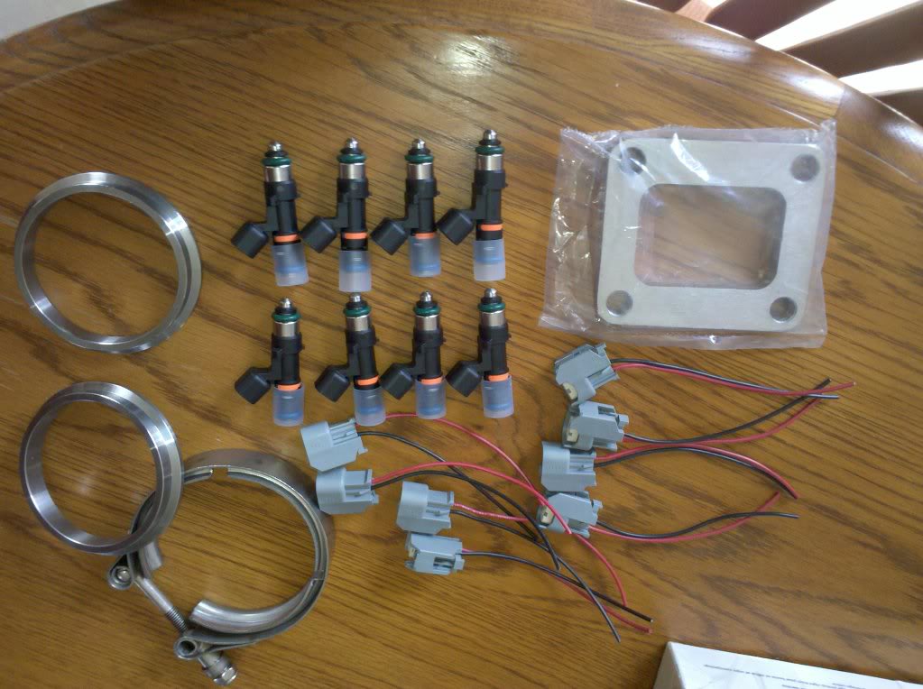

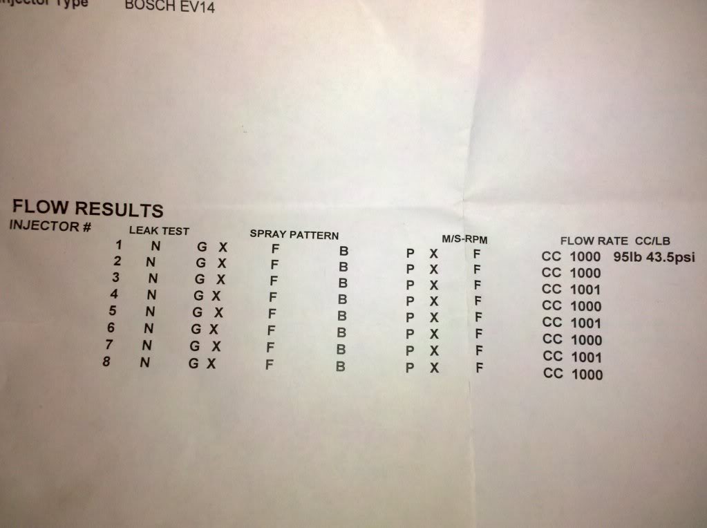

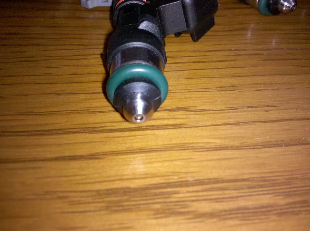

FIC 1000cc injectors, they flow 95lb @ 3 bar (43.5psi), 108lb @ 4 bar (58psi)... I just told him I wanted 80# injectors and he told me to reach my goal of 700rwhp on E85 I would need at least 95lb injectors so he sent me these LOL:
High Performance New Fuel Injectors - New Bosch - FIC FLOW MAX BOSCH , LS3, LS7, LS8, LS9 95LB FUEL INJECTOR - Fuel Injector Connection

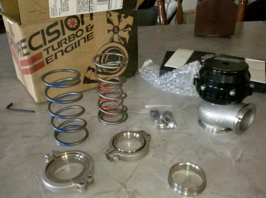

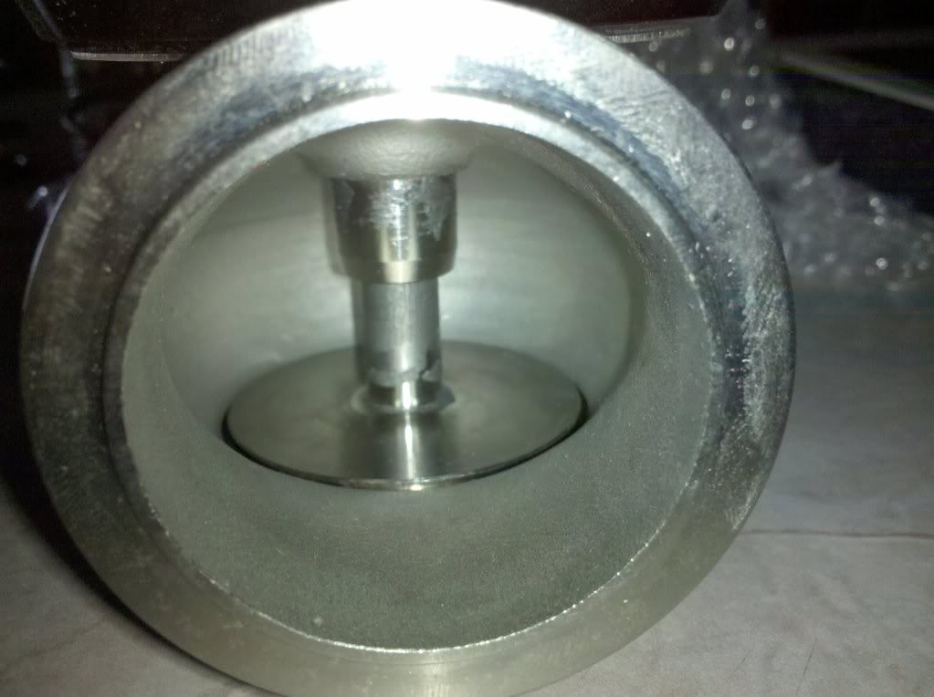

Precision wastgate, looks like really good quality!

Old Jun 13, 2012 | 08:29 PM
1989k1500's Avatar
iTrader: (23)
Joined: May 2006
Posts: 1,858
From: Ravenna, MI
Looking good.
What cell is that?
