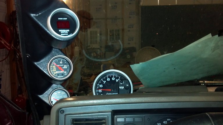

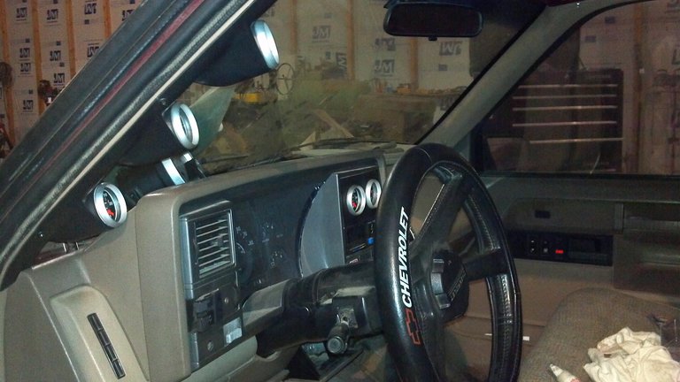

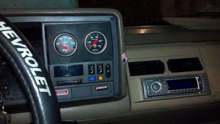

Guages installed!

So thats where I'm gonna be mounting my gauges !!! Looks good are you using the factory gauge cluster for any of the gauges?
Just the speedo and the fuel guage.

I actually gutted out the factory stereo and used the body of a CB radio for the face
