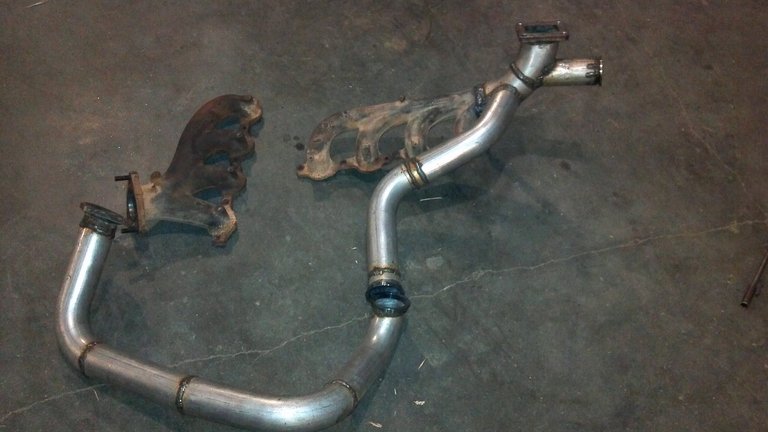

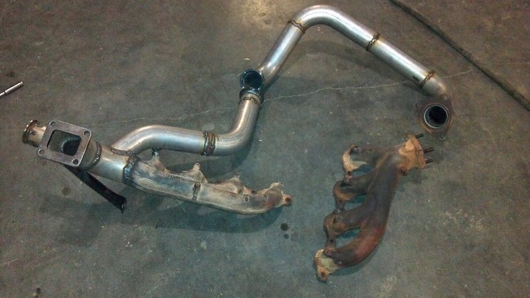

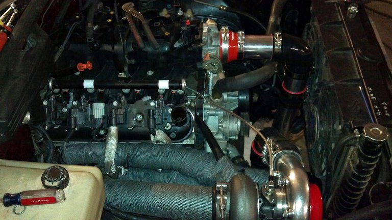

Here are the hot pipes all laid out

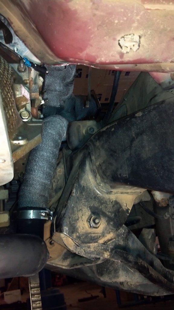

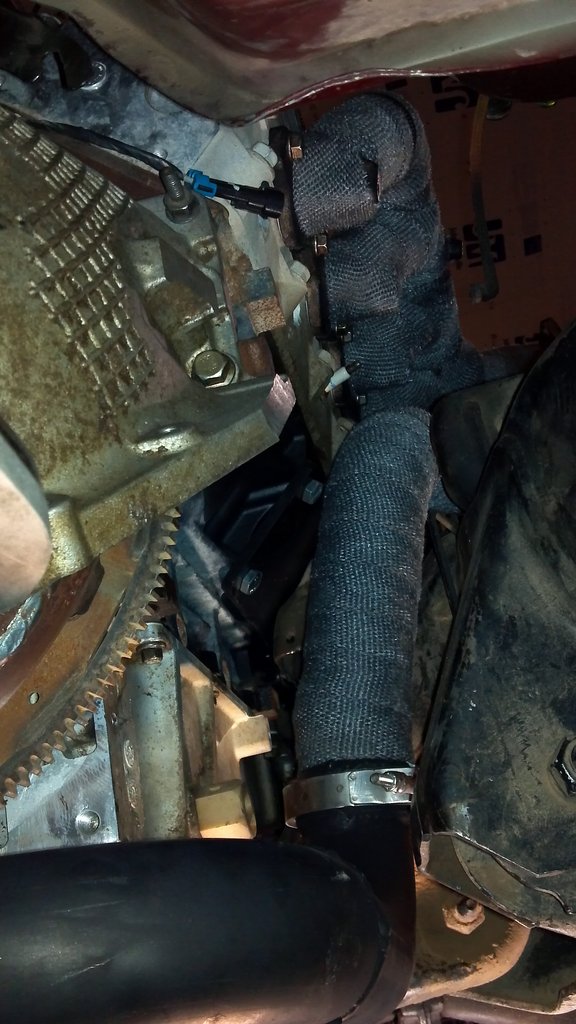

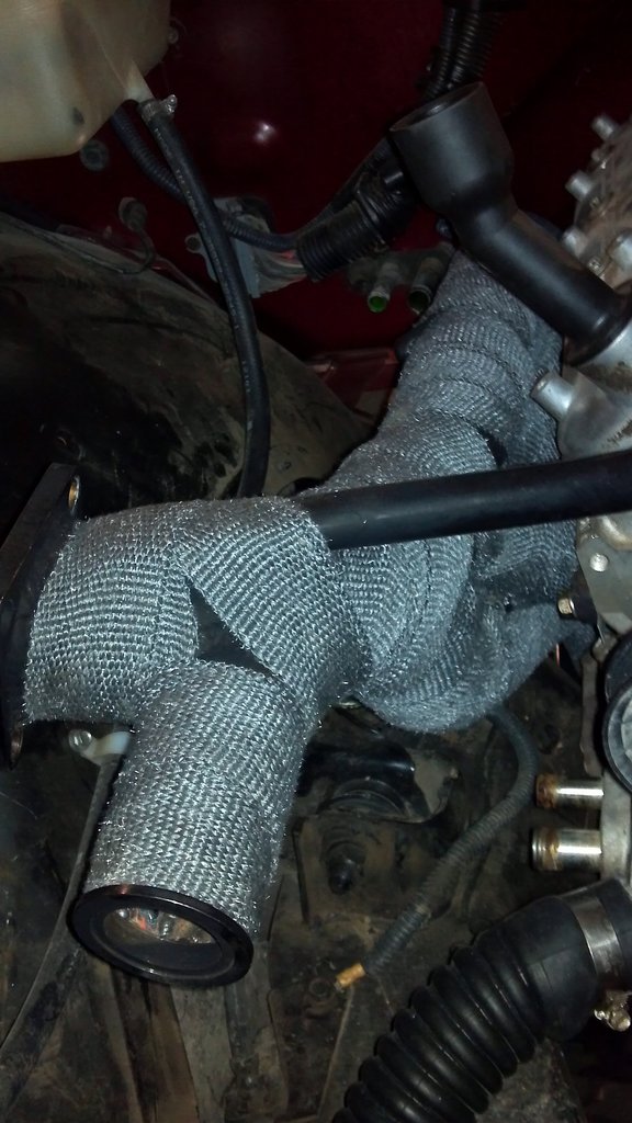

More progress!!

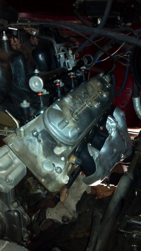

Old Aug 25, 2012 | 12:16 AM
  #65
LS1FREEK's Avatar
13 Second Truck Club
Joined: Feb 2008
Posts: 1,333
Likes: 8
From: Sublette, KS

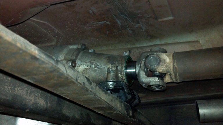

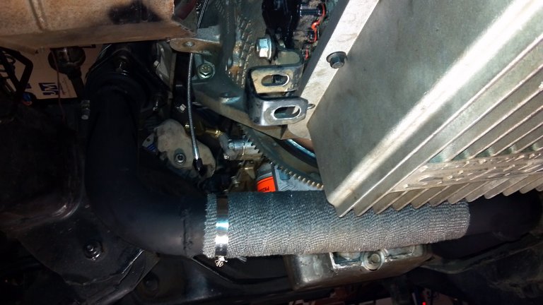

Stock driveshaft with 80e and 1" back TransDapt plates
Stock shift linkage needs to be shortened about 1"-1.5" and it should work fine

And this is how far I am as of now

I has some questions.
Any pics on the intercooler mounting and pipe setup? Also for the tranny crossmember is that a custom made one? Ive seen other people just move the stock crossmember back and re-drill new holes which I was planning on doing.
Old Aug 27, 2012 | 12:47 PM
  #70
LS1FREEK's Avatar
Joined: Feb 2008
Posts: 1,333
Likes: 8
From: Sublette, KS
I'll try to get some pics made tonight for the cold side, but the crossmember is stock, just moved back and new holes drilled in the frame.
