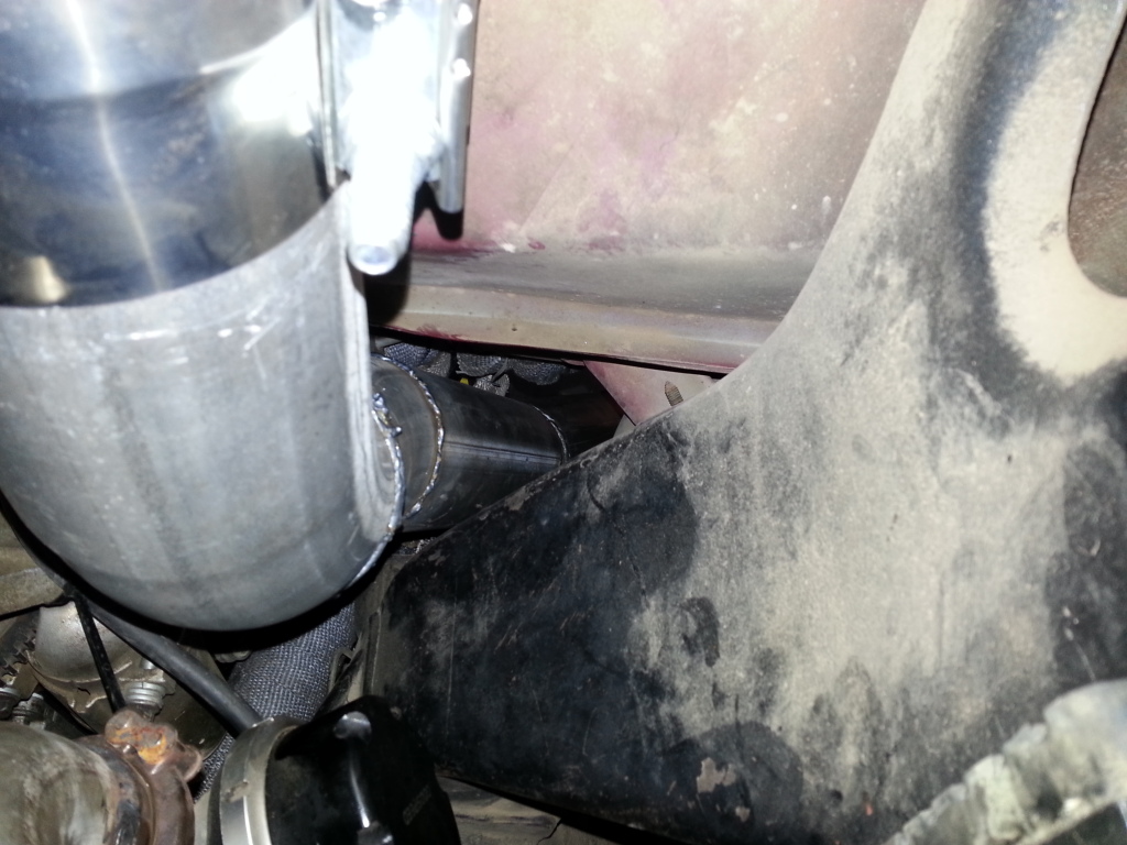

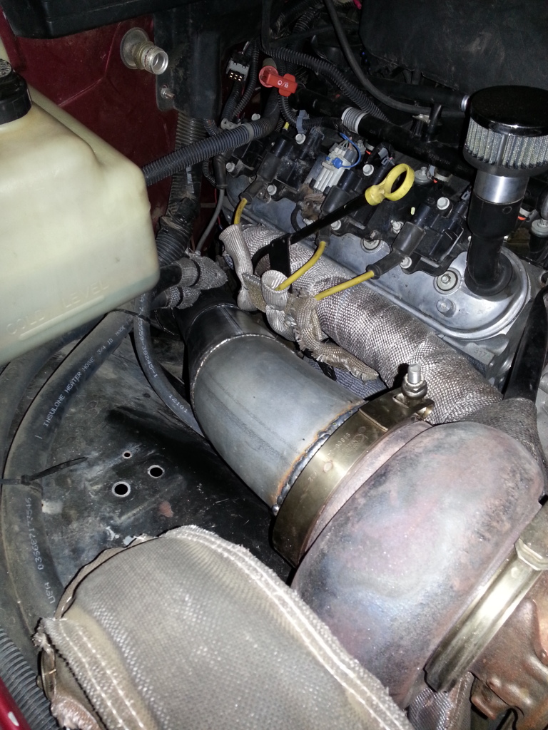

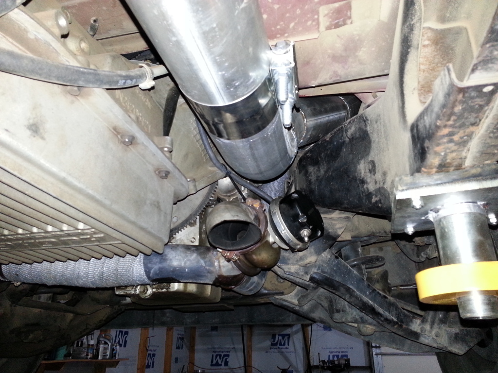

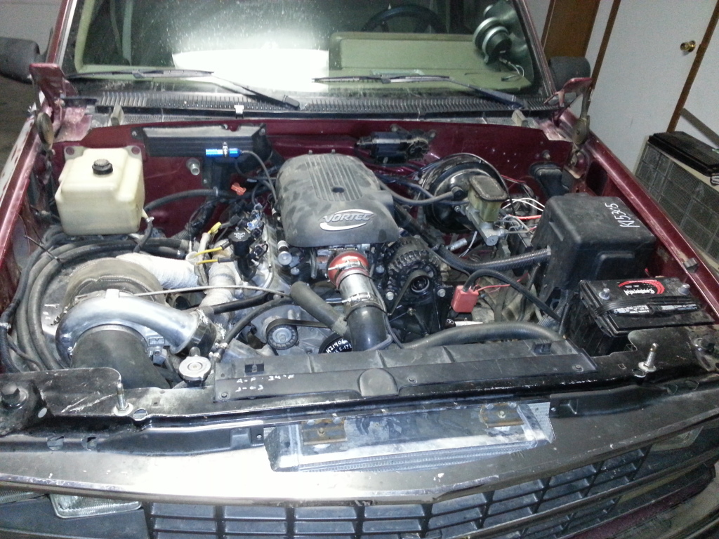

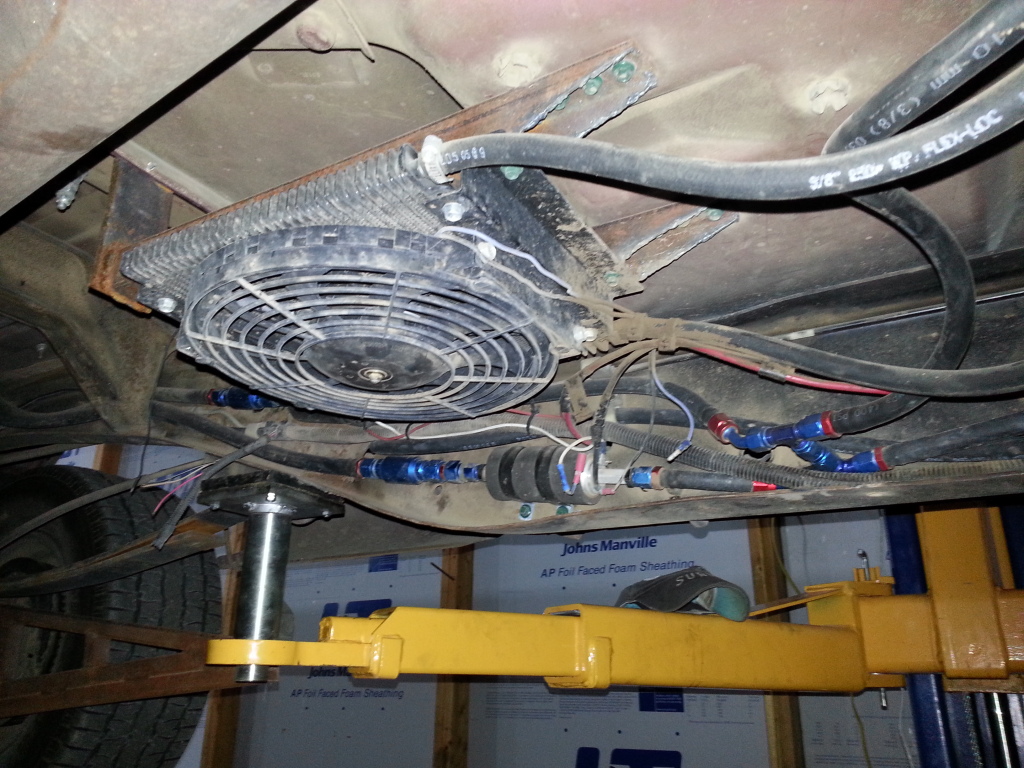

Never did post a picture of the finished build with the GT45 turbo.
