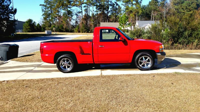

Got the rearends swapped today to include the Caltracs and my driveshaft from the wrecked truck. I still need to pull the motor/trans out of the wrecked chasis and switch them over.
