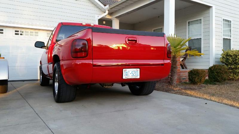

I originally didnt know what was going to happen with the old truck, i found the 07 and thought it was very clean, and wanted to mod it more. Reality was when i brought it home, it was too clean. I ended buying the red truck back for 400 dollars, the engine,trans, interior, bed, rearend, etc was still good to go, along with most of the turbo kit. I picked up that gmc for 4k, and decided to just make a weekend fun truck out of it. Now I had 2 single cab trucks, and neither would be good for family time, pulling my trailer, or driving every day. I needed a crew cab again, so I started looking. I am die hard GM, but I couldnt find what I wanted for what I was willing to spend with new 14+ GM trucks. I looked and looked, but most wouldnt budge on price for me. My wife has a 02 trd Sequoia, in 200,000 miles, its had oil changes and timing belts, and thats it. I decided to go look at a tundra, and really the older ones were damn ugly. I like the body changes they made, and interior changes. The ride is much better, and the powertrain has proven itself well since 07. This was my first brand new vechicle, and I got for 33k. fully loaded 15 crew max, xp edition, came with 20's, bfgs, spray in bedliner, bed rail system, tinted windows, camera, etc. for the money it just had more than the GM. The 5.7 is pretty strong, especially with the 4.30 gears that come standard, and im averaging 19 mpg, not the best, but im fine with that for such a big truck. I will give it shot and see how it holds up. It will get a 3" leveling kit and stay stock, enough grunt for family chores, and have the gmc for fun.
