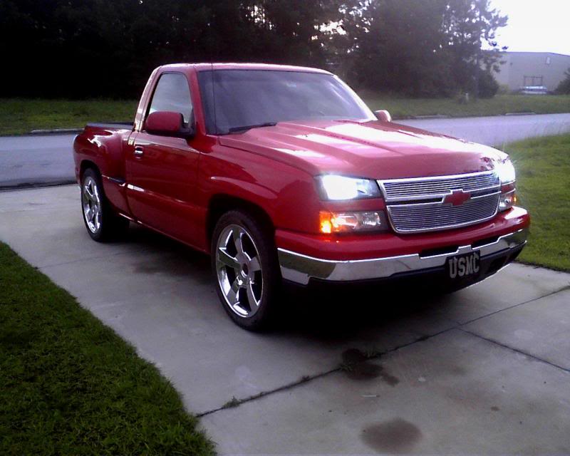

This was the truck how I bought it 6 months ago. Paid 8600 cash for it. 03 4.8 with 85,000 miles. no mods except SSS 20's
And here it is today with Efans, and SSS 22s
