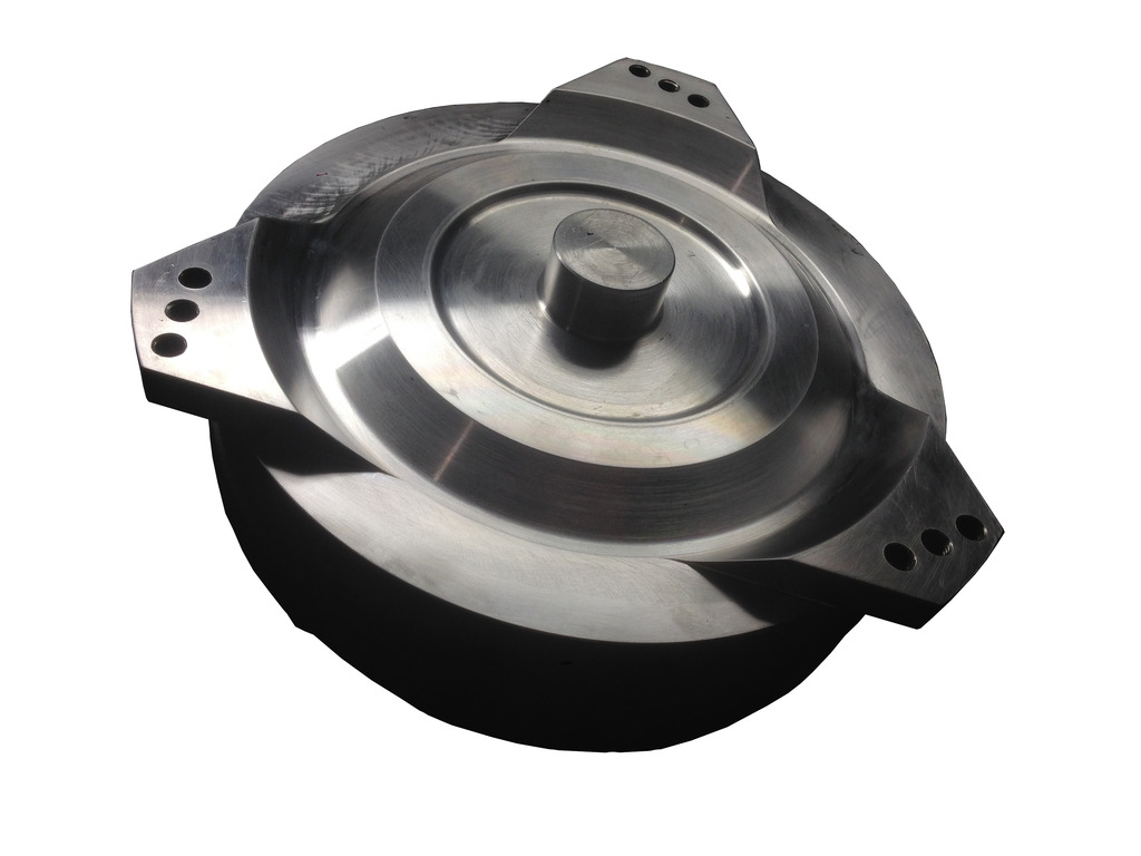

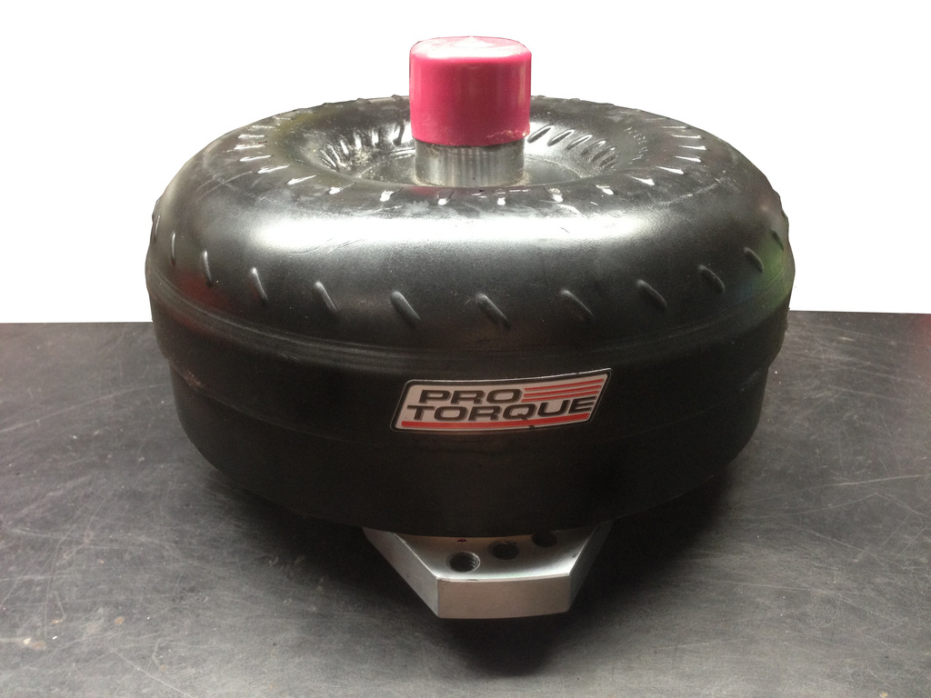

Well after waiting since December finally got my converter in. This one is a multi disk 3500 stall for my 6l80 which is getting built but going to place an order for a Revolution converter for a 4l80 now as well as a built 4l80 to have as stand by. Will see how far I can push the 6spd before it finally goes. Now to be honest I would have just went everything 4l80 to start with but at the time I ordered this converter I wanted to see about the 6spd so just going to have it built and see how well it goes for now.
