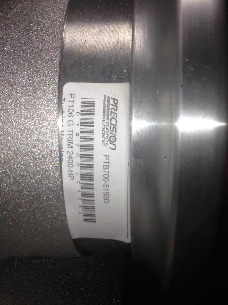

PT106 G Trim with 1.0 A/R exhaust side.

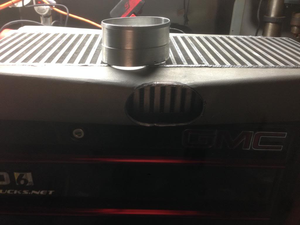

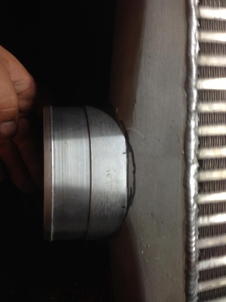

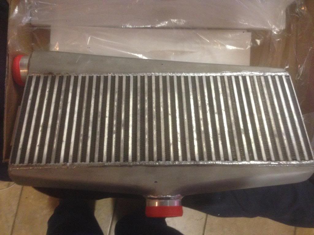

Treadstone Intercooler
It is rated to 1300 but think it might be small. It came with 3 inch inlet/outlets so cut them off and fitted some 4 inch nipples.

Ill posts more pics of the intercooler welded up and mounted once i get it back from a buddy who is welding it up for me.

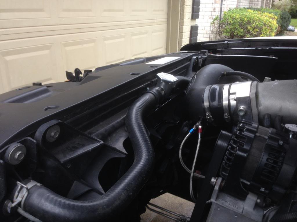

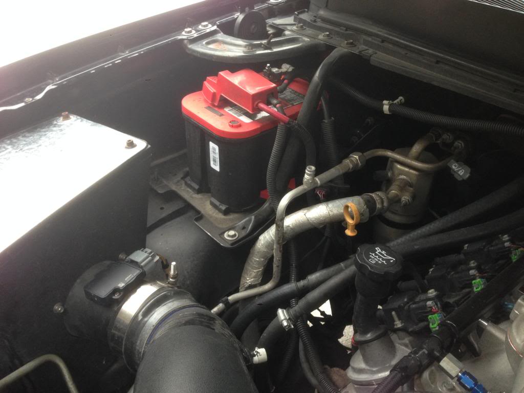

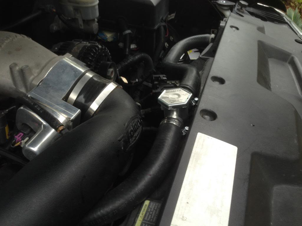

To make room for the turbo I deleted the coolant tank and went the old school way and plumbed in a radiator cap on the top hose and will be installing the overflow can Thursday when it comes in. More pics... Excuse the dirty engine bay everything is gonna get cleaned up and either powder coated black or painted black. Also gonna try out those heat shrink Hose Candy clamps to clean everything up, they look neat and are supposed to work good.

Part I used to do this... Ordered from Jegs and got a Moroso cap
