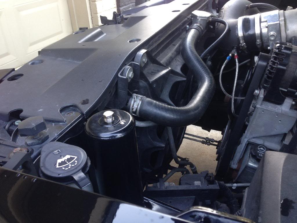

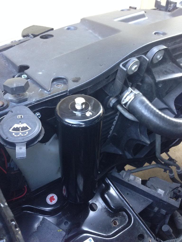

Old Mar 20, 2014 | 06:59 PM
  #163
Three6GMC's Avatar
Joined: Mar 2010
Posts: 2,165
Likes: 27
From: Corpus Christi
Got my Jegs coolant overflow tank in today and mounted it up. Pretty easy and straight forward. Not gonna be its final location but for now it works and is out of the way. It doesn't leak or overflow or anything if your wondering why its wet underneath it I just washed my truck when I took the pics.

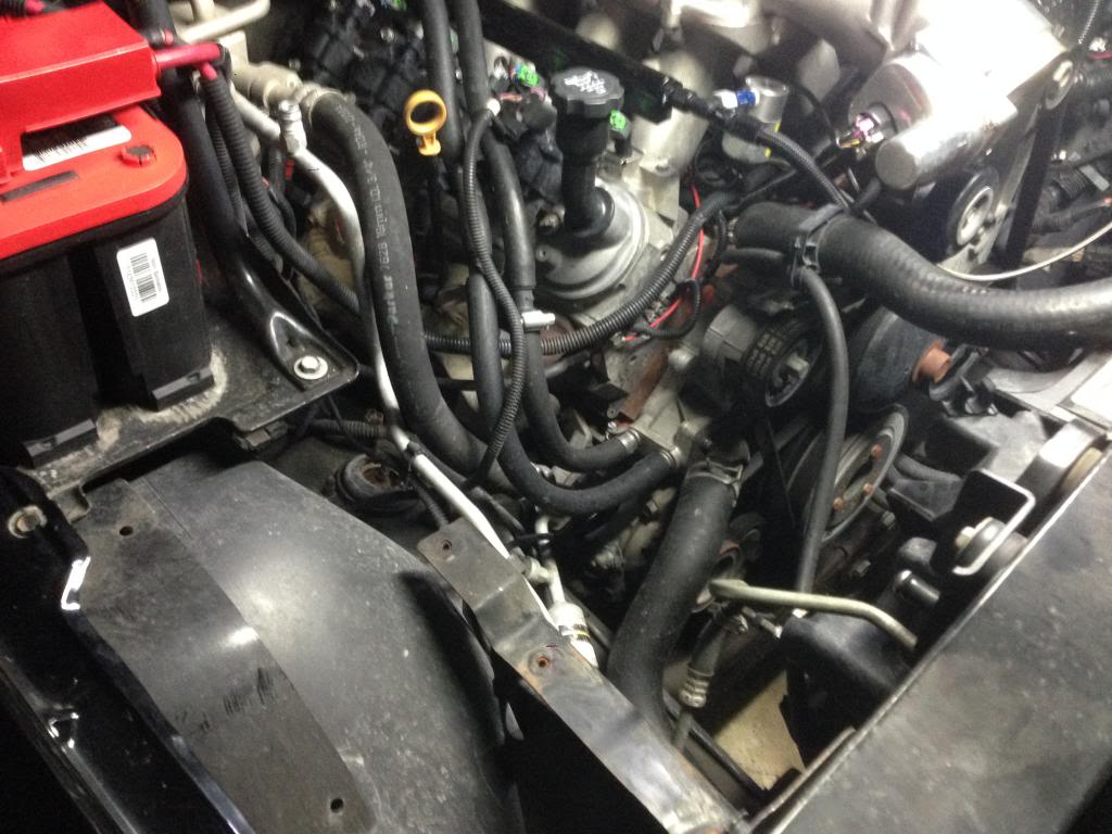

Old Apr 11, 2014 | 06:06 PM
  #164
Three6GMC's Avatar
Joined: Mar 2010
Posts: 2,165
Likes: 27
Well got my PW66 wastegate and feed/return lines in today. Going to start on the hot side this weekend! I really wanted Kyle to do the hot side but to get it to fit where I want it to and not really for sure if a log will work I'm gonna build the hot side with a few buddies of mine who are welder/fabricators. Will see how it turns out lol
