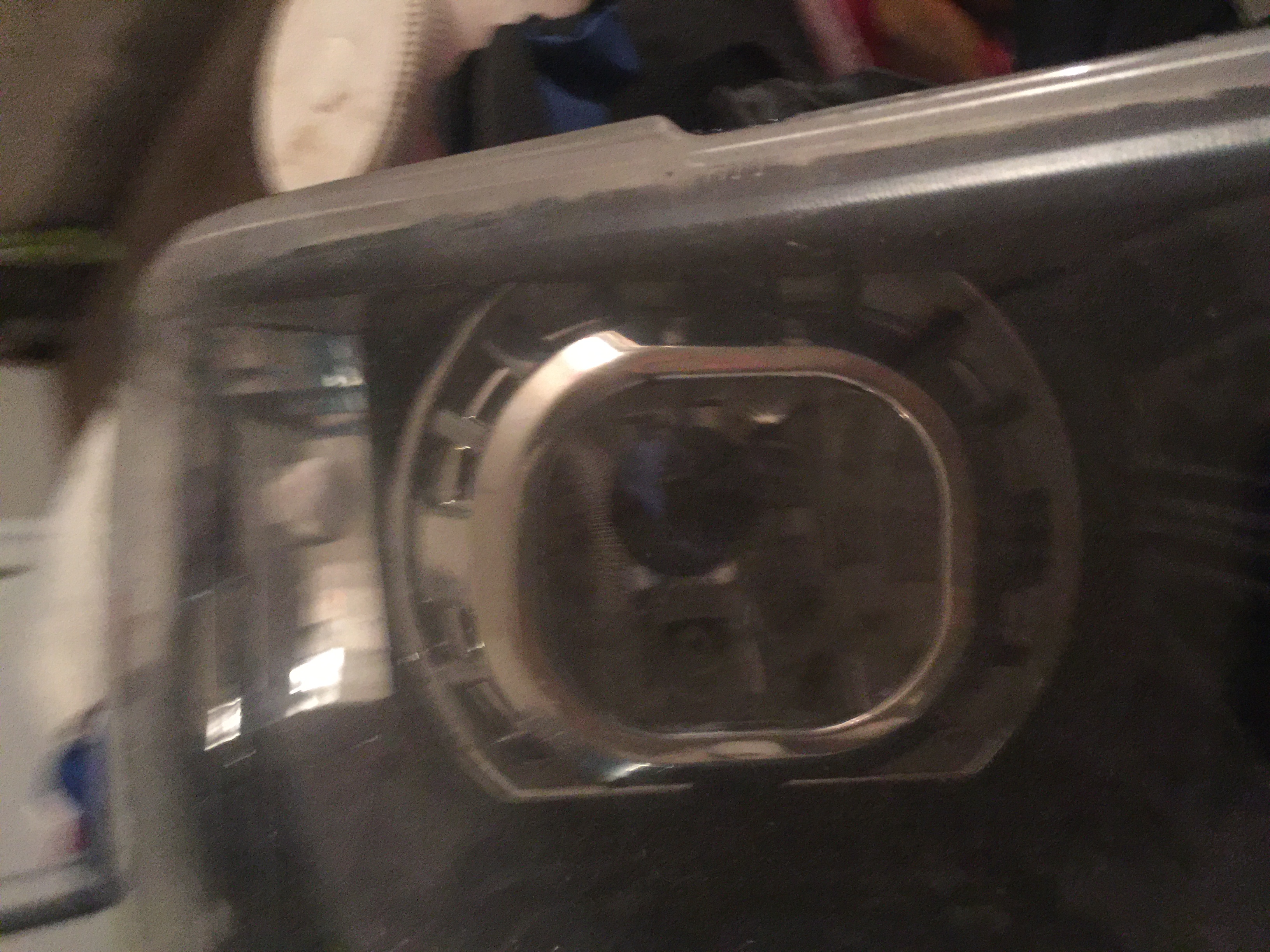

I got some pics for some reason it only uploads one pic . But it measures 3.871 from the front of the projector shroud to the back which is about the same from back threads to the clip positions. But we'll see when I cut the whole bigger

No I don't have very much space behind headlight assembly I have Made it that far but I can safely say with a little more trimming on shroud that the projector will sit with the lens being about a 1-1/4 away from the lens the only thing is like I said I cut the hole in the lens really big and now I need a big washer to support the nut behind it I am also not sure if it will function the same...here's the hold before and I made it significantly bigger
You cut a hole in the lens? Why in the lens?
I thought the only cutting necessary was in the bowl/reflector?

I'm sorry no not the lens stupid me must of got excited I meant the bowl lol be I didn't want to cut the bowl out of the reflector housing. If I had have to do all that I'm going to put highs and lows. But when I do my driver side light I'll post pics of everything. Is there anything you want pics of?
