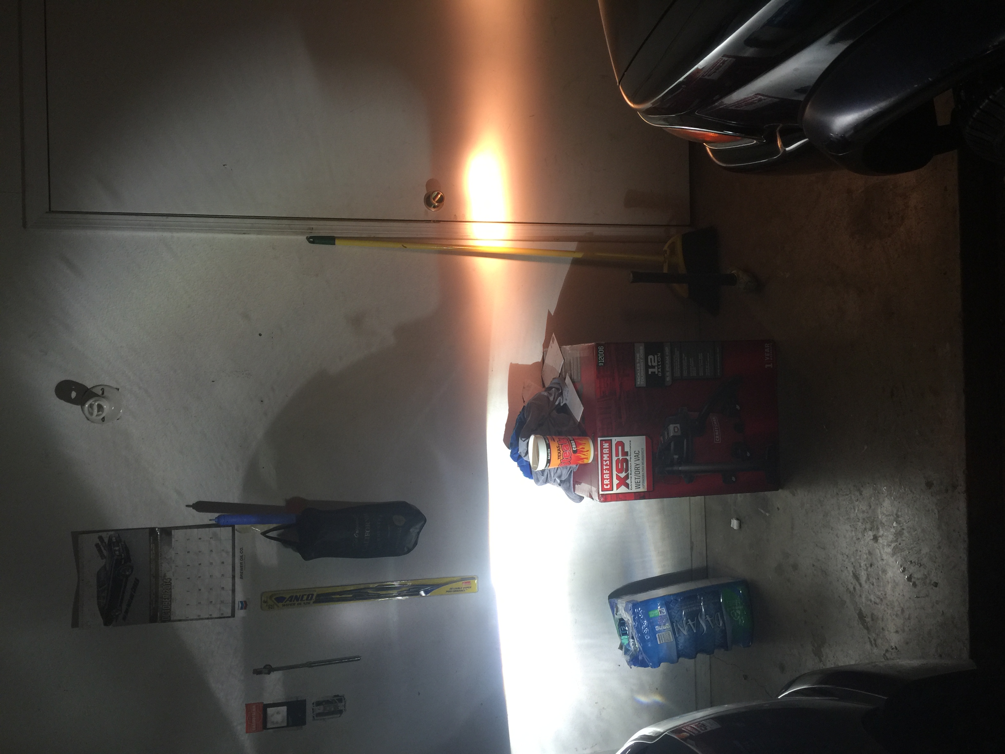

I figured it out to use the threads on the projector. I cut a hole 51 mm center on where the lows where sitting and I put a 1-1/2 washer on the back but I had to cut a 1/8" off with a plasma cutter but it fits perfectly and the projector sits an 1-1/2 at least away from the lens all I need to do is adjust the shroud. I'll have a whole write with pics for the other side just the weather is still bad. But the projector centers and you can adjust the bowl if it is a little off. Here some pics

The projector is square. And I made a mistake but not a big one yet I put the washer like I said but the projector was still lose so I had to put the rubber behind it which brought it up about an inch closer to the lens but i think I'm still good anymore cutting and I'll have to cut the frame that holds the radiator up for the d2s fitting. But it looks really great as long as the 51mm is centered on where the bulb sit it fits perfectly and the lights are already lined up also you can adjust the bowls with the factory setting once installed up or down of course. I hope I can finish tomorrow with a lot of pics looking for a good camera to do a good write up and put it all in one thread or at least here.

Yeah I'll being using jb weld around the back of the washer to seal it better I think I can still place the rubber over the top and I am probably going to his use silicone to seal it back up. The camera I have is all big and fancy and I don't want to mess it up but I might as well get some kind of good pics
