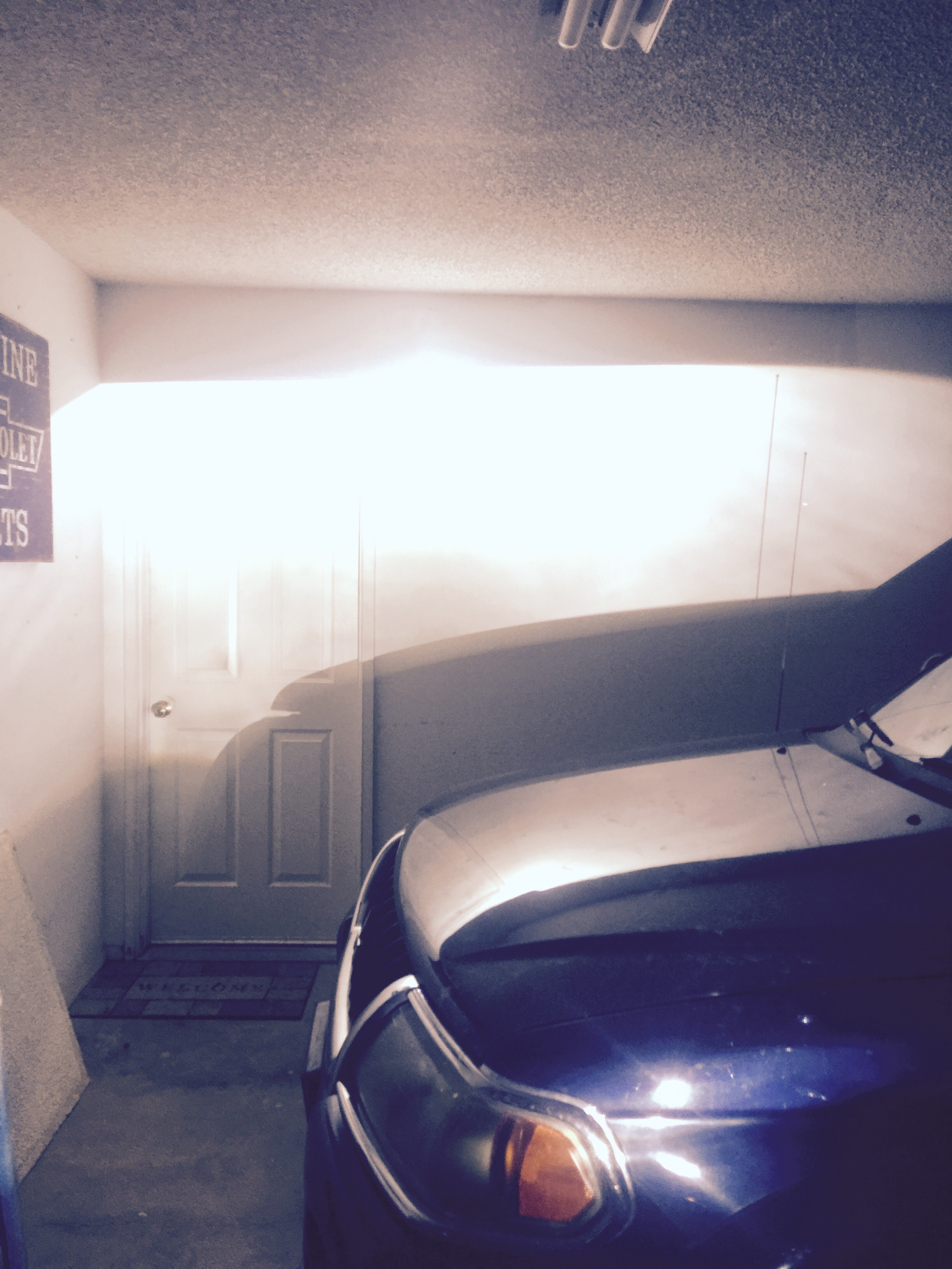

I'm hoping to go cut them in about 20 minutes and I have all four projectors in give them a email they'll give you a 50$ discount code.... But besides that here's some pics of light and the projector itself just light output I guess I'll figure how to add more in a second
