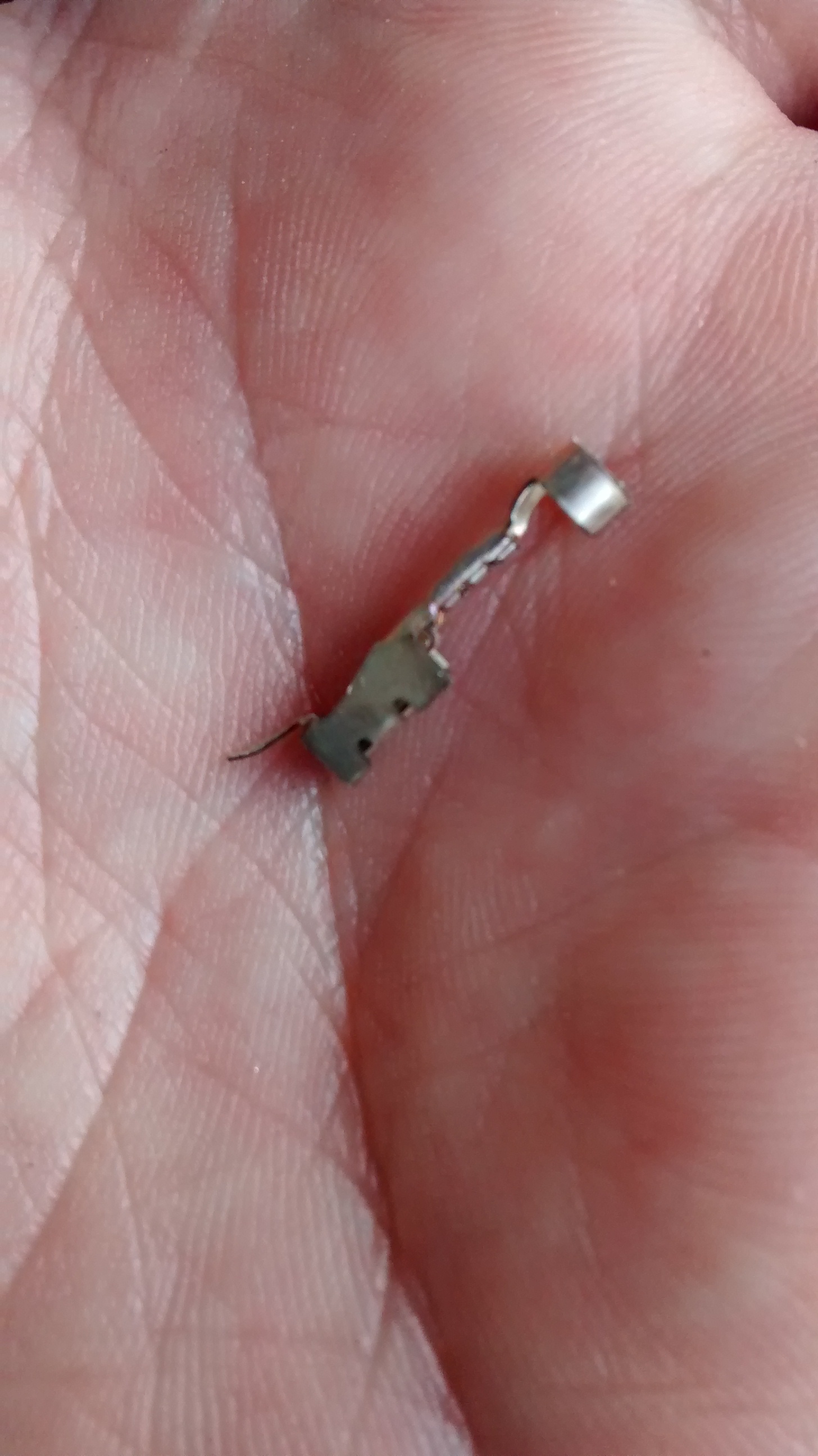

I found the problem... now I need to find one of these pins and fix it.
Attached Thumbnails No start after engine/transmission swap...-img_20160920_131517871.jpg   No start after engine/transmission swap...-img_20160920_132643426.jpg

I patched it together and got it fixed. It starts, runs a few seconds, shuts off. Then I get a flashing security light. I believe now it is a VATS issue and needs to be reset. I will go through the process tomorrow and hope that this is the end of all the BS.

So I go over there today to do the VATs relearn... turn the key, no security light. F it, I start it - fires right up and settled in on a decent idle. I am not going to complain. Once running, had a massive transmission fluid leak. My fault, forgot to tighten a fitting on the line. Quick fix, not a major issue.
