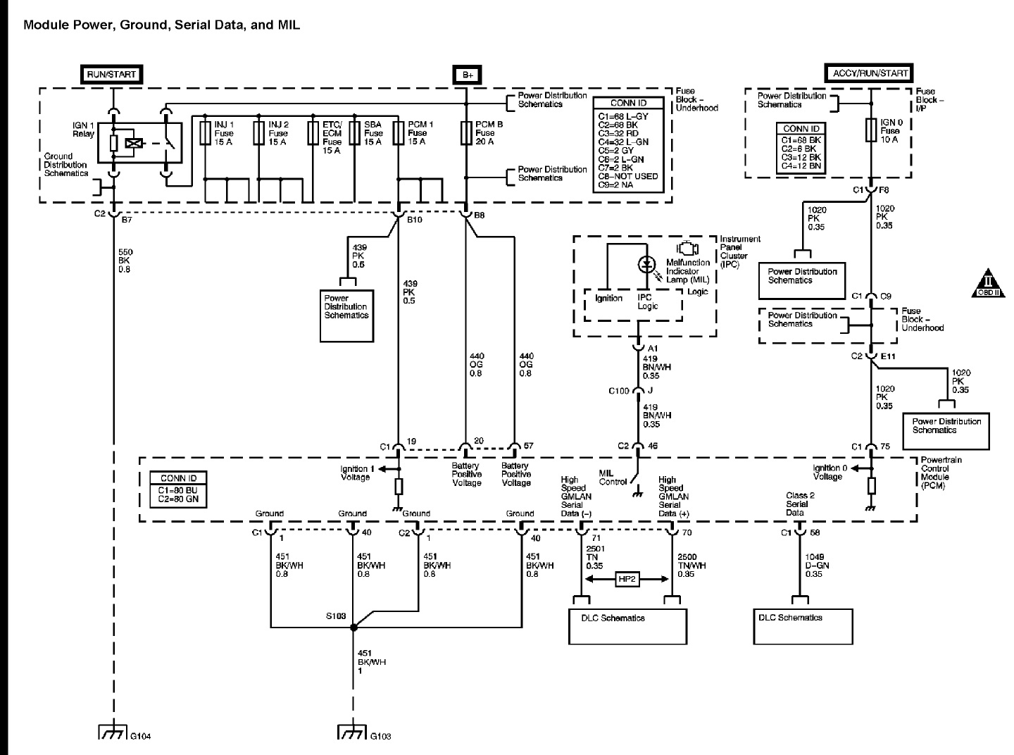

Also, the OBD2 port is getting power, but it will not connect to HPTuners.
