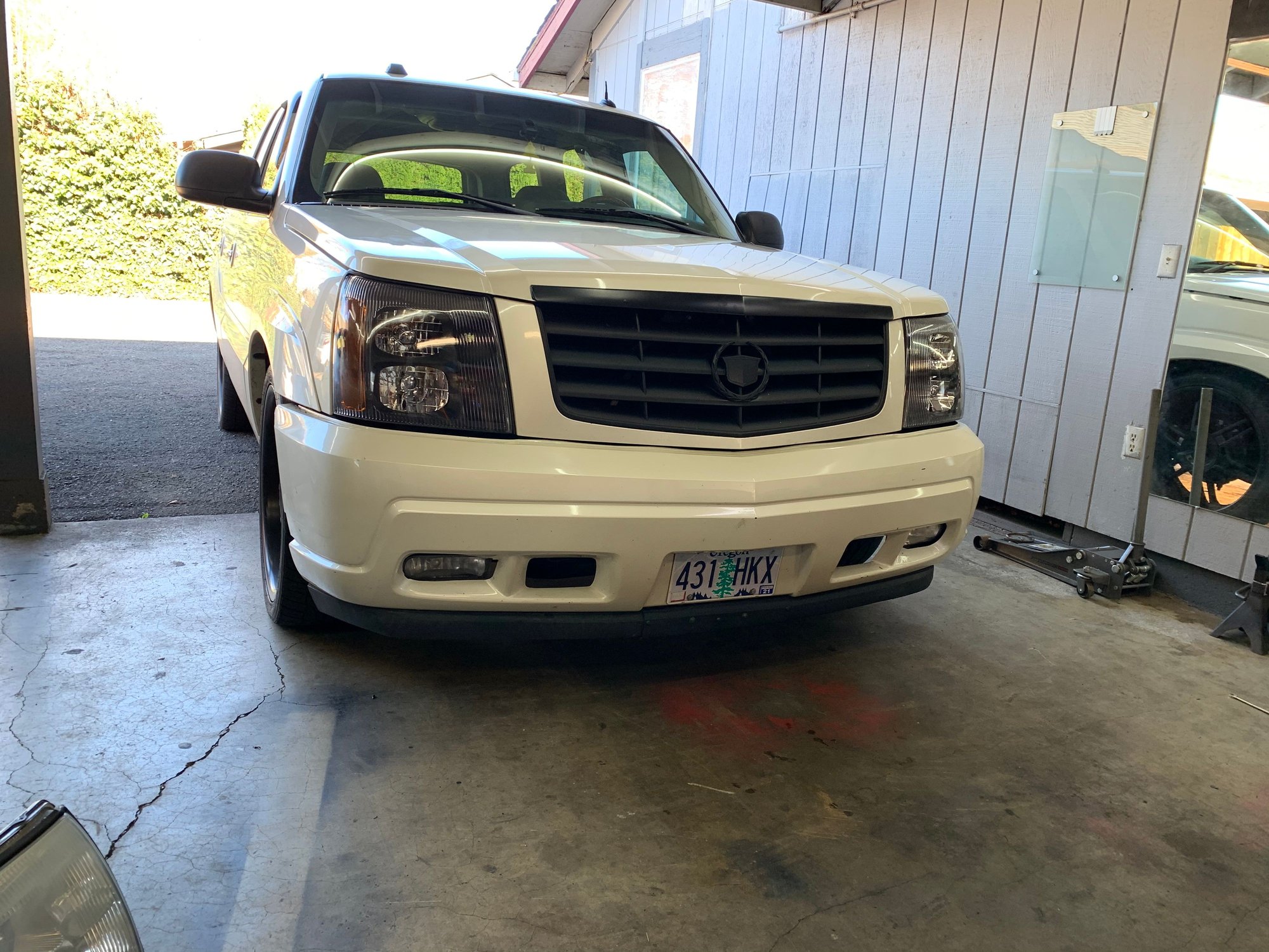

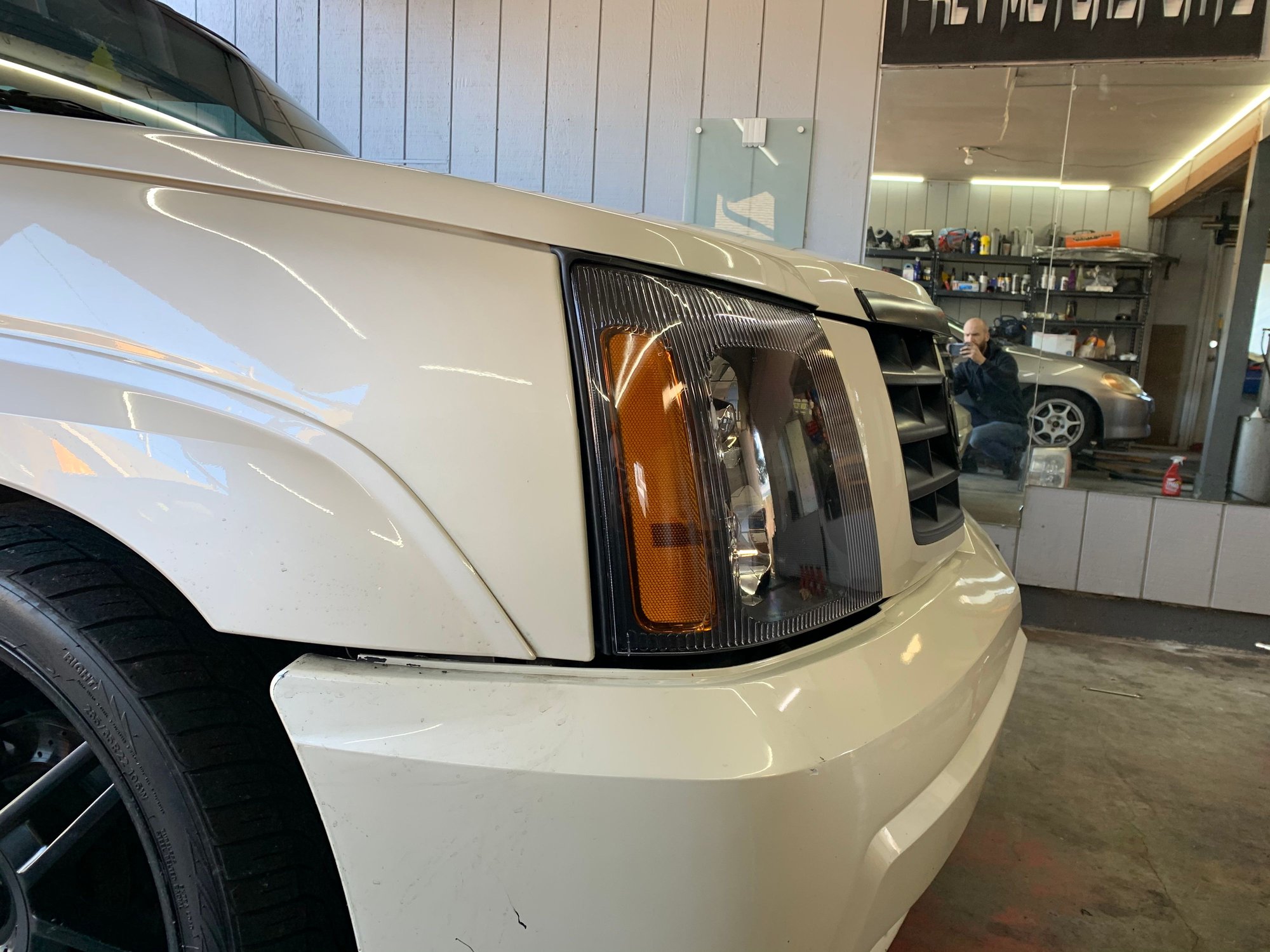

Got my new black housing headlights today and swapped them on. Overall they look allot better but being non oem there was a few fitment issues as expected. They wanted to sit further out from the fenders then I wanted but overall I’m happy with them for the $190 bucks they cost. Took about 10 minutes to get each to sit how I wanted so not a huge deal. Took much longer to snake the stiff hid ballast wire out of the Old headlights and into the new ones. Stock headlights are for sale if anyone needs them. They are hazed but no broken tabs or cracks in them.

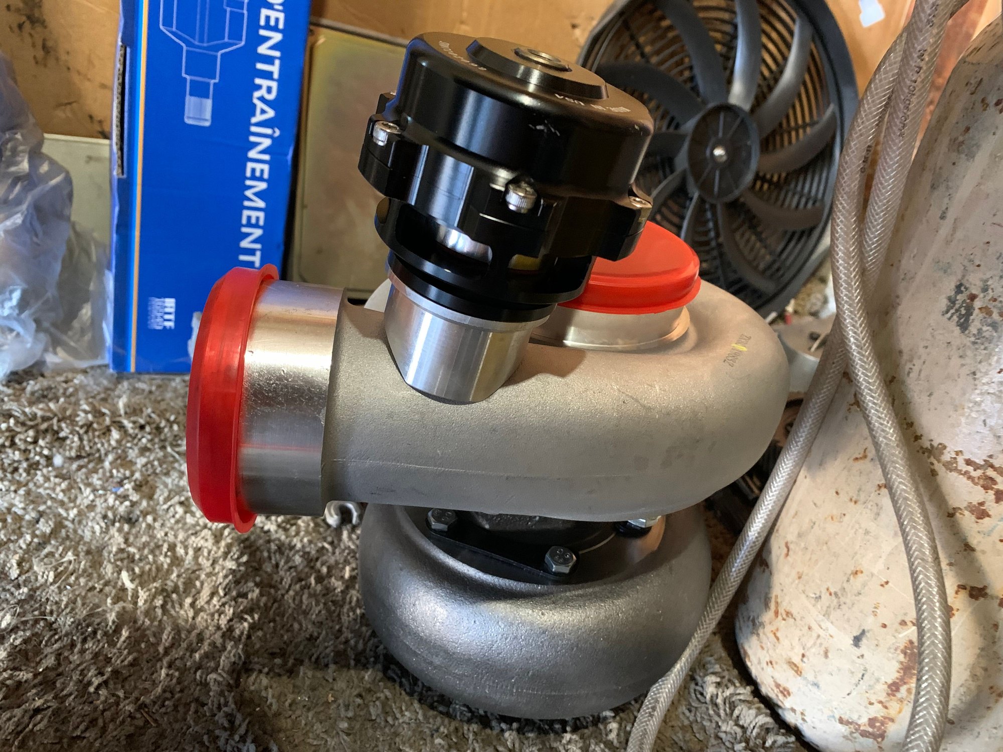

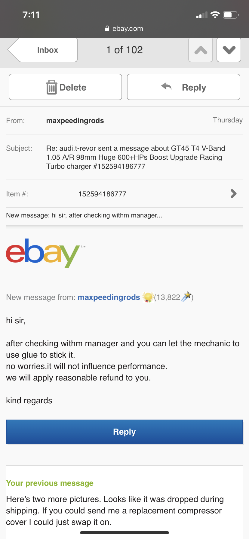

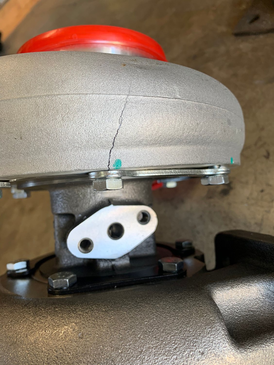

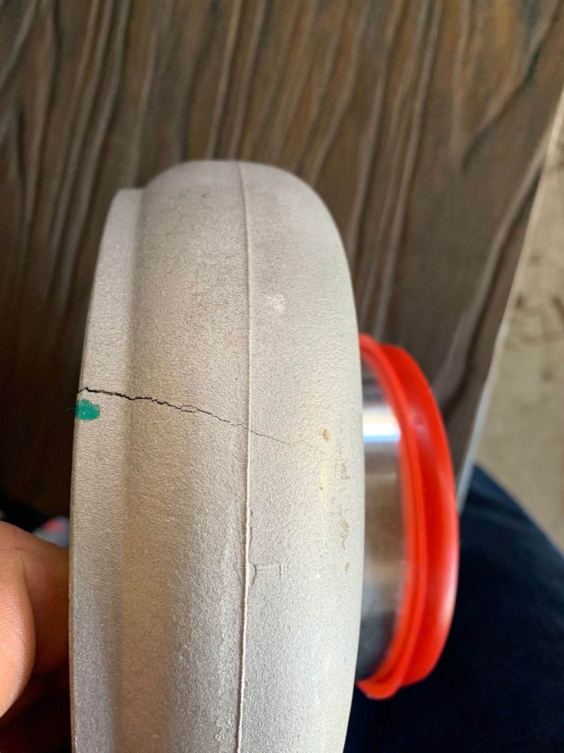

Started fitting up the blow off valve to the turbo today, it seems like a funny spot to put it but the closer to the turbo the better it will work, stock srt4 turbos come this way and those cars blow off in reverse backing out of a parking spot lol. Upon further inspection of my turbo I notice the compressor cover had a crack in it, looks like fedex was playing basketball with the box so I sent the seller an email and got this response 😂😂 lol. I was dying when I read it, not a huge deal my buddy who has a tig will just weld it up.

They don't understand what your saying, They will just give you a full refund to make you happy.
I have gotten a few things like that lately.

Just glue it tho. Make sure the mechanic does it. Managers orders 😂

Got some elmers glue for the turbo should work good since manager said so. Actually dropped it off with my buddy tony to weld the bov flange onto it and weld the housing. Also swapped on my belltech sway bars yesterday. They definitely tightened the truck up allot. Got rid of all the side to side rocking from hitting a bump on one side and it corners allot more flat now. Planning on taking a little trip to the coast next week so I’ll get to test it on the curvy roads out that way. Also I went out to a new junkyard in Sherwood Oregon looking for a 4l80e, they had an older one in a 3500 Chevy van but I’m gonna wait for a 00+ one for my truck to avoid any complications. They sell Tranny’s for $220 with a 13 month warranty for any transmission so that’s a pretty sweet deal. I was able to get a flex plate off a 4.8 van there that had a 4l80 on it at on it at one point.
