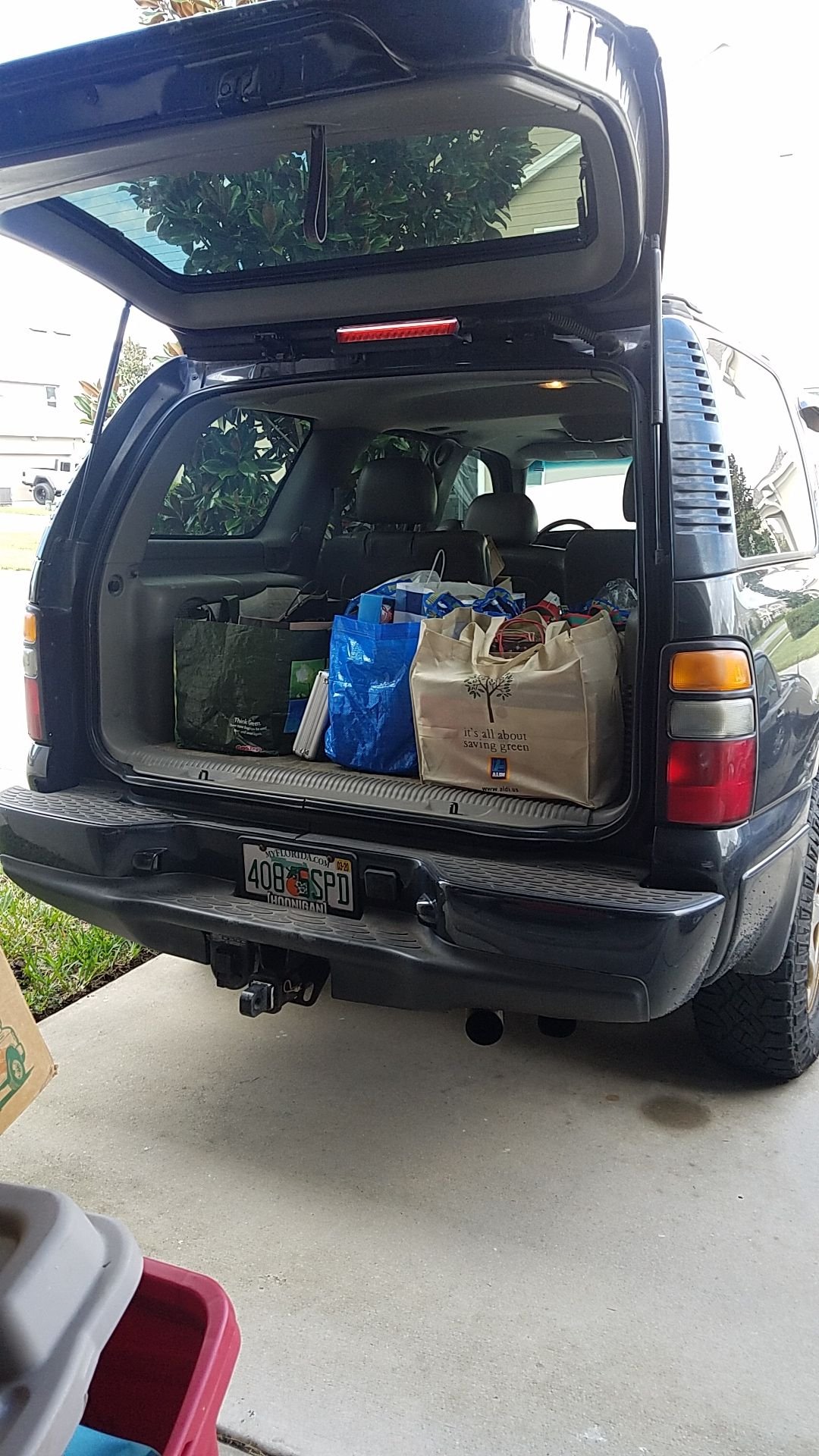

The tranny ordeal is basically the thing holding me back from wanting to build this truck more. Its crazy I’ve been looking for quite a few months now and almost never see any 4l80’s pop up, or I did see a blown up nv4500 local with no bell housing for $600. I think my plans have changed a little with this truck since my little S10 is meeting my fun truck need. I’m gonna plan on fixing a few small issues on the dadillac. I have almost all the turbo parts ready for this truck but I’m gonna try to sell them. If anything it will get a mild cam and some long tubes/ ory
One issue I’ve had with this truck for the last few months is a parasitic power draw, it was pretty easy to diagnose I just used a volt/ohm meter and measured for amperage acrossed the fuses. The pid/dic fuse under the hood has a 1.1 amp draw on it and from what I’ve read that’s usually something in the cluster. I have replaced a few of the stepper motors in it (fuel gauge, voltage) because they weren’t working properly. If anyone has any info or anything that could help me pinpoint how to repair the cluster to get it to quit drawing voltage that would be great. Or if its just something that needs swapped out with another cluster.
Also since this truck is just the family hauler, road trip vehicle I think it’s long over due but I’d like to figure out a way to add in Bluetooth capability to my head unit. I remember seeing a write up on a forum for how to add aux but I’ll have to look for it.
