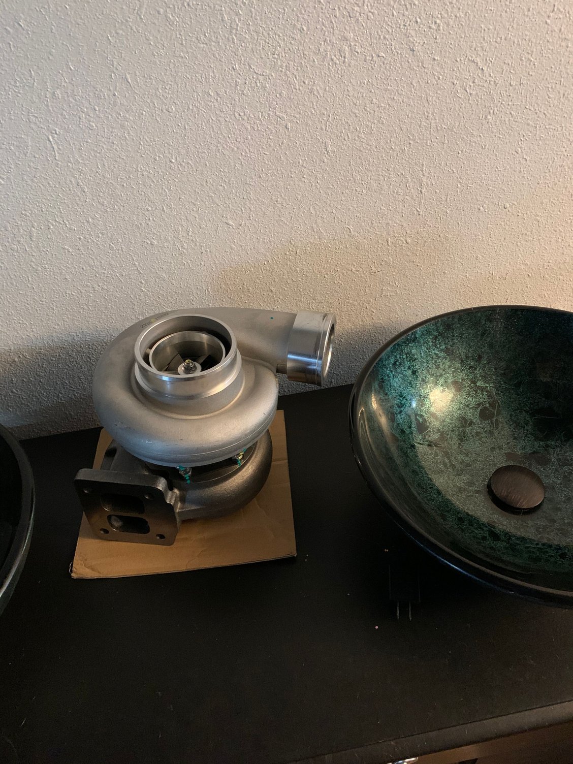

I think my game plan for now will be new valve springs and stem seals in the motor and hold off on a cam till I have a Tranny that will hold the power. It will keep my seemingly never ending parts list just a little bit shorter and I’ll be the one tuning it so only thing I’m wasting is my time. Also it’s always been fun for me to do things one at a time and tune each time to really see what gives you how much power from the setup. On the up side my Chinese noisey boi came in today. Shaft play feels very minimal like it should for a journal bearing turbo. Damn thing is pretty heavy compared to the smaller turbos I work on most of the time but it should be worth it. Scaled it at 33.8lbs, inlet is just a hair over 4”, hot side charge pipe outlet is 3.5” and exhaust inner diameter is 3.25”, weird that they didn’t send a v band flange or clamp but I’ll order one up for it. Happy to see the exhaust isn’t like 4 or 5” because I don’t think I have room for a massive down pipe and really wanted to keep it simple and go 3” exhaust all the way back utilizing the stock exhaust tip.

3" will struggle, but will support 700hp. When I turbo my Tahoe she is getting a 4" DP because I want to get the exhaust out ASAP to prevent heat problems whilst towing. what are the specs on your turbo? Is the divided housing going to cause you issue on the single outlet manifold?

I’m not looking for crazy power out of the truck really. If I wanted to build a fast truck it would probably be a regular cab Colorado with a turbo 6.0 in it. As for the divided housing I don’t think it will be an issue. I will probably pull the hot side off and knife edge the divider to reduce turbulence. As for the specs here’s the link.
https://www.ebay.com/itm/GT45-T4-V-B...id=15021691930
i used the same turbo on a customers fc rx7 that was ls1 swapped and he said it worked out well. He later put a lq4 in it and said it was even better.
