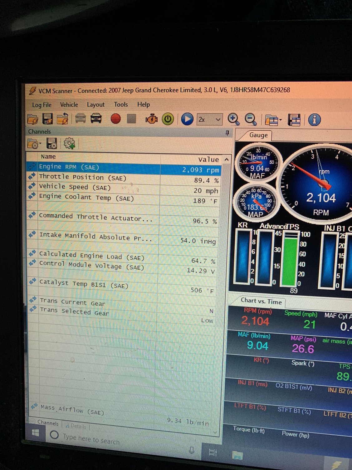

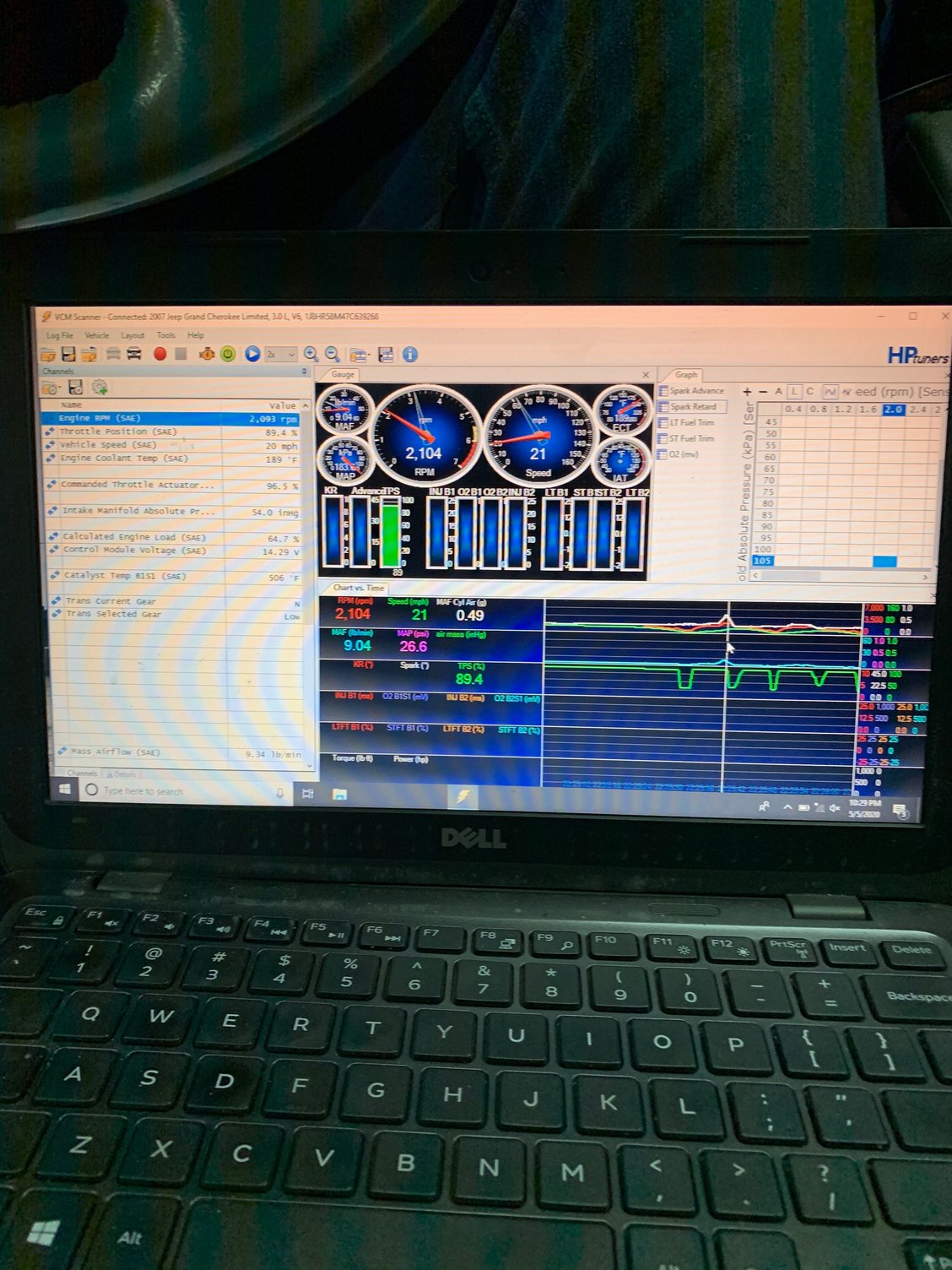

So changed the oil today then took the Jeep for a two hour drive to pick up some other Jeep wheels. Noticed the gas mileage dropped after the oil change and read that that’s fairly typical with diesels for the first couple thousand miles. Got some 18” jk wheels with 255/70/18’s on them (32’s) should look super nice on this thing once the lift is on and it’s sitting right. Also cleaned the air filter and got about a half pound of dirt out of it. Immediately noticed a huge improvement in power and fuel economy from that. Side note, vcm scanner works on it. Peak boost I saw was 32.4 minus the 14.5 atmospheric pressure it sees with the engine off that’s 17.9lbs. I wanna say these are supposed to run 20lbs stock but I gotta look into it some more.
