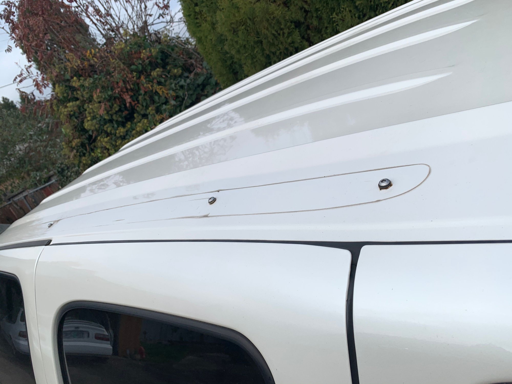

still gotta clean up the paint on the roof but here’s what’s left after the rack is off. Little bit ugly but you don’t really notice it unless your looking for it

Did you just put the OEM roof rack bolts back in the holes? I think it looks fine to anybody but a giraffe.

They are just rounded allen head m6x1.0 bolts. The stock ones were a bit longer and not a full thread on them so I ran to ace hardware and picked these up put some rvt black on the threads just Incase and threaded them in. No leaks yet. And yeah man the transmission thing has been kind of a pain in the *** to be honest. I’m gonna run up to the Sherwood pick and pull this week and look to see if I can find any 4l80e trans there or maybe a 5 speed but that’s doubtful. I will probably end up turboing the motor before doing a Tranny swap and if it holds together awesome, if not I’ll have a backup plan by then.

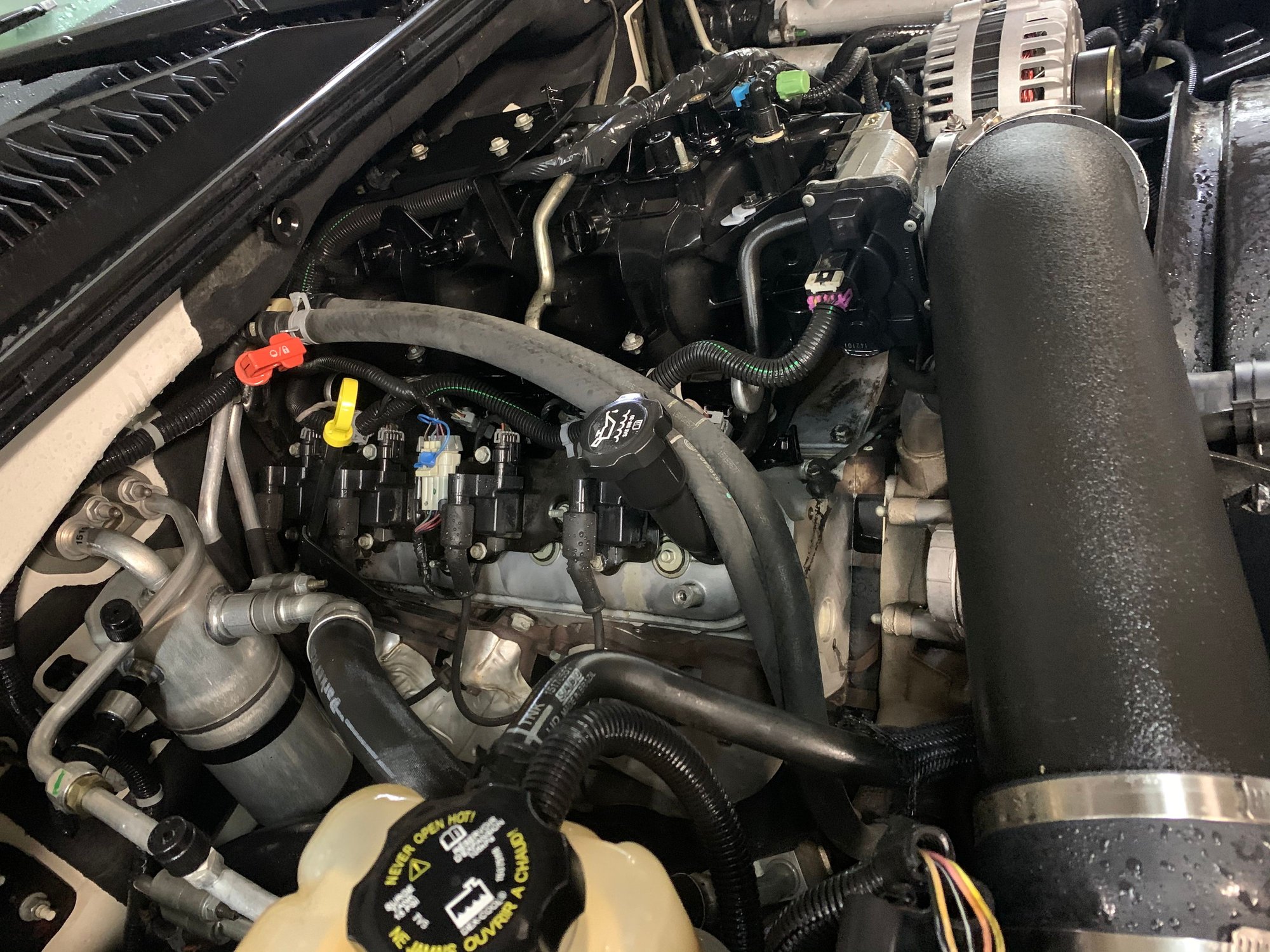

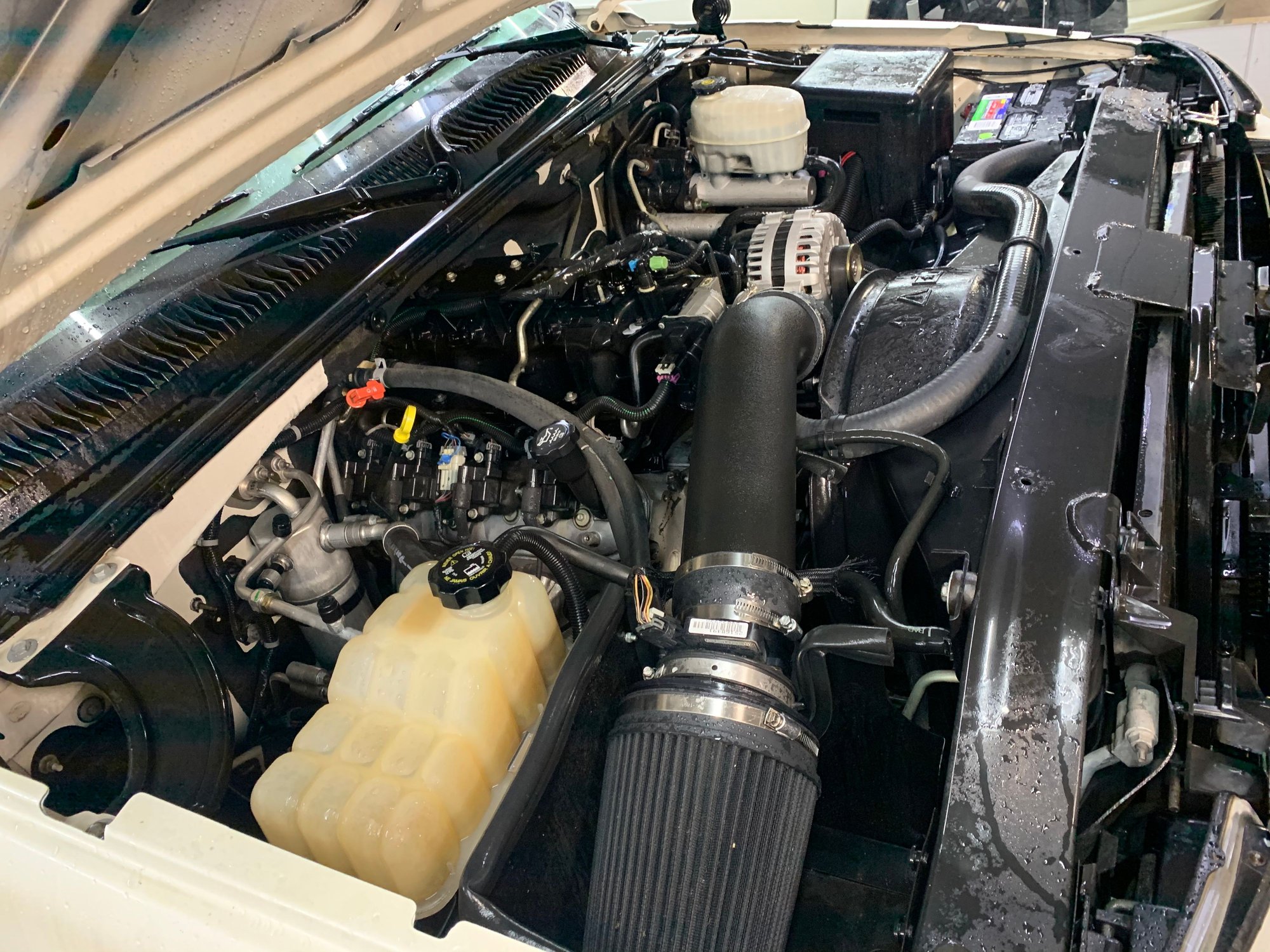

I spent sometime cleaning the engine bay today while I waited for a customer who never showed up to get his cammed lq4 truck tuned. I definitely prefer to spend the time to wash and clean everything prior to digging into it. Also one of my buddy’s wants the non return rails and I have a spare set on a 5.3l manifold I just got given to me so I’ll have some stock return style rails I can run and swap the fuel pump out and at least have that part knocked out. After that I will probably do a ls9 cam and some valve springs and valve seals while I’m in there as well as tap the timing cover for return oil drain for the turbo.
not a bad looking motor for 242k miles.

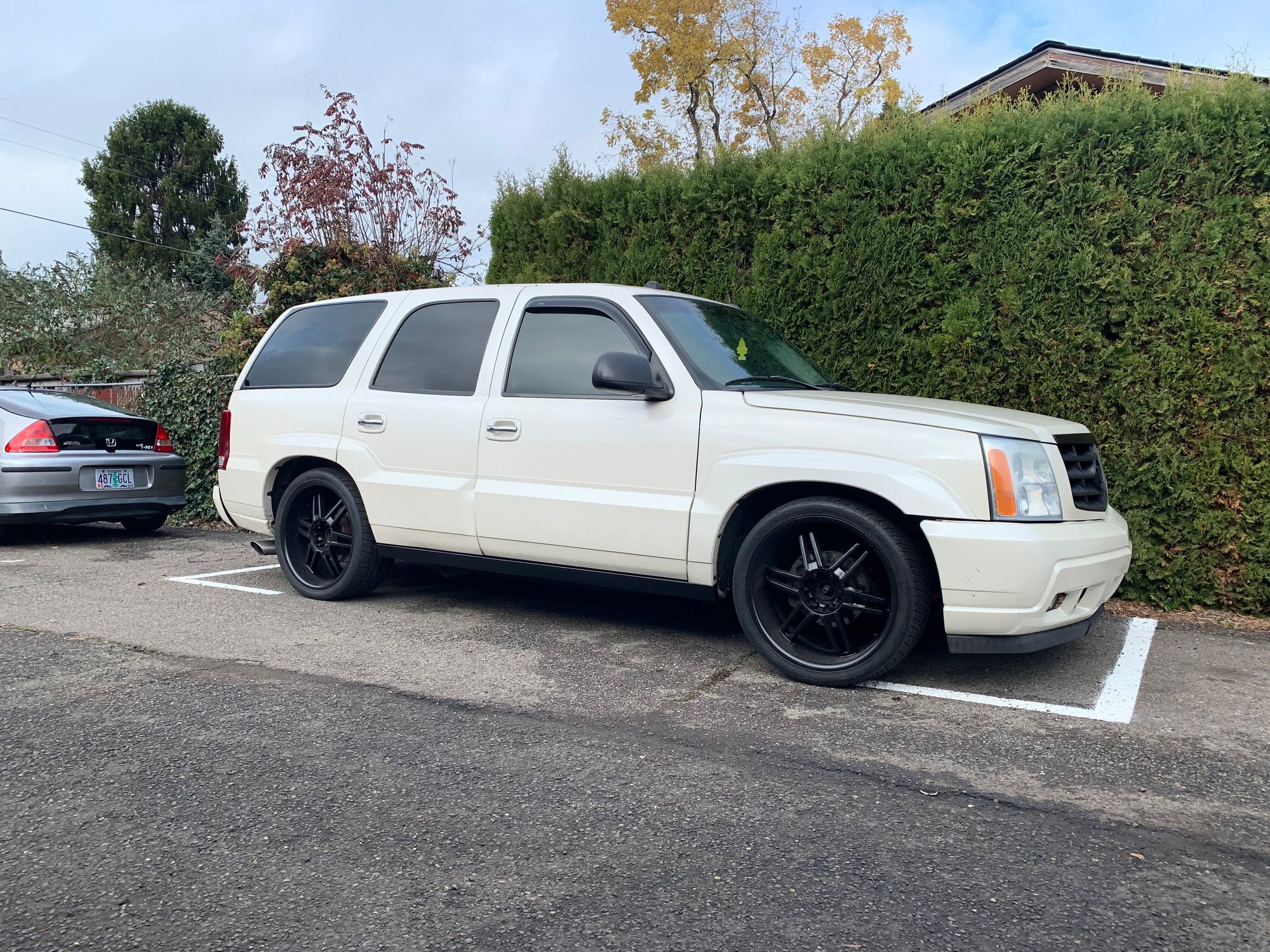

Finally swapped on the used bilstein shocks I got from pick a part off a Tahoe that was there. Compared them on the ground to the Belltech nitro 2 shocks that were on the truck and they take about 50-60% more effort to compress down. The truck feels much better after the new front shocks are on like day and night difference. Gonna swing by pick a part tomorrow and grab the rear shocks if they are still there and throw those on the back. Also ordered some new black housing headlights for the caddy that look like the stock headlights other then the black backing. Mine are fairly foggy even after wet sanding and buffing them out. And I ordered new oil cooler lines since I have one that leaks a tiny bit. Once I get the stock one off I’m gonna cut them and see if I’ll be able to run an oil feed line from them or not using pushlok connectors. If I can it would make the feedline setup super simple to do. I feel good about putting some love into my truck finally and spending a little here and there.

She cleans up nice.
