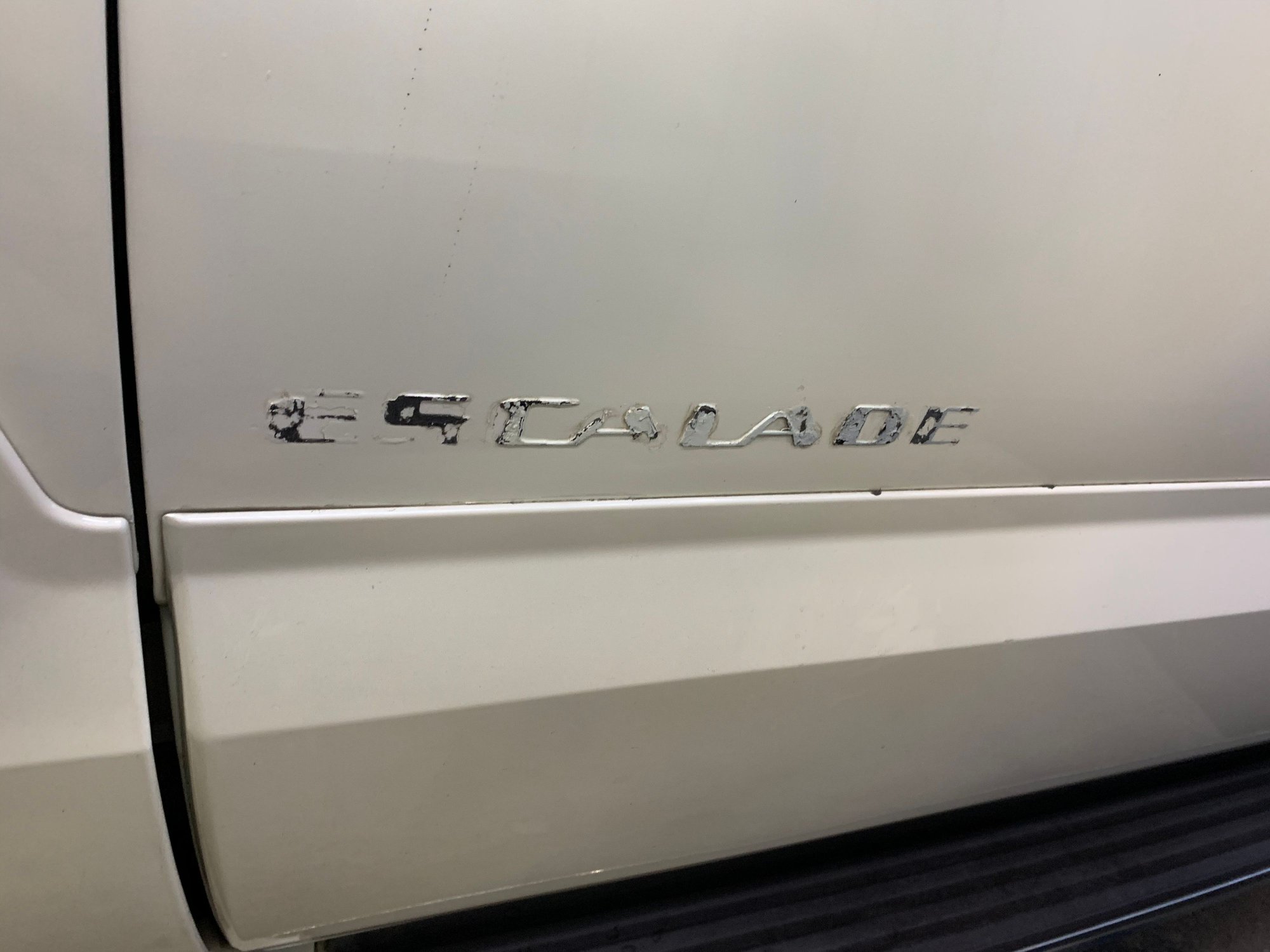

on a side note I finally pulled off my half broken Escalade emblem from the passenger and drivers side. Unfortunately the truck was wrecked at some point, drivers side front corner and whoever fixed it did a crappy job. Drives front fender sits about 1/2” low, hood has a small bend in it and the way they blended the paint from the fender to the door they painted over the original emblem double sided tape so I can’t shave that one off cleanly. Kind of a bummer but I paid $3500 for the truck two and a half years ago and other then that it’s a very clean truck. I ordered some vortec max badges to cover the fubard paint on the driver door but they didn’t fully cover the Escalade badge so I’m gonna paint the letter black and stick them back where they go. Between both sides I have enough for 1 clean set of letters. Also removed engine covers, under hood sound proofing and finally painted the Chrome trim on the hood satin black to match the grill.

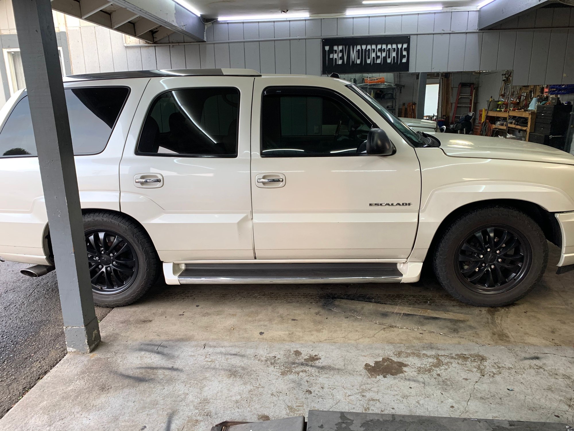

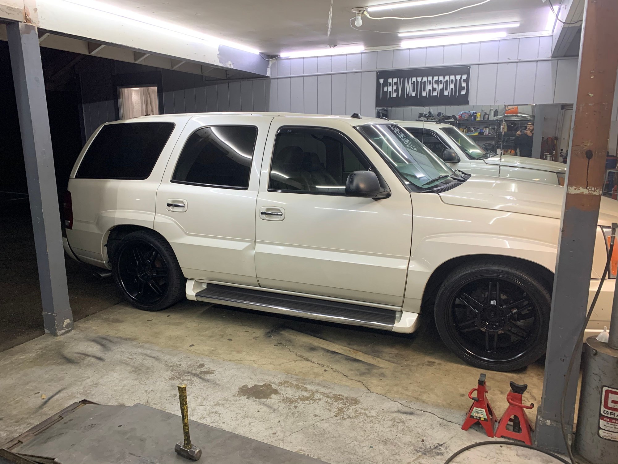

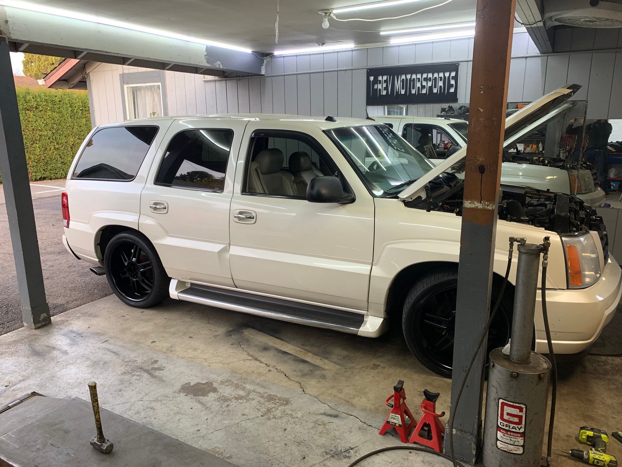

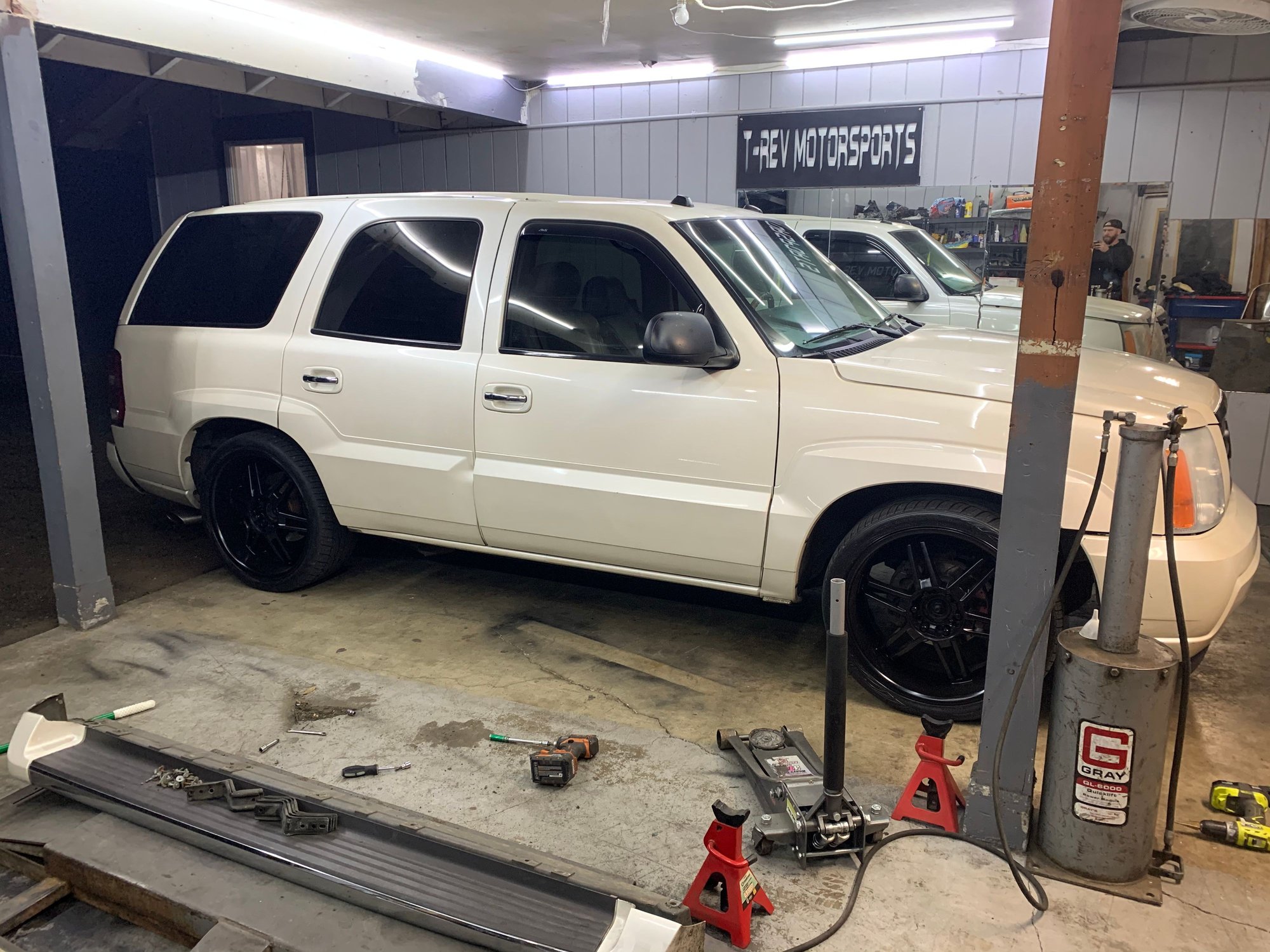

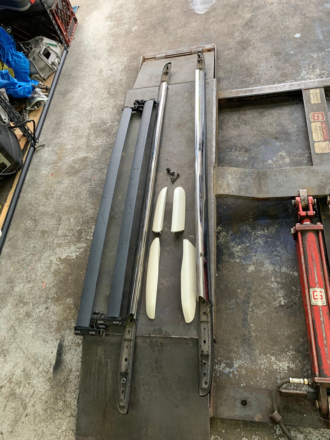

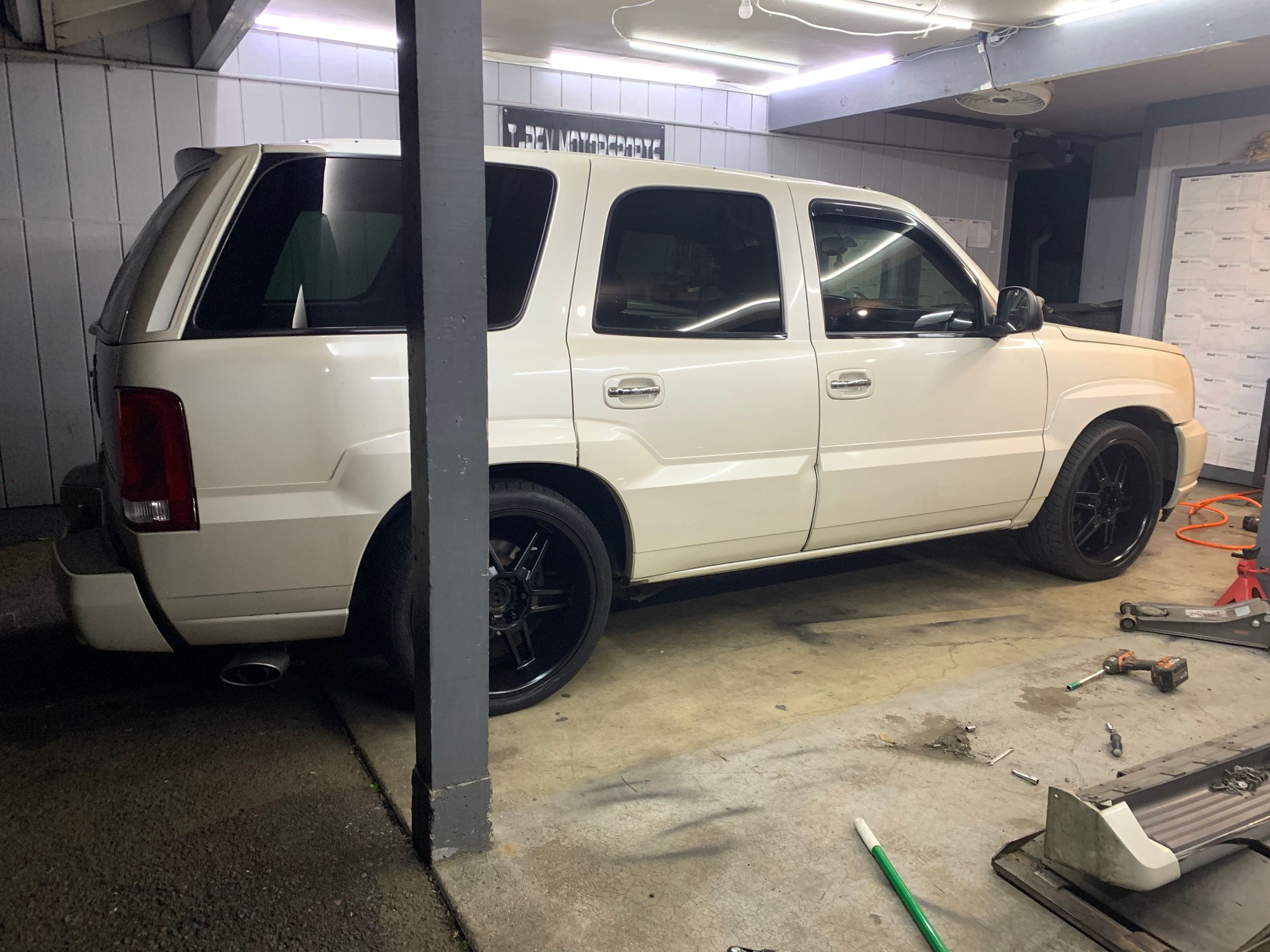

just to put the info out there the roof rack complete with hardware weighs 19lbs even, the running boards are 26.4 lbs including hardware and brackets per side so 52.8lbs total. The truck looks kind of funny without them but I’m gonna make some side skirts for it that will drop down 3-4” and weigh allot less then the running boards.
finally got the damn roof rack off. Seriously was a pain because I didn’t wanna break anything and I started on the drivers side front piece which was the hardest by far. I like the look of the truck without it. I think I’m gonna take the running boards off as well. I’ll post some pictures later but right now I gotta run to get some rounded cap Allen bolts to cover the holes. Gonna put a little rvt on the threads as well as sand the seat down slightly to make sure it gets a good seal. Its for sale if anyone wants it.

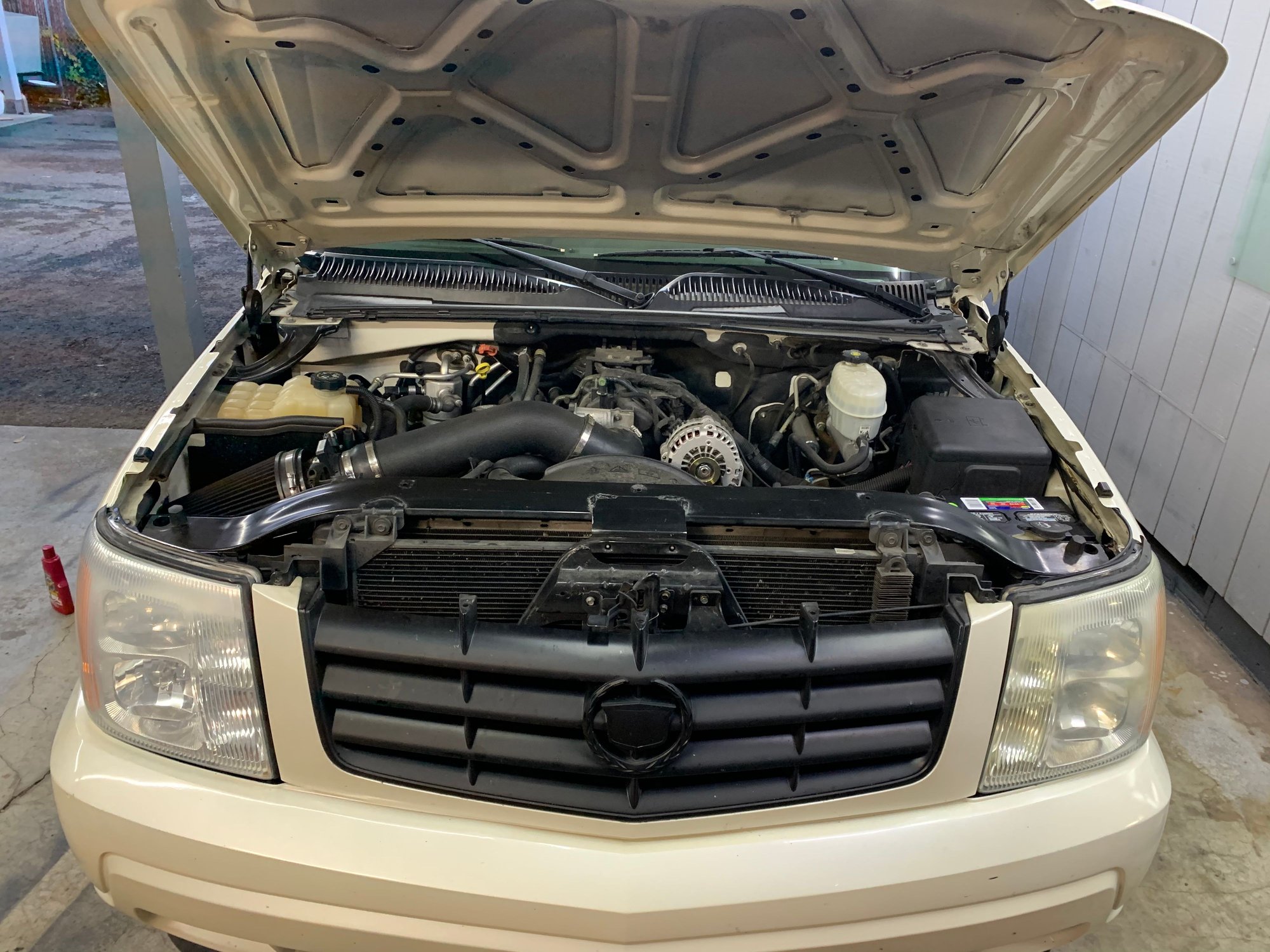

With rack and running boards
Without racks
without rack and running boards
