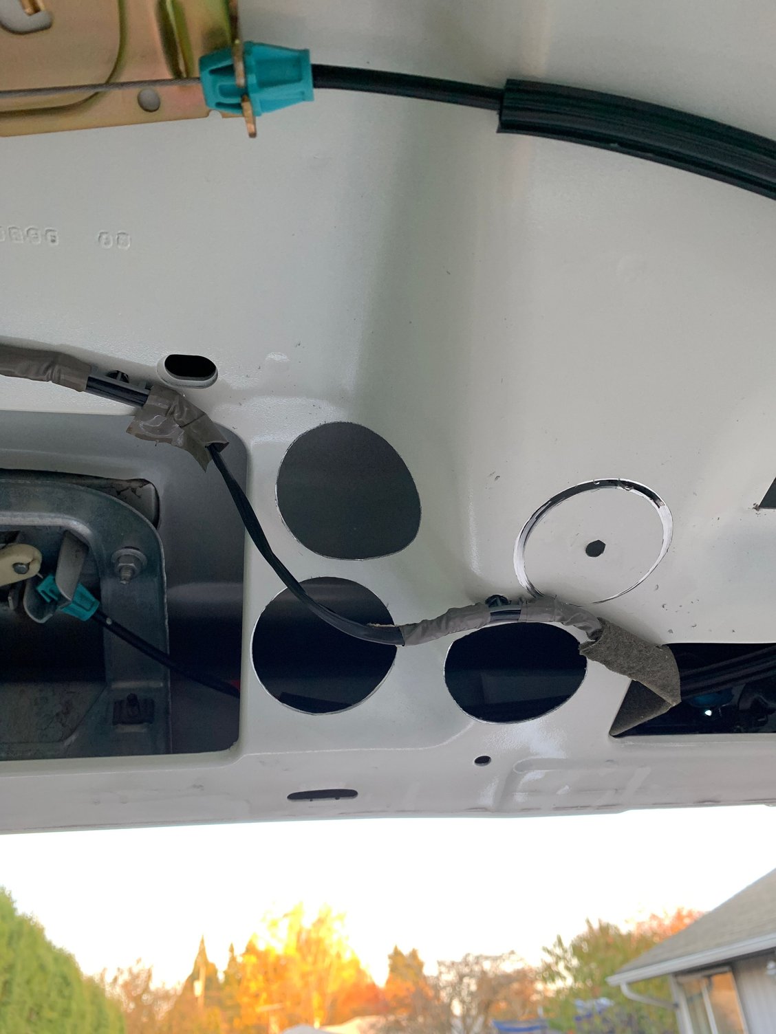

went to pick a part today and picked up a good pair of Bilstein shocks off a Tahoe that I’m gonna swap onto the Escalade. Not a big fan of the cheap shocks I put on it last year. They feel like they have great compression so I think it was a good find. Also finally got some hood springs since mine have been missing since I got the truck. And I’m currently deleting the rear wiper for a few reasons. 1, it doesn’t work. 2, I hate washing around it just to find dirt that I missed and 3, it’s just dead weight. While I have the trunk panel off I’m lightening up the hatch as much as I can as well. Its just a start, most of the weight off will be from the rear wiper arm and motor. Seems like it’s nothing but if Honda’s taught me anything every little bit you can reduce the weight will matter. It all adds up in the end. I had a 88 Crx dx that I was able to drop 380lbs out of and as you know those cars don’t have much to pull from the get go.

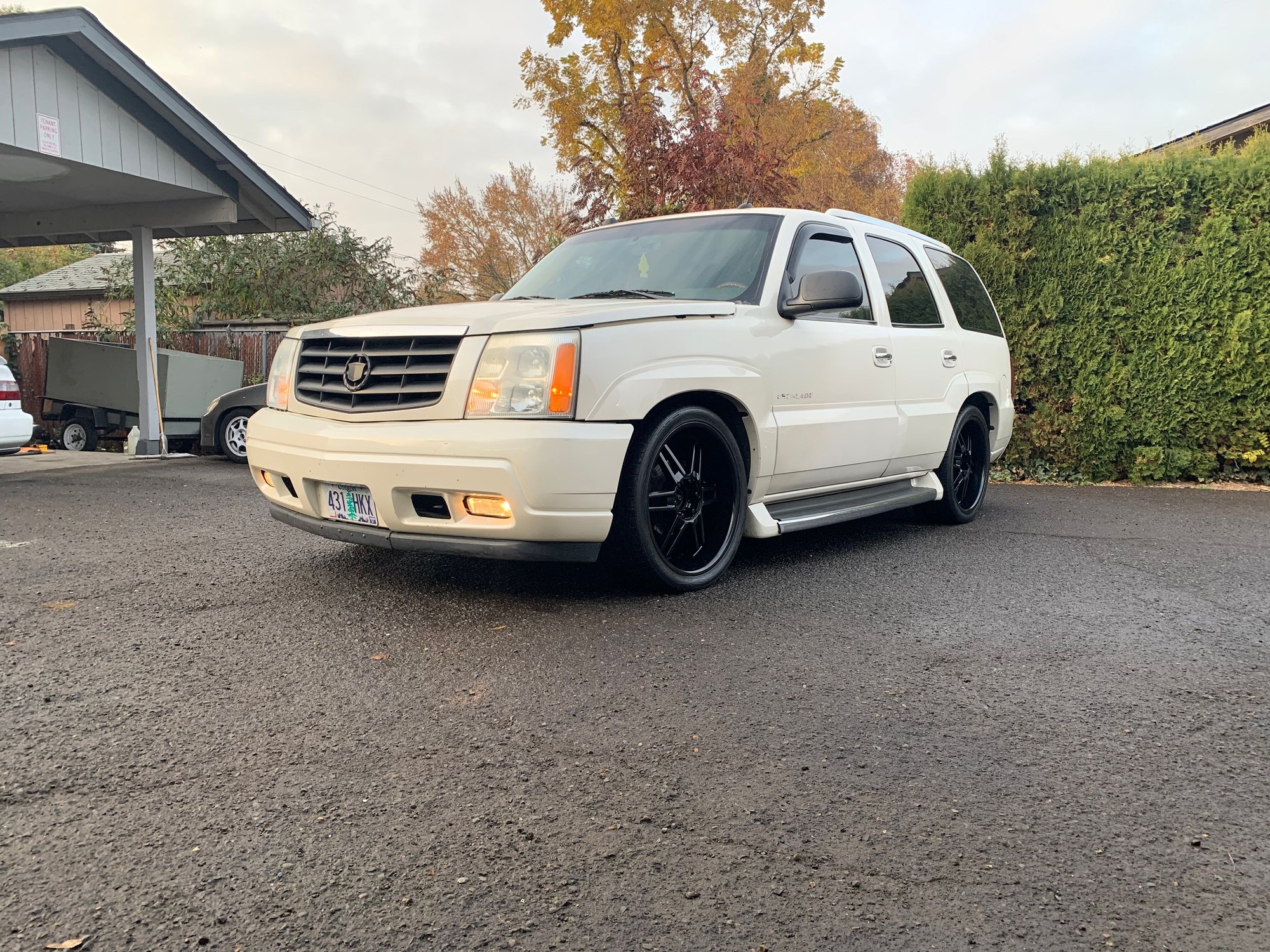

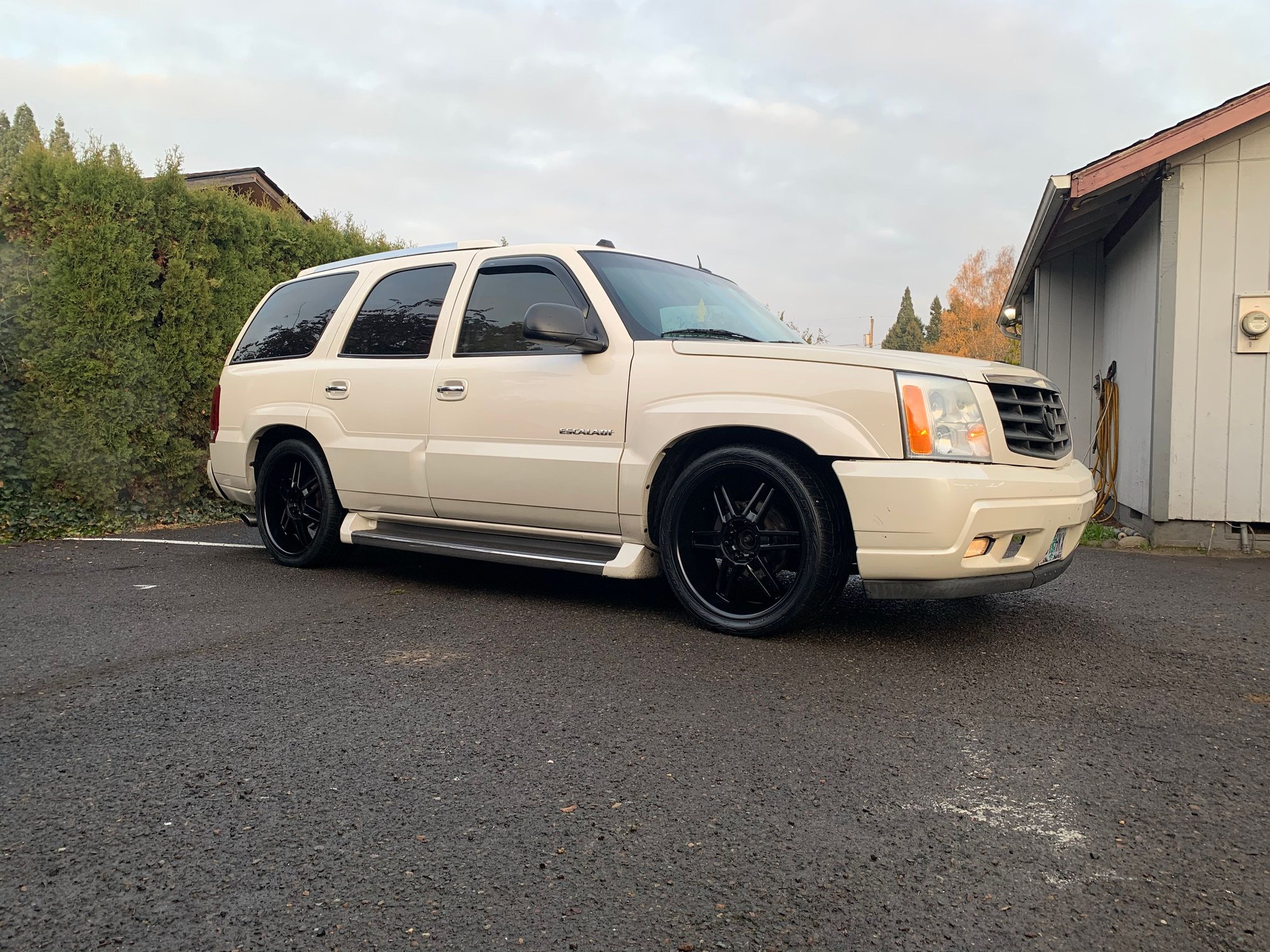

got the lug nuts finally and swapped over the 22” wheels. Also dropped the front another inch or so to get rid of the tire gap. Unfortunately the tuner lugs are too long to let the center caps sit on the wheels right so I’ll need to order some shorter ones or shorten these up some. Either way it was nice to change something up on the truck as I was getting bored with it looking the same for the last two years.
