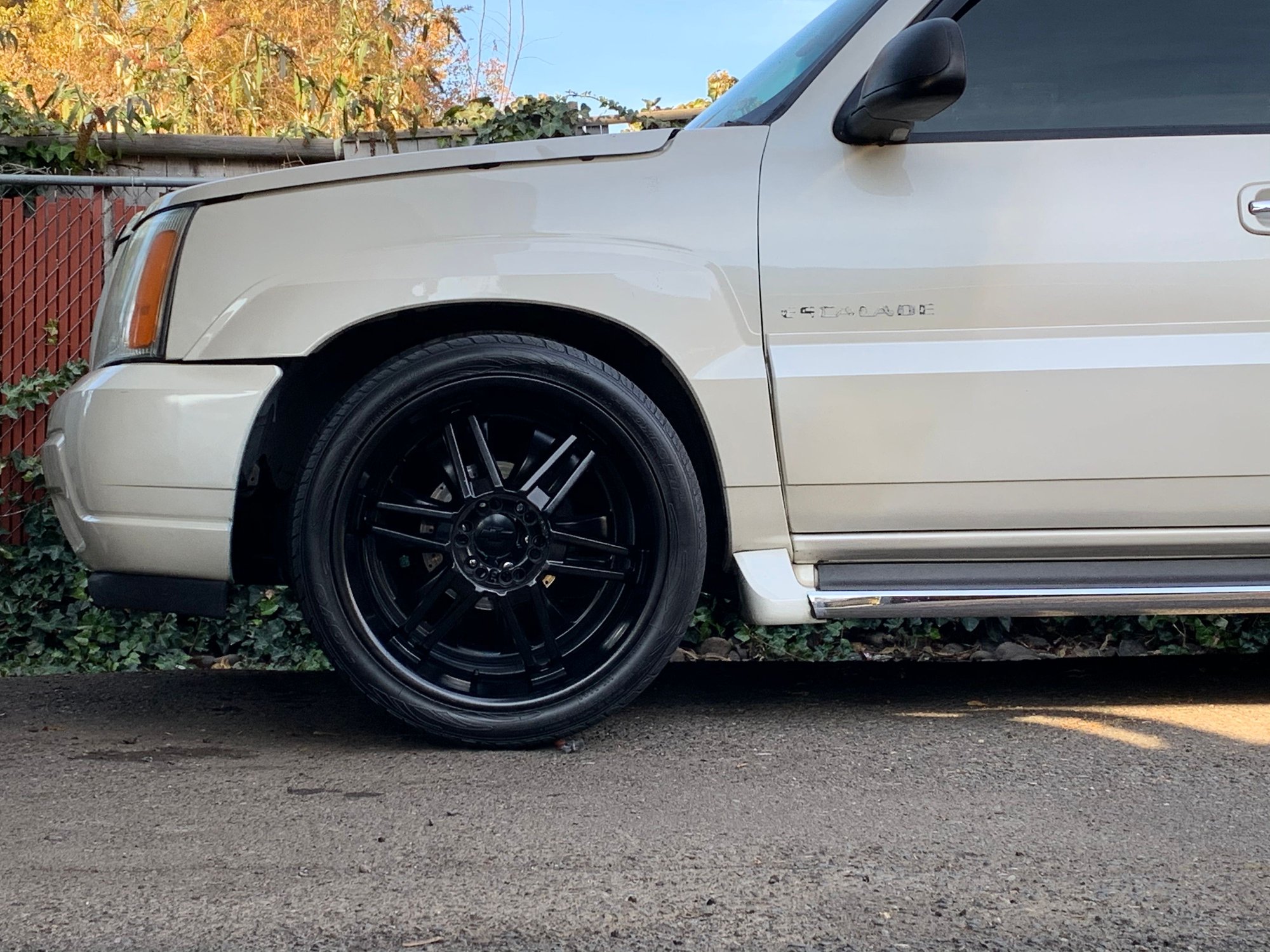

Thanks for the info guys. I just got my new wheels and tires mounted up and getting them balanced tomorrow then I need to paint them and swap them on. I’m gonna weigh the current 20’s with the grandpa tires on them and see which weighs more. I have a feeling the 20” oem wheels were heavier honeslty. I almost wanna go down to a 17 or 18” wheel if I could make them look right on the truck. I also recently traded a bike I had build for a s10 zr2 that I’m gonna sell.
Once that sells that money is gonna go towards building the Escalade a bit. The first few things I want to tackle are finding the best sway bar setup I can for my truck and doing the gmt900 front brake upgrade. after that I will probably do long tube headers and the off road y pipe. I want to leave the exhaust after the y pipe stock and see how it sounds. Just gonna tackle one thing at a time.

The 22’s with 285/35 tires ended up scaling in at 72.4lbs, the 20’s with 275/55s weigh 74.8lbs. I fited one up but need to get some tuner lug nuts to get them to clear the wheels. I think they will look pretty good on the truck. This is just the wheel sitting in front of the other one but it gives you a decent idea of what it’s gonna look like. I have $250 bucks in them total.
