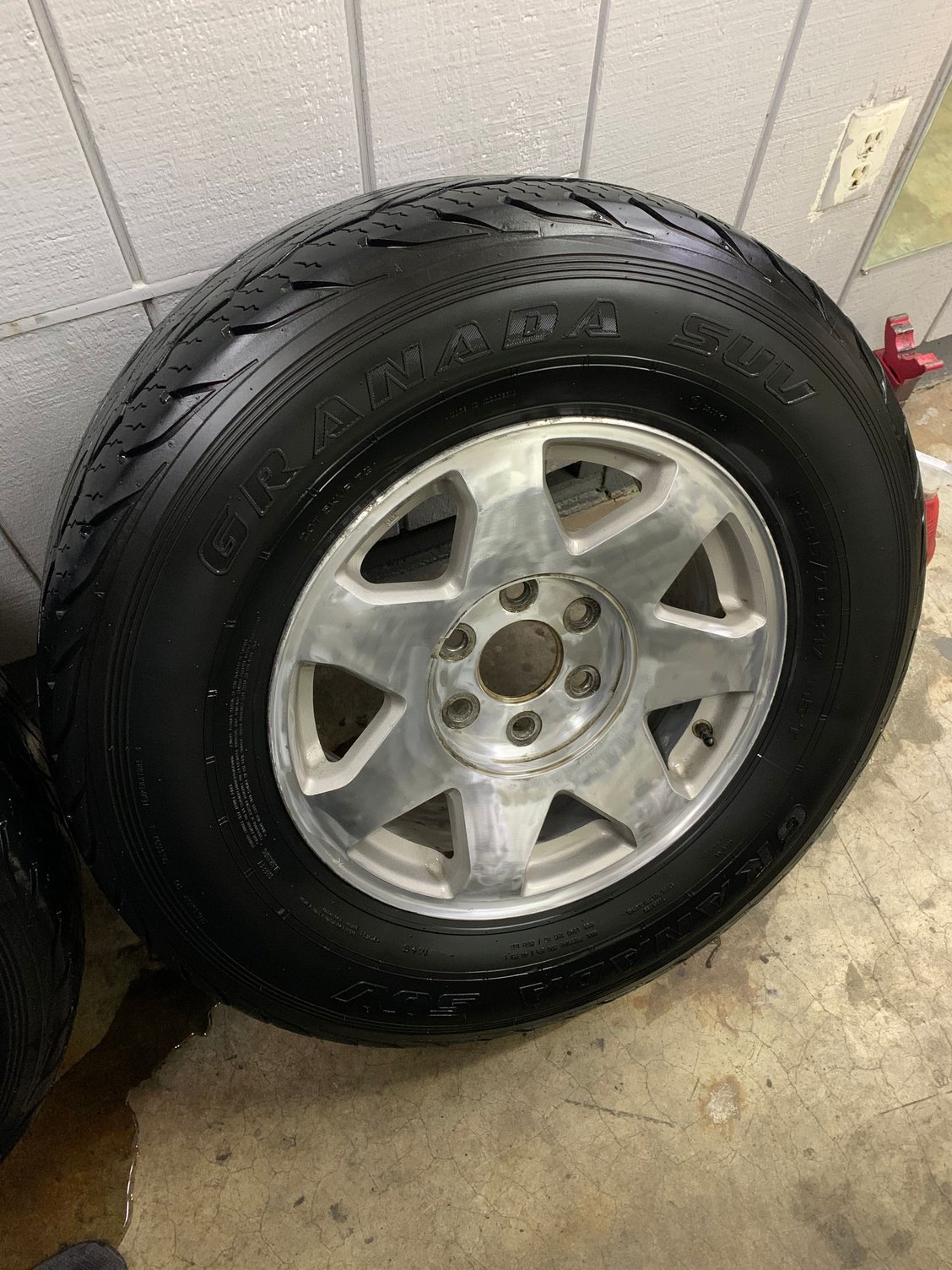

So I’m pretty stoked but I think I got the electrical draw fixed since I put a new stepper motor in for the volt gauge. The Escalade is gonna be getting a make over again. My plans are to finally finish the sideskirt on the drivers side, detail it fully. I also picked up some stock 17” escalade wheels for it today for $60 that I’m gonna strip down and paint the wheels themselves satin black and leave the center caps aluminum looking to kind of give it the ppv look. I think I’m gonna go with a 275-60-17 instead of the stock 265-70-17 size which will be a little shorter and a little wider then measure how much I can push them out and order 4 wheel spacers to make them sit pretty flush. I decided the s10 is now the “race” truck so this is gonna get revamped a bit more as a comfy daily. The 285/35/22’s on it right now just ride a little harsh plus one is bent and I can’t seem to find a replacement for it so I’ll get those posted up for sale once the new wheel setup is on it. I found a big scotch brite wheel for my angle grinder that does a killer job of taking off the oxidation on them and the clear so the fresh paint should lay out really nice.

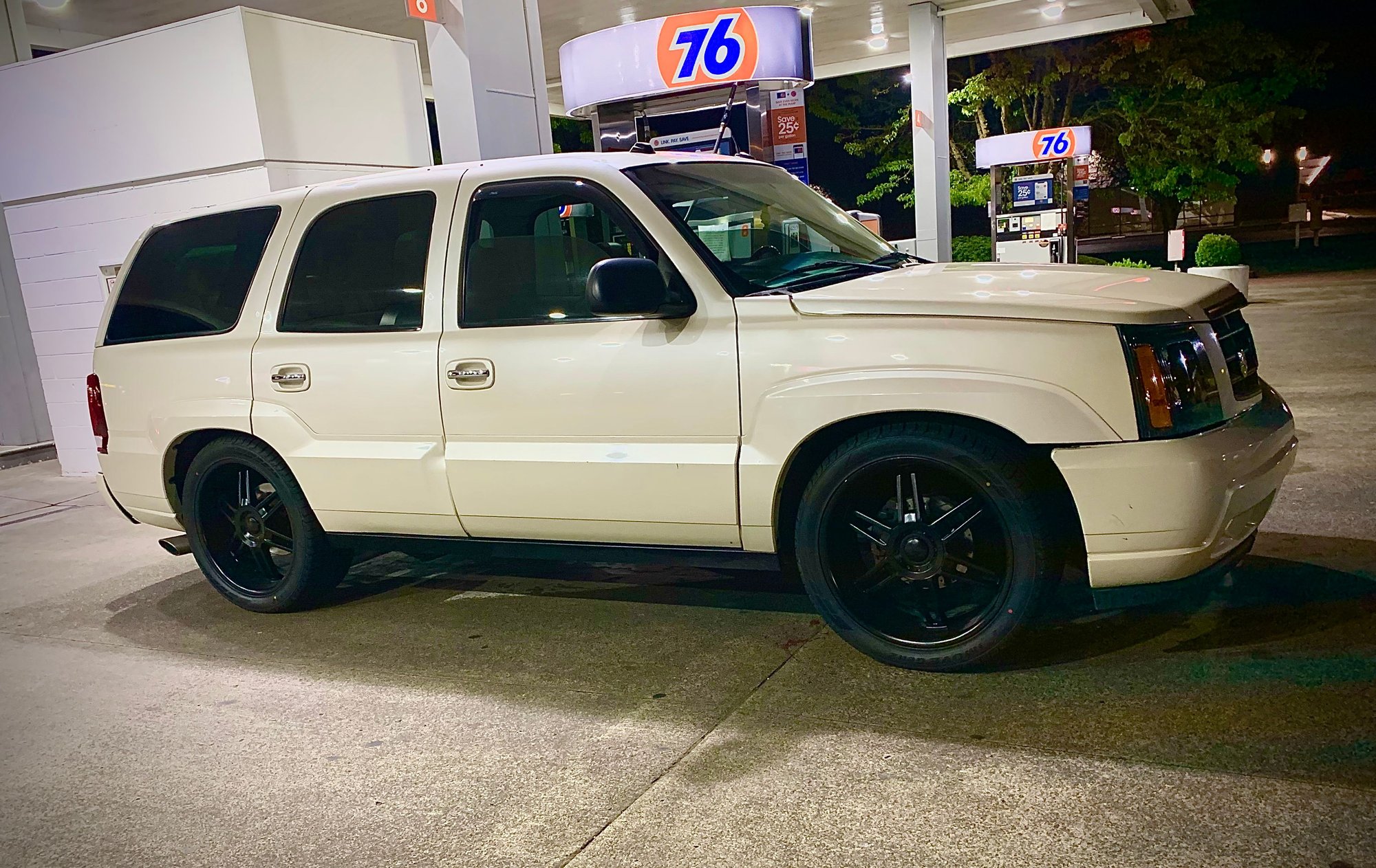

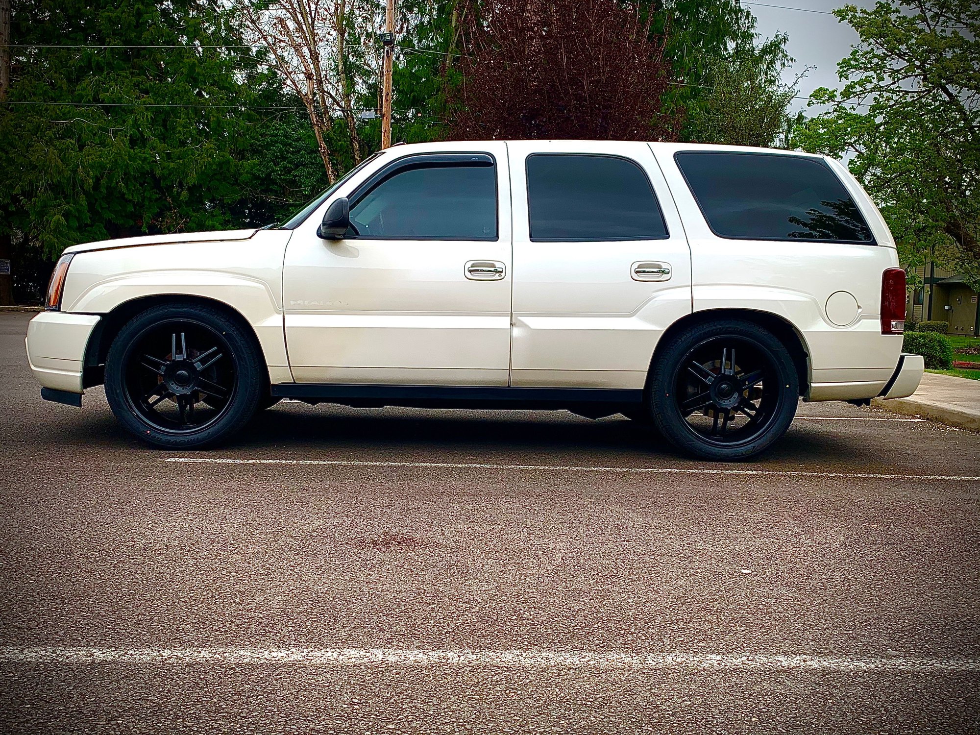

finally got some new tires on the Escalade. I couldn’t stand the 285/35/22’s on it anymore and went to a 305/40/22 instead. Once I got the new tires on I realized the driver side rear was almost 2” higher then the passenger side. Tried swapping the springs from side to side, that made no difference so I ended up cutting 2 coils out of the driver side rear spring and that leveled it most of the way out. Also after I took these pictures I played around a bit with adjusting the front torsion bolts and got the front leveled out so it sits much more even now. I also ordered some 1/4” spacers to put on it just to help it be a little more flush. Didn’t wanna step up to a bolt on style spacer and have them way pushed out or have to cut the lug studs down to fit them. It rides much nicer and looks allot better rolling now. I have been thinking a little bit about trying to trade the Escalade in on a trailblazer Ss but I don’t think anyone would give me what the truck is worth to me since it just hit 245k even though it still runs as good as a new truck would.

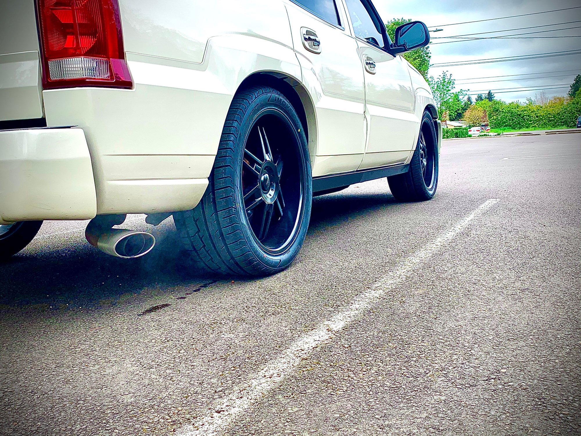

Yeah kinda crazy how cheap 22” tires have gotten. Here’s a better picture of how she’s sitting right now. Overall I’m happy with the stance of the truck. I’m just gonna do a few cosmetic upgrades to the truck and try to keep it clean and enjoy it as a reliable daily. I think I need to just stick to building ls s10’s for my fun go fast trucks since they are soo much lighter they just have much more potential then trying to build something heavy.
