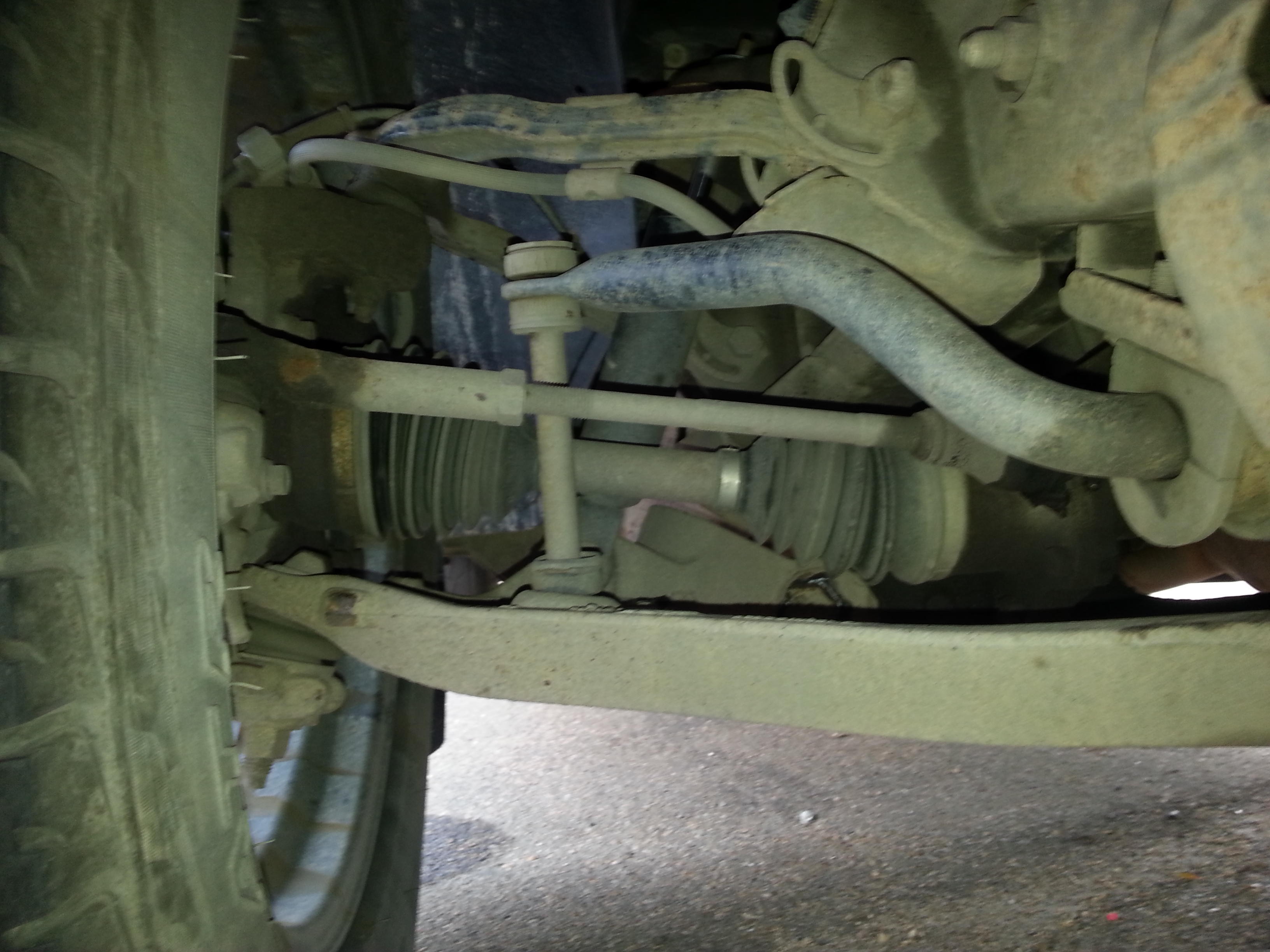

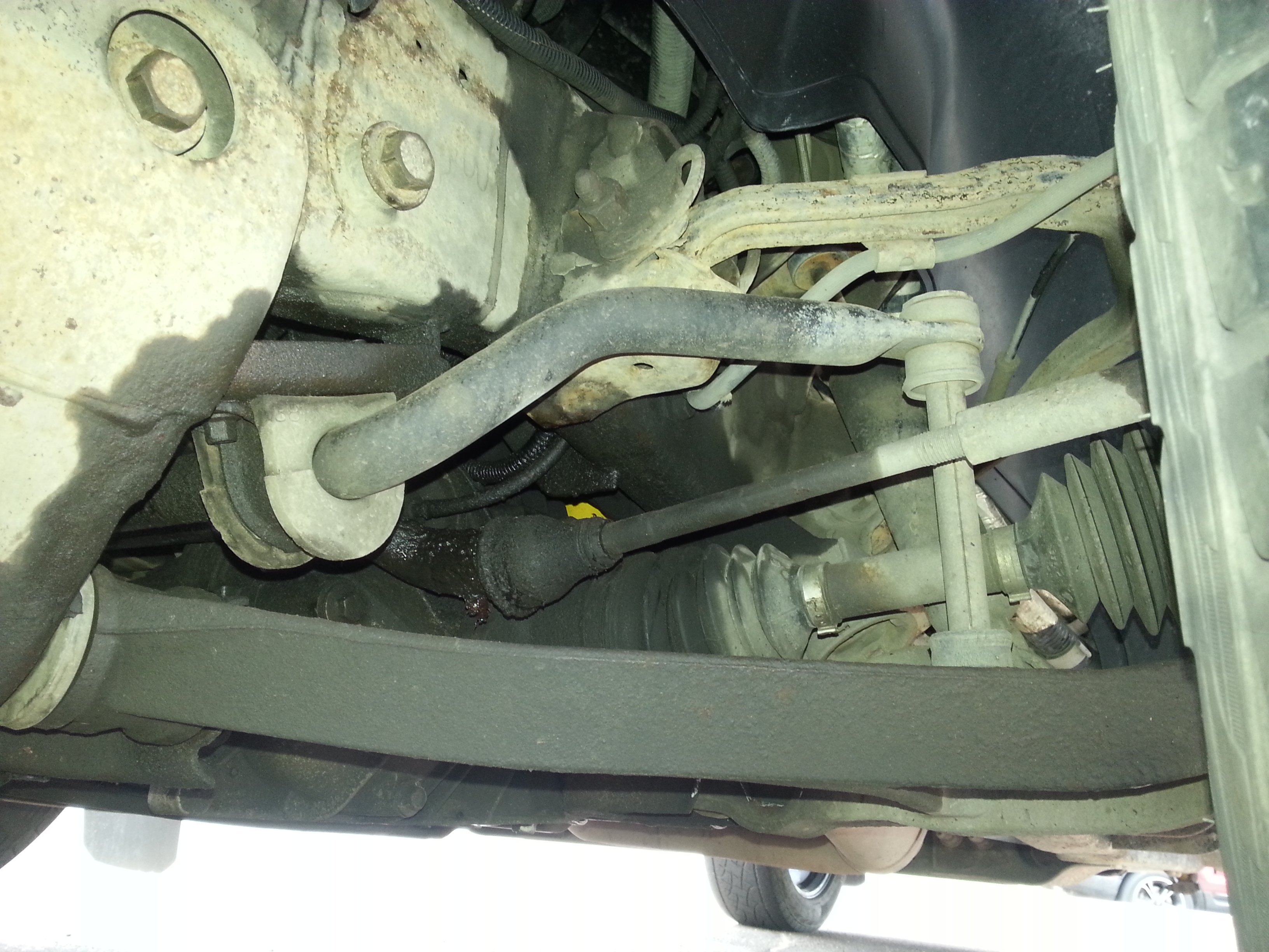

Here's some more pictures, do you think these CV angles look okay?
Don't mind the oil, it was a PS hose that's been replaced:
I've seen a whole lot worse CV angles live long & happy lives with 600+ hp.
Keep an eye on your upper ball joints. They don't always live long at those operating angles. When they need replaced, you can flip your upper control arm over, and press the new ball joints in from the other side. Huge improvement for the operating angles of the upper BJ's.
