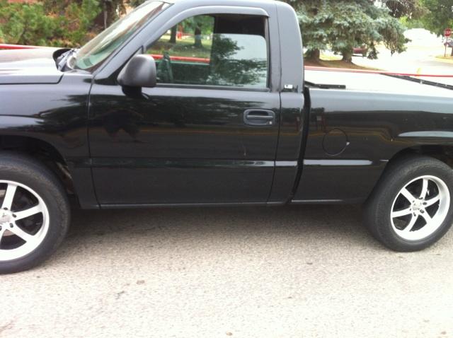

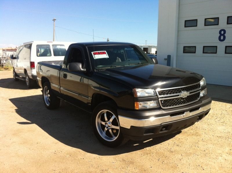

Hey, I just picked up a "new" truck to use as a work commuter. It's a 2006 Chevy Silverado 1500 Regular Cab Short Box 4x4.
The previous owner said it had a "3 inch lowering kit" installed when he bought it new, but he removed it to try and make it sell quicker. Lifted trucks are more common in these parts than lowered.
He gave me all the spare parts but I'm trying to figure out what I'm actually sitting at now, and where I'll be with the parts I have.
Current measurements from center of hub to fender is 22" on all four corners. Fender to ground is 36.5" up front and 37" out back rolling on some worn out 275/55r20's.
The front has the stock Green keys and the back has a 2" block. He did leave the lowering shackles in there though and are set on the top bolt hole (lowest height).
Pics of current set-up:

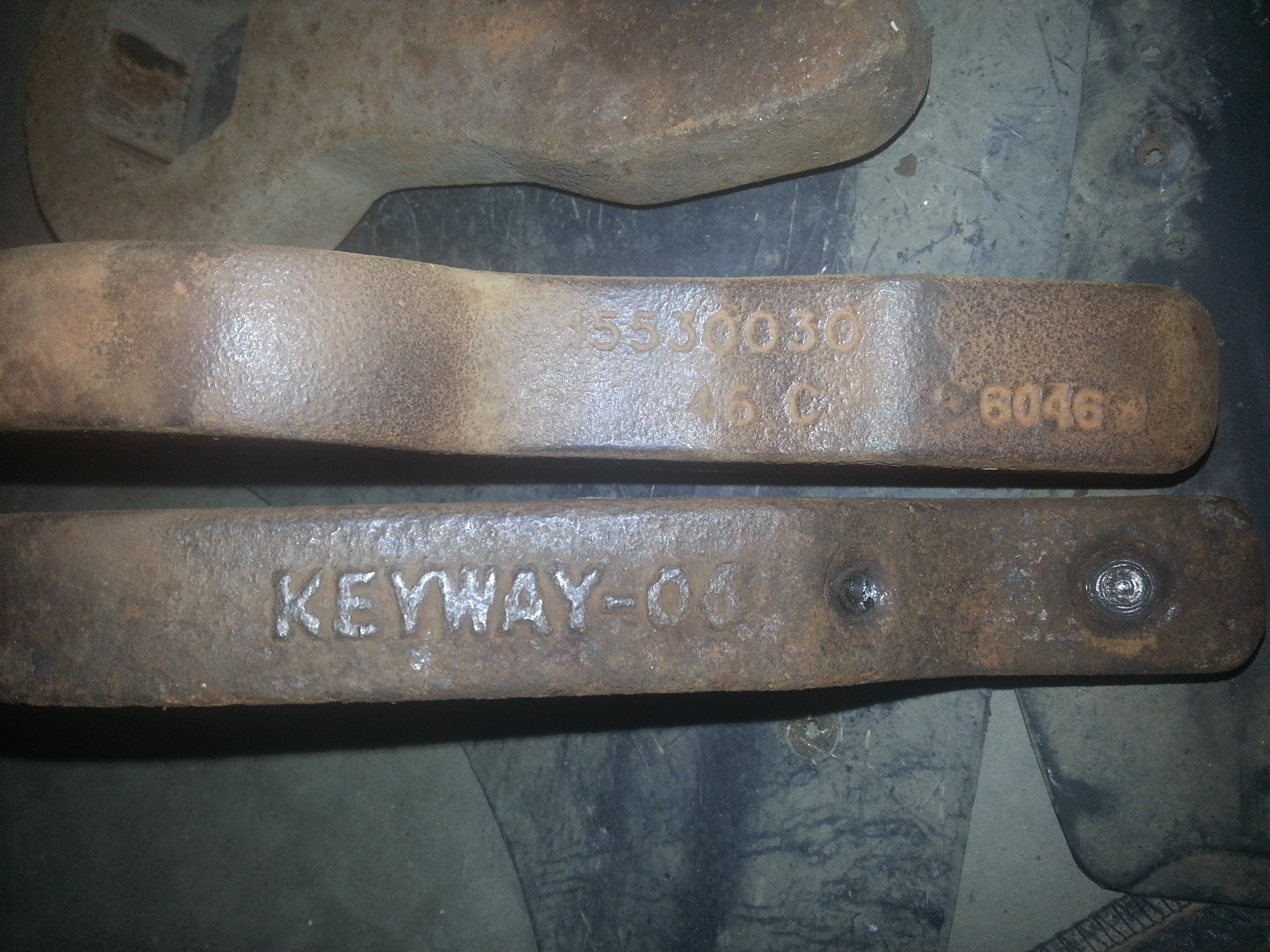

The box of spare parts has two sets of keys:
The ones stamped Keyway 06 are the lowering keys that he removed, online they say they're good for 2-3" of lowering. The other keys look like GM part #'s but not sure what they're off of. Indexing looks the same to the lowering keys though.
I'm not looking to spend any money on it other than a wheel alignment and it still has to be somewhat practical. So the most I can get out of the back is to just pull the 2" block, but what about the front? Can I decrank the stock keys enough or should I go ahead and swap in those lowering keys too?

Decranking the stock keys should get you level with the back if you remove the blocks.You will need new U-bolts for the back and will have to trim or buy aftermarket front bumpstops on the front. This is what I did on my truck

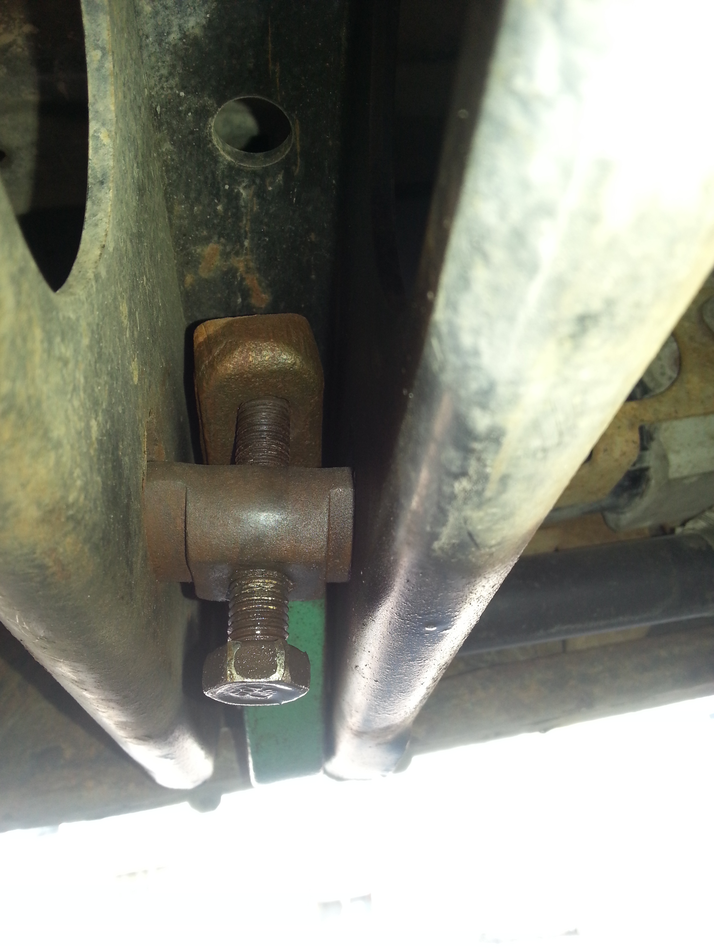

Here's some pictures of the current suspension so you can see what I'm talking about:

Yes the 4x4 trucks have the 2'' block from the factory, and when you remove them there wont be enough threads on the u-bolts to tighten them...get a set for a 2wd truck . You should be able to get the truck level with the existing keys and remove the rear blocks.
