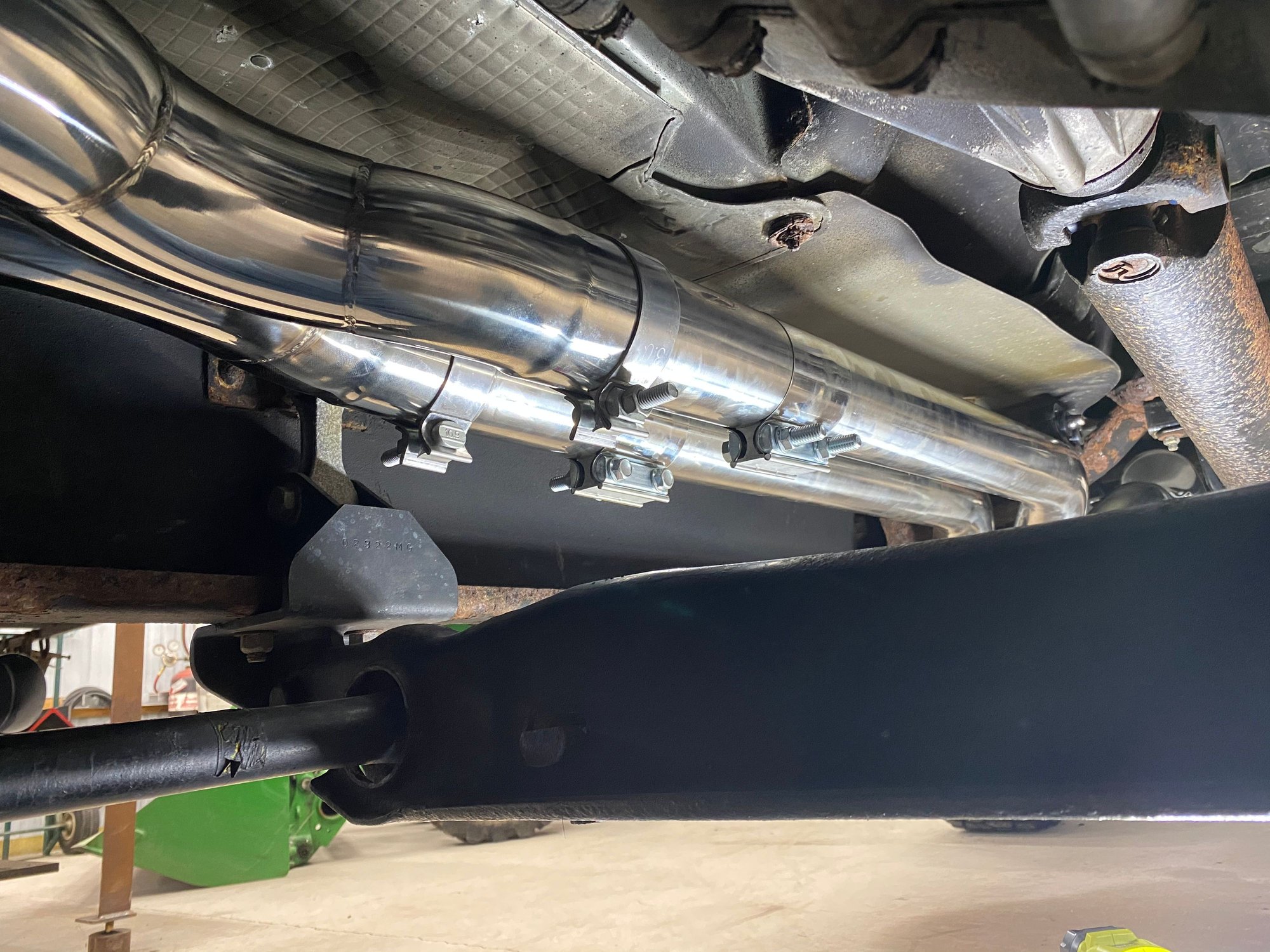

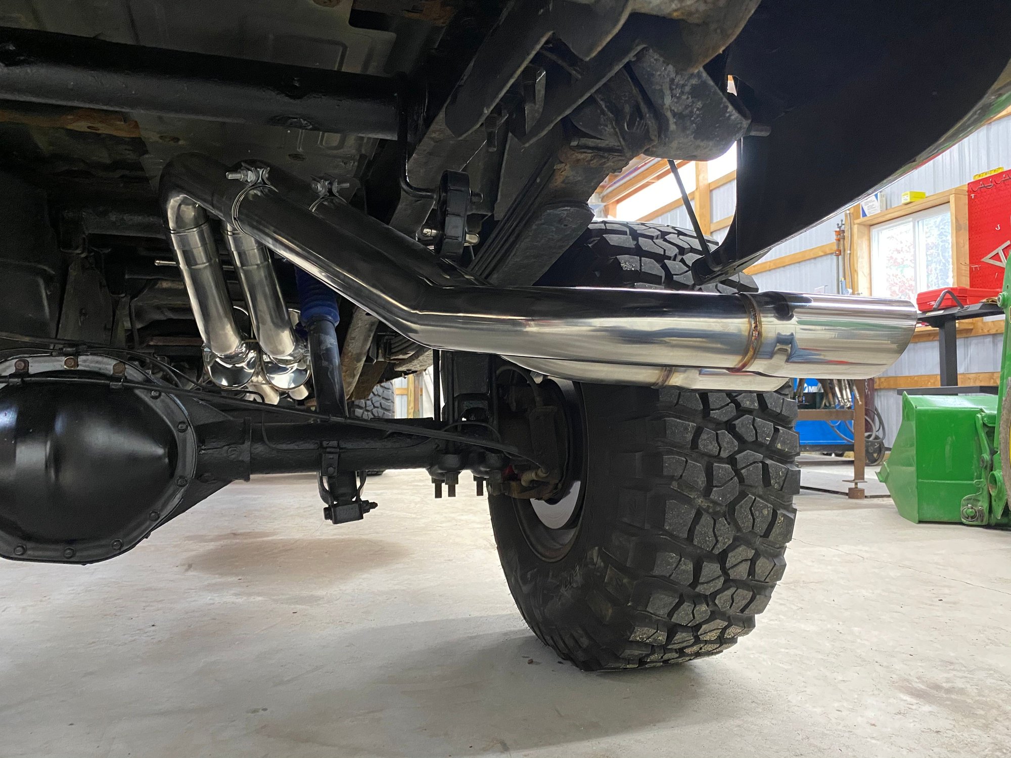

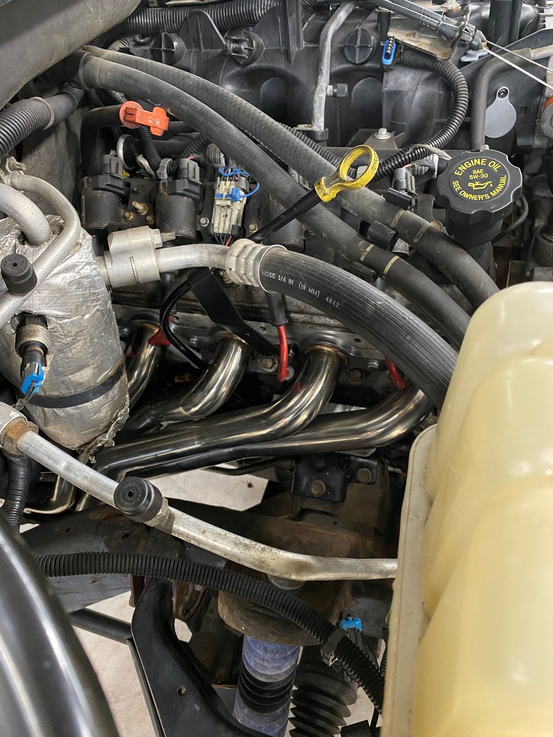

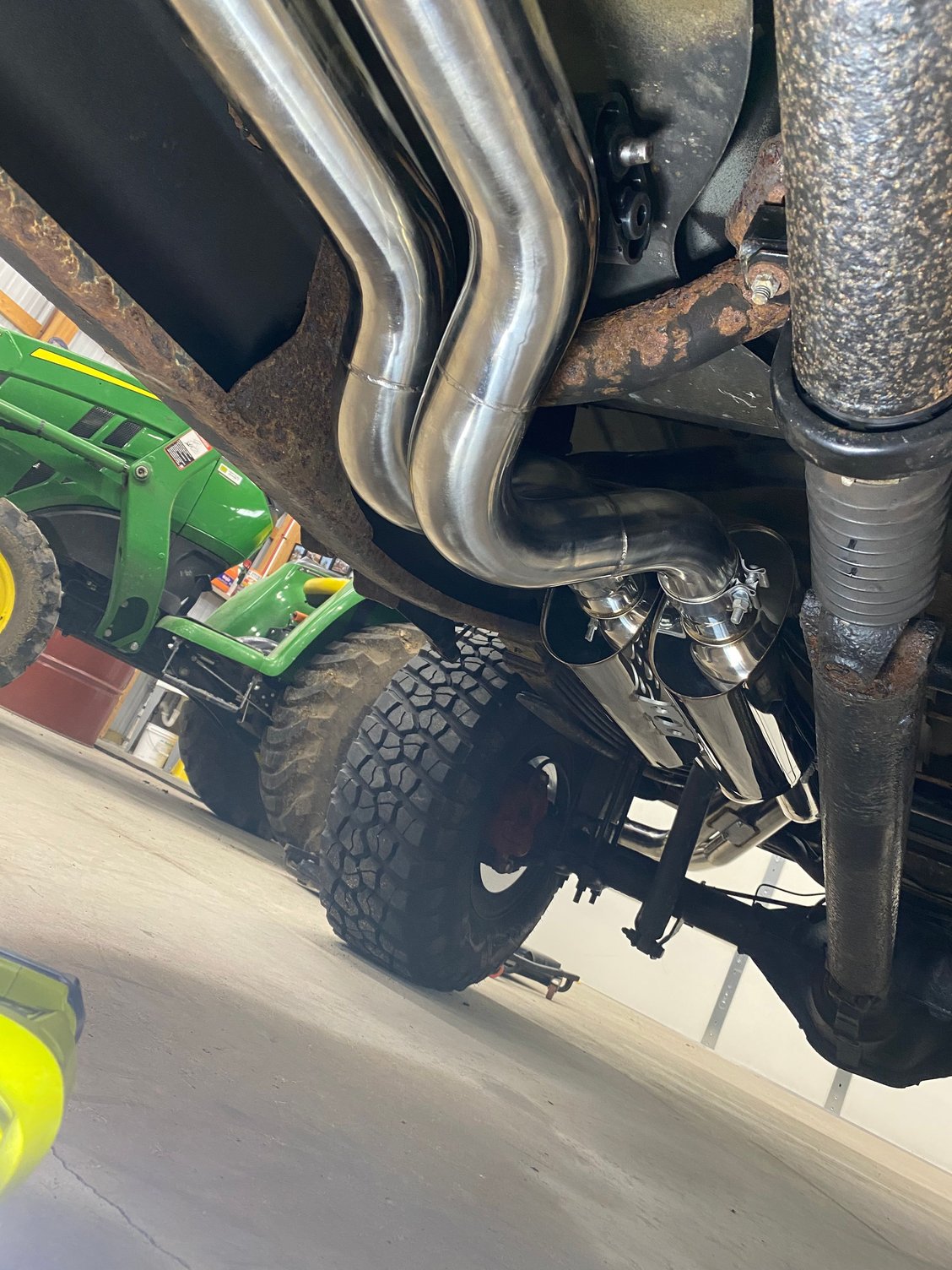

Ok started working on the truck again. When the wife ask “what’s that ticking noise?” That’s when you have to addressing the leaking exhaust manifold. So as much as I wanted to do everything at once, I couldn’t. Just gonna piece everything in for now. But I installed the Speed Engineering True Dual Rear Exit Exhaust this past week. Everything kinda went well. Luckily I got to do it inside my brothers pole barn to stay away from the cold weather the north east just got. But we got the exhaust out without breaking any bolts out of the manifold. Luckily the 2 that were already broke were just the heads and they had enough to grab with vise grips. The rest was cut out with the good ole sawzaw.
But there was a catch with some non exhaust stuff. First the dip stick gave us trouble. After looking this up, I found out it was a common issue. So it broke in the block. We screwed a lag style screw inside, lubed up and pulled and preyed. Luckily it popped out.
Second issue was that I had to replace my stock starter that worked perfectly fine until I tried removing the wire on the tiny stud. Of course it snapped so I got a new one of those too.
But the headers went in great. I installed my egr delete plate into the intake while I was in that area. The rest of the exhaust went into the areas fairly easy. I installed new rubber hangers with the exhaust bc the originals were crapping out.
After I got everything into place I noticed an issue. I was a little short on pipe. I called SE and they told me that with that kit with the 1500HDs bc they have a 6.5 bed instead of a 5.5 bed that I have to extend the pipe that is after the Xpipe. And yes it was in the description of there product so it was my fault that I didn’t have all the right parts.
But I fixed that issue with ordering a 4ft piece of 3” stainless 304 exhaust tubing and 2 stainless butt clamps. Each piece I cut was 9”. That was enough to fix the open space.
Once all the exhaust was fitted and tightened fairly in the clamps I went around all to all the clamps and loctited them, them cranked them tight. Everything tightened up nicely. There’s a few areas that I’m gonna have welded so there’s not as much clamps and for some security.
Once I started the truck I checked all around and didn’t hear any leaks. Mission accomplished. So for right now the rear oxygen sensor wires are tucked up and the egr wire is pushed away so it does get caught on anything.
I took the truck for a quick spin. It sounded very nice. I don’t think I’ll hear any type of drone. Once I give it a good 20 plus mile drive I’ll hop underneath and check my clamps. But so far I’m very happy with how the kit went together, the way it looks and the way it sounds.
