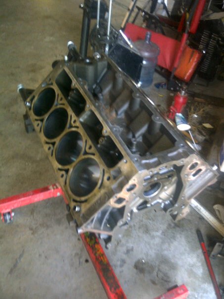

I have the iron 6.0 ripped out and bear.. within the week I'm putting it back together. I've had the gaskets and the oil pump ordered but I need HELP!!! I don't know what cam to put in the engine! The original cam comes has a .467 lift on the intake and I want a lift in the .580-.650 range... I'm not sure what brand to go with or what lift. Also i hear that high-ratio rocker arms are a must when swapping cams. The stock ratio on those are 1:7:1 and I have no clue what ratio would be good for whatever cam I want.
The engine has been machined so I'm not sure what size my cylinders are at this point.
One more thing... The intake that's going on the engine is the original truck intake because of the torque it creates... but since this truck isn't going to be on the strip much I want to have the nice classy corvette intake with the ls2 covers, but i've heard that the intake will not fit because of the heads that come on the LQ4. Anyone hear any different? Any help is appreciated!

lets see first off 1:7 rockers are fine you wont need new ones unless you just wanna raise the lift of the cam. your cam choice will come later after you decide what else youre wanting to do and accomplish with the engine, now if the block has been machined you deffinitely need to find out the bore size before actually doing anything else specially buying gaskets or parts. break out the micrometers and start measuring.
what did the machine shop tell you as for as bore size ? why did it go to a machine shop? to be freshened up?
The motor was machined to get freshened up because of the miles on it. I know the crank is now .010 and the head gaskets need to be .030 other than that I need to call them tomorrow.
