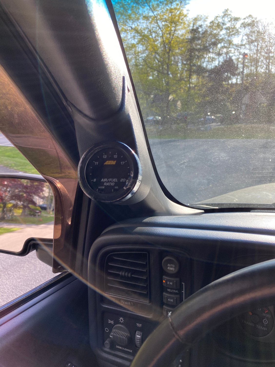

Hey guys I did get the aem wideband and door pillar gauge pod. I used that sem paint. It matched up great. Have the gauge installed n the wires coiled up under the dash waiting for my *** to install everything. I’m wondering if I bit myself in the butt and needed to run the cable that plugs into the sensor is going to go through the bulkhead with the plug. Might have to take it back off and run it through from outside to inside.
