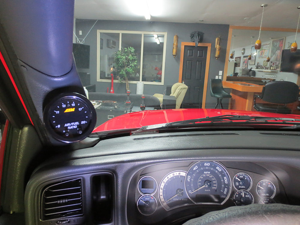

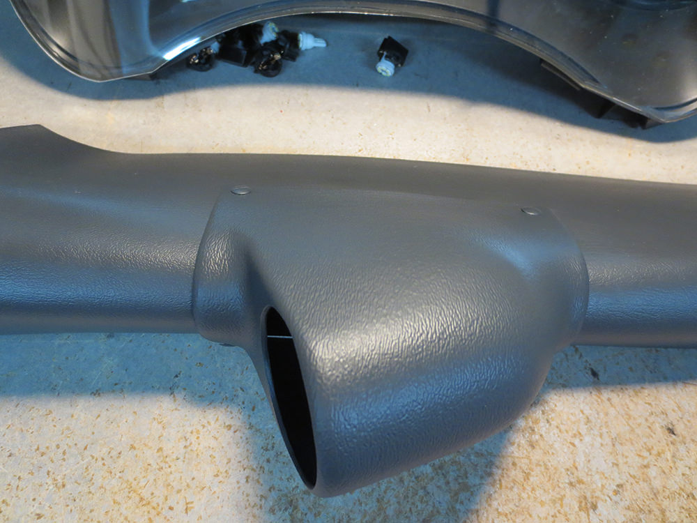

I'm using the AEM 30-0300 X-Series wideband. If you have the "graphite" interior color the SEM 17113 Graphite Classic Coat is a near perfect match for the gauge pod but it's about $20 a can lol
Only the pod was sprayed showing a nice paint match with the A pillar trim.

That looks really good. After doing some more research it’s seems like they will all work by using them standalone. But I’m more confused on the canbus, analog or whatever it is to hook up so the computer reads everything also. I want to use the most of it if possible. I may not be able to have it wired in but I just want some reassurance before I buy the wrong one for that.
