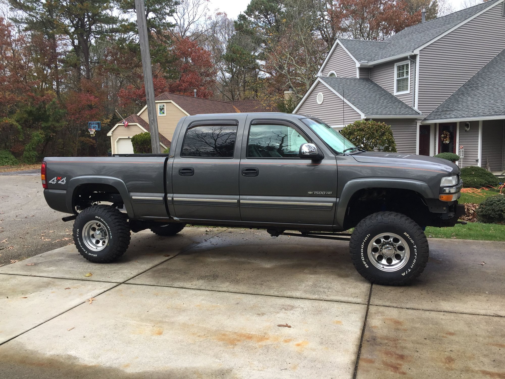

Yeah, thanks guys for the info. Lol, I did use paragraphs when I posted up. When I went back to read it was formatted in one big blob. I admit I did get a little talkative. I think it was bc I’m on a iPhone and I wrote it up on the full site style.
I originally thought my lq4 was cathedral port but when I saw the cart I have it showed it as a rectangle port. Had me a little confused when I started to read that some people use the tbss intake n some said it wouldn’t work.
I’ll definitely look into the 706’s. I see their combustion chamber is lower so I guess more compression? If I found head that we’re bare, would it be worth the cost for AM valves, springs n rockers? Or just do OEM?
Yeah my truck has a 4l80 trans. Have to do my filter when it gets warmer & while I’m at it I’ll be replacing the trans lines. They are looking a little rough. Already did brake lines with the OEM kit n SS fuel lines.
Yes the truck is large n heavy. PITA to turn too. When looking at the reviews from back in the day, that was one of the only complaints. I just go to the back of the parking lots.
But as for the power curve, definitely looking for low to mid range. No big top end really.

I don’t get it. I’ve tried using both the full site and mobile site. I’ve tried typing responses back and when I go back there is nothing there. I’ve been on other forums and never have had this issue. Anyone else have issues posting? It took me several time to finally post the picture of my truck and the chart.
Well I just purchase some 706 heads. Saw a great article on superchevy where they did some extensive head test. 706’s made more compression bc of the smaller ccv. Can the rockers and lifters I have be used or should I look for some better ones? What about head bolts and exhaust studs? ARP? Are AM ones overdoing it? Fel-Pro gaskets, new steam pipe cooling line are next to purchase.
What about switching to an electric fan. I know my year radiator is to small. Have to go to a 34”. Wil the trans lines still work with a bigger radiator? I’m getting ready to buy and change them before they go. I’ve done the brake n fuel lines. Trans are next
Speaking of trans lines. Everything I see shows 3. I have 2 off the trans that go to the radiator and 1 smaller one for the external cooler. Why isn’t there a 4th line coming out of the external cooler?
