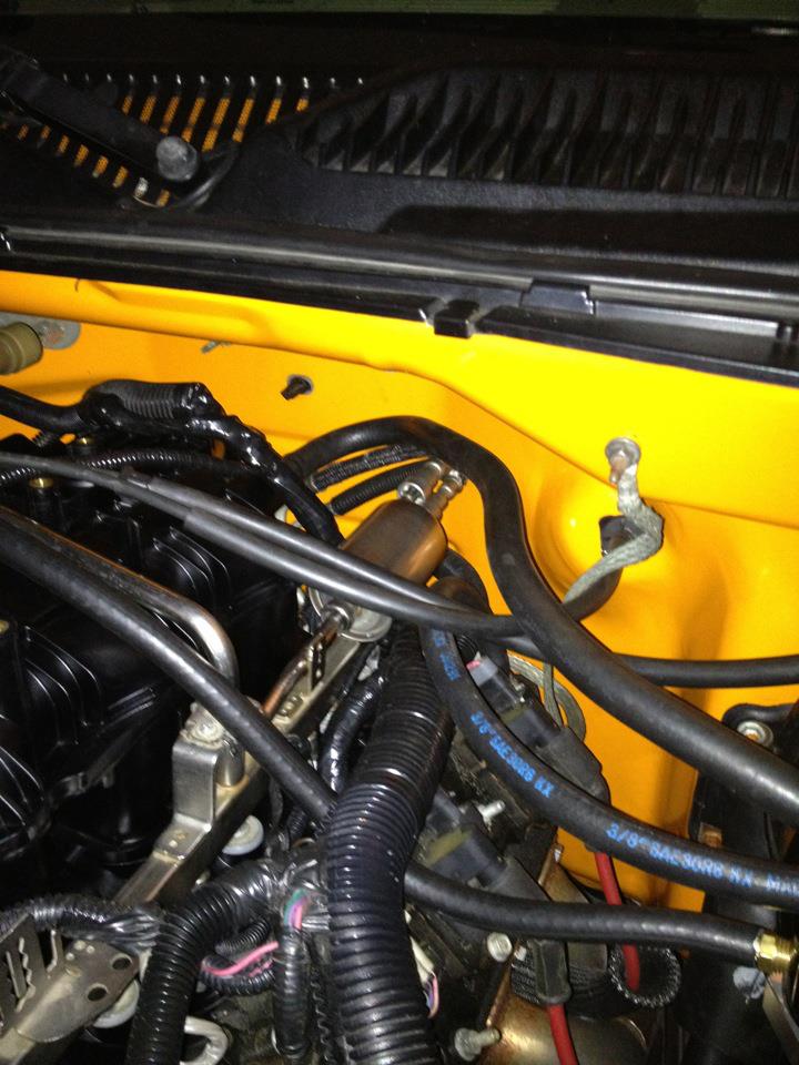

im running the stock 07 up NNBS/TBSS fuel rails with the corvette fuel filter its internally regulated to 58PSI so theres no need to run a fuel pressure regluator like on 99-03 return setup

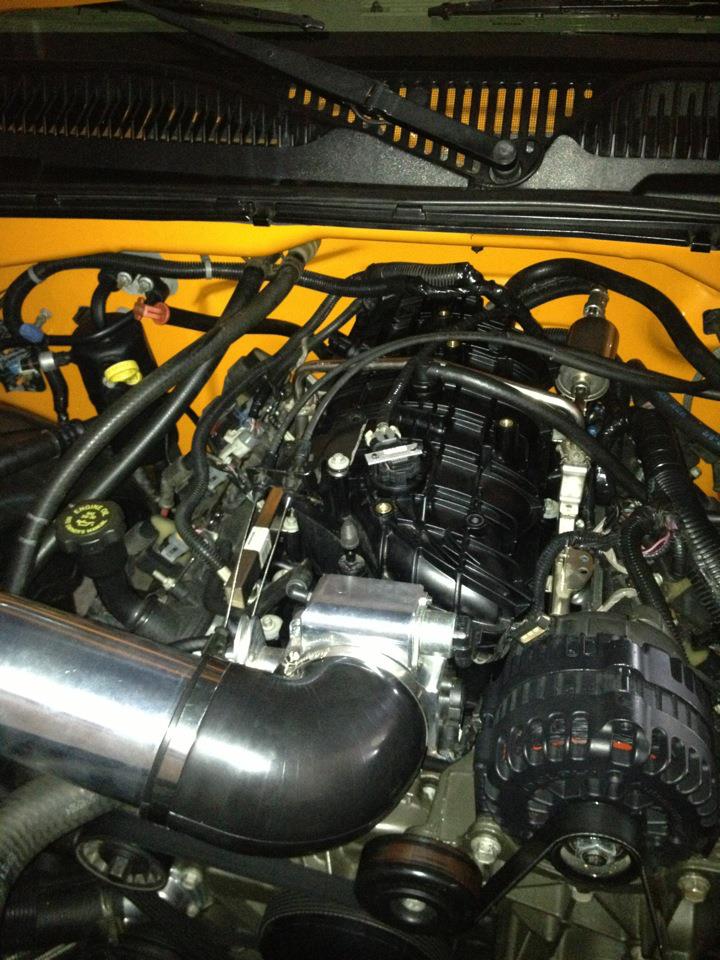

heres what mine looks like i might do a TBSS engine cover sooner or later Name:  421257_10152166921180051_1070906906_n.jpg

heres a pic of the fuel filter Name:  564446_10152166923350051_906947602_n.jpg

Your truck is too nice for a tbss intake imo unless you planned on covering it up with a nice cover, thought about the edelbrock intake any? would look great under your hood, i have no idea how hard it is to tune but it has to be better than a fast..
