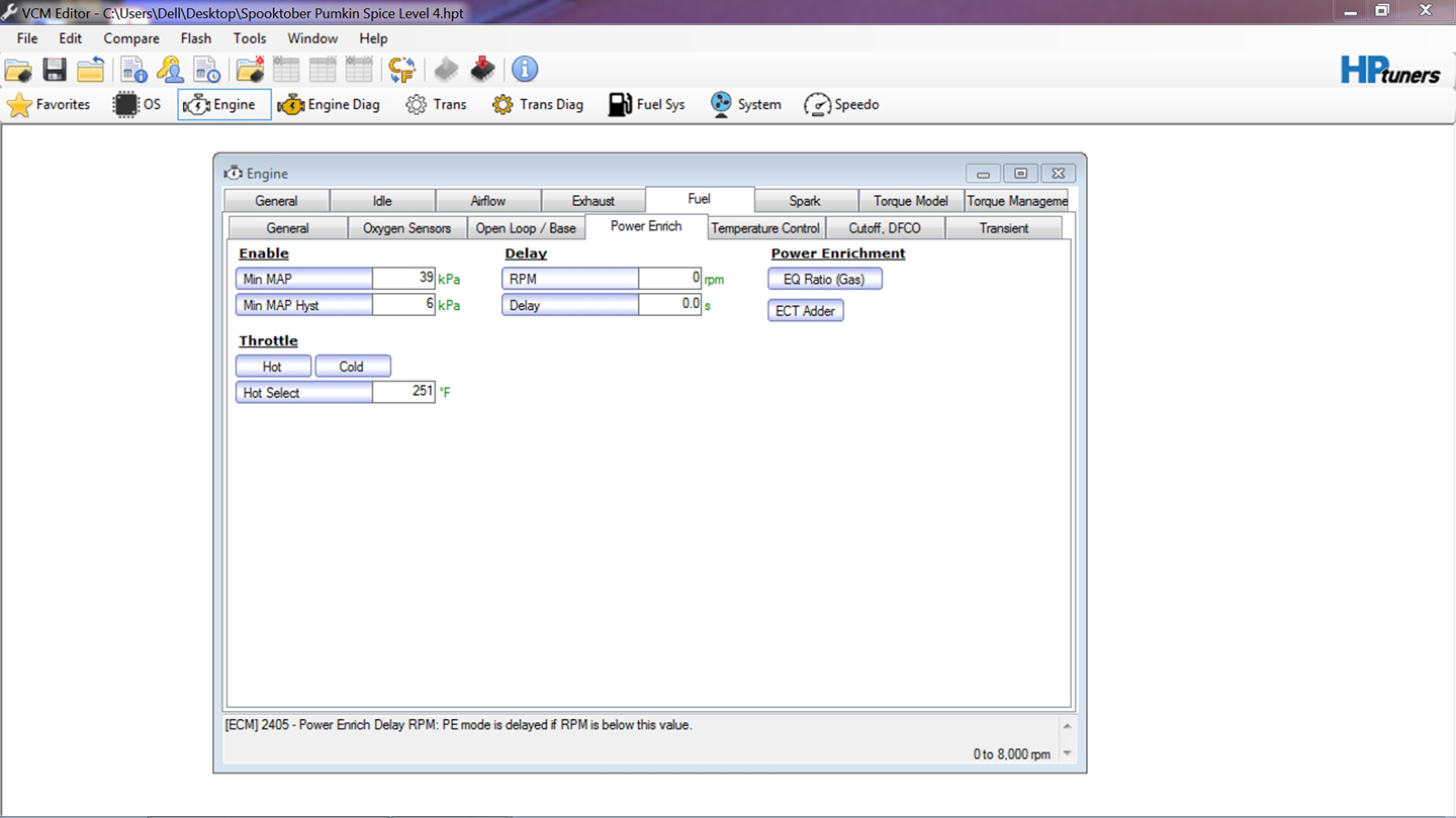

Well uh a new tune fixed it. Sort of.
Truck drives and idles fine now, no power loss and AFR looks good although it idled rich for a minute or two. BUT the truck still smokes. 2 month old gas now though so maybe that? I think the tune could be slightly improved but what do I know.
Log and tune below:
Why is PE RPM delay set to zero RPM's ? With it set at zero and according to the "throttle" table you'll be in power enrichment anytime the TPS sees 70% throttle. This will dump fuel in at low speeds when the engine doesn't need it. Raise that up to a sensible level, I have mine set at 3500 RPM's and some would consider that sorta low

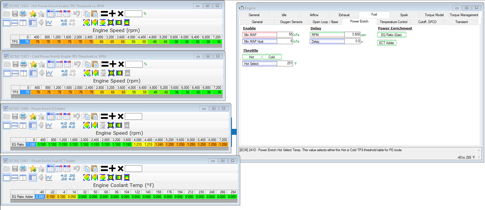

@RedXray Thanks Red I will make the changes to reflect that. Like I said this was just slapped together someone did for me. It definitely needs some work. I plan on starting the truck again today. I hope to have a rear bumper on it by next weekend so it will be street legal and I can actually get some logging done on it.
This is how it is setup now. Comparing with my old tune may not be the best start but I bumped up the delay and Min MAP. Everything else I left the same. The old tune has a lot of differences with PE.
