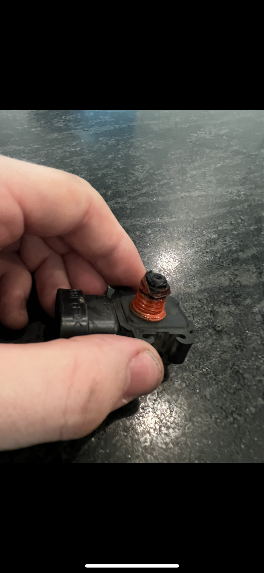

My fuel pressure is in spec to fire the engine. I am at 55 key on engine off.
I still am getting a long crank and then turn key off the crank again and it fires right up. Nothing has changed on that front.
here is my MAP sensor. Looks pretty gunky but I’m not sure. I will get a log here shortly of the truck as it idles.
how to log MAF and MAP information? Which channel do I use? When I search MAF there are a couple of options.
