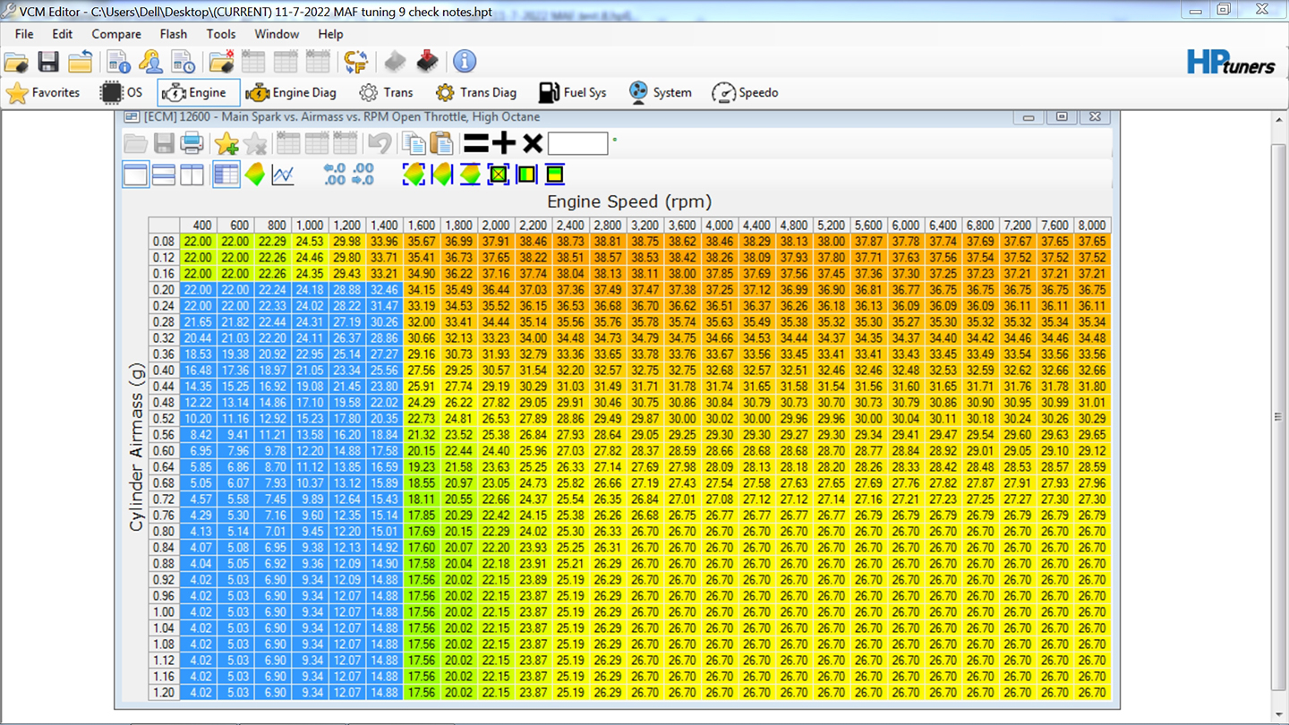

The idle fueling is close but you're getting quite a bit of KR at part throttle that's pulling time. It's not showing lean in the largest KR area on the scanner chart.
You need to figure out if it's false knock. Pull around 4 degrees in the area highlighted and see if it helps the part throttle knock. If it has no change it's probably false knock. You'll have to make the decision to desensitize the knock sensors (I had to desensitize but I tested with octane booster to be sure). You did mention you may have a tank of bad fuel. That could be the source... you need to do some investigating.
Don't forget to add those degrees back to the timing tables when you figure out the issue.
Then keep logging and smoothing out the fueling tables, you're on the right track.

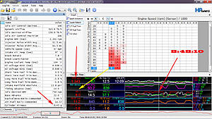

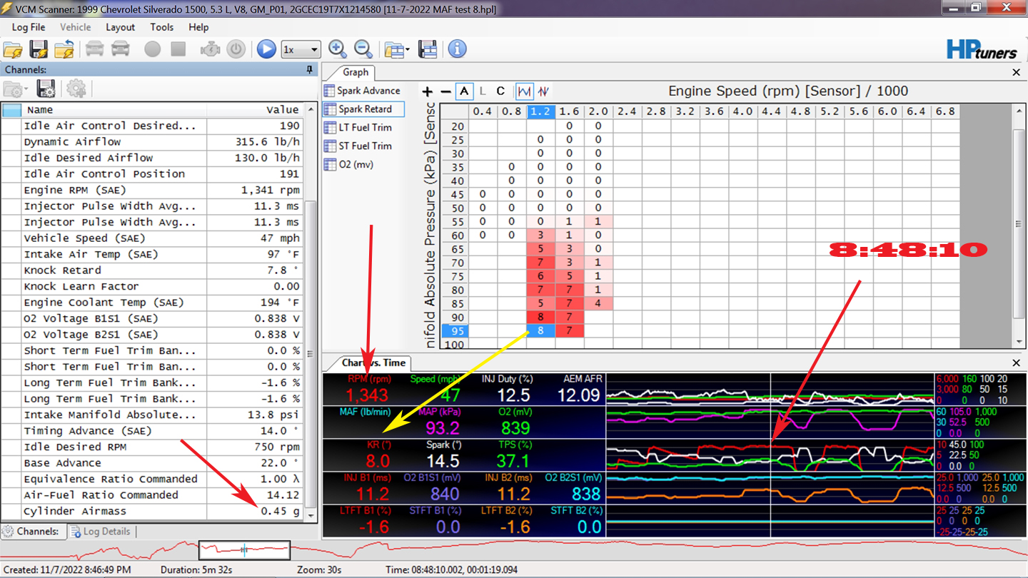

You're getting KR all through the log file. I froze at 8:48:10 where the most knock was recorded.
It's pulling 8* degrees of time during the KR event at 1,343 RPM and .045g Cylinder Airmass in the scanner log.

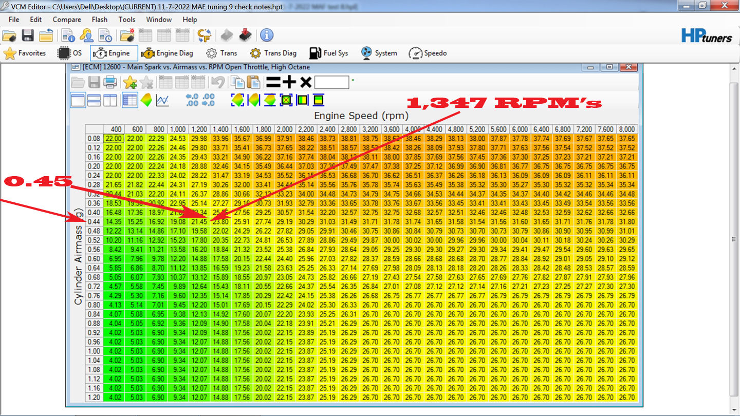

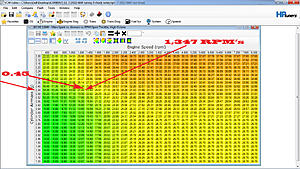

Taking those numbers and looking at the tune in the editor you can see the area(s) you need to address. If you take timing out of this area and it still shows knock it's most likely false.
The KR event at 8:48:10 is where the red arrows converge in the spark table (.045g and 1,343 RPM)

I can see that my AFR right there was 12.09 so I don't think it is a lack of fuel knock.
