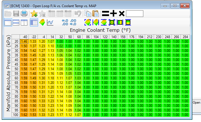

Originally Posted by shakenfake
The tune definitely needs work. Idle runs rich for way too long in my opinion
The rich idle in open loop can be adjusted by changing the tables in the Open Loop EQ Ratio table. In your mild winter climate I'd make all the tables 1.00 from 86* degrees to 284* in the table. The log shows the idle leaning out as it should around 135* 140* degrees. This table is like the choke on a carbureted engine so it's normal to be rich on cold startup.

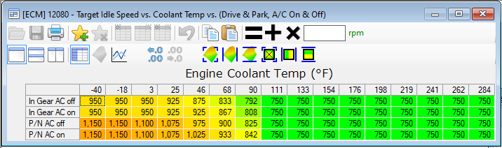

Thanks Red you make it relatively easy for me to understand these tables lol
Went ahead and did this, I sort of scaled down the rest of it back to match the new 1 86* and on. I think it should be fine.
Here is a picture of my idle as well. I used to idle at 650 so I think I may drop it down to that level or maybe try 600. I will try it after I load up this new tune though. Don't want to do too much too soon.

In the idle table I usually add 50 RPM over the base idle with the AC on (in gear)
If I set the "In Gear AC off" to 650 RPM I'll set the "In Gear AC on" to 700 RPM.
P/N AC on and P/N AC off (in this scenario) I'd match the "In Gear AC off" at 650 RPM.
Of course YMMV
