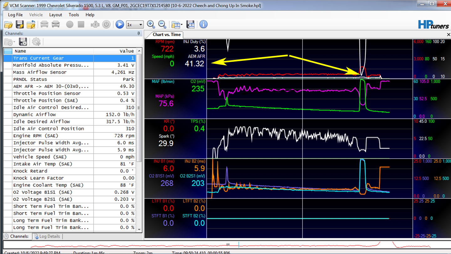

I'm seeing 41.xx AFR on the wideband in my scanner. If correct it's SUPER LEAN so lean it's off the chart in the VCM Scanner! When the RPM spikes up by itself in the video... the AFR comes down to a rich idle spike at 10.9 AFR.
Does your scanner show the super lean AFR? We have the same wideband... somethings off
Left yellow arrow shows Lean AFR--- Right arrow shows 10.9 AFR (white spike line) during the RPM spike
I see the super lean AFR reading as well, is it possible it’s burning coolant or oil and messing with the sensor reading?
