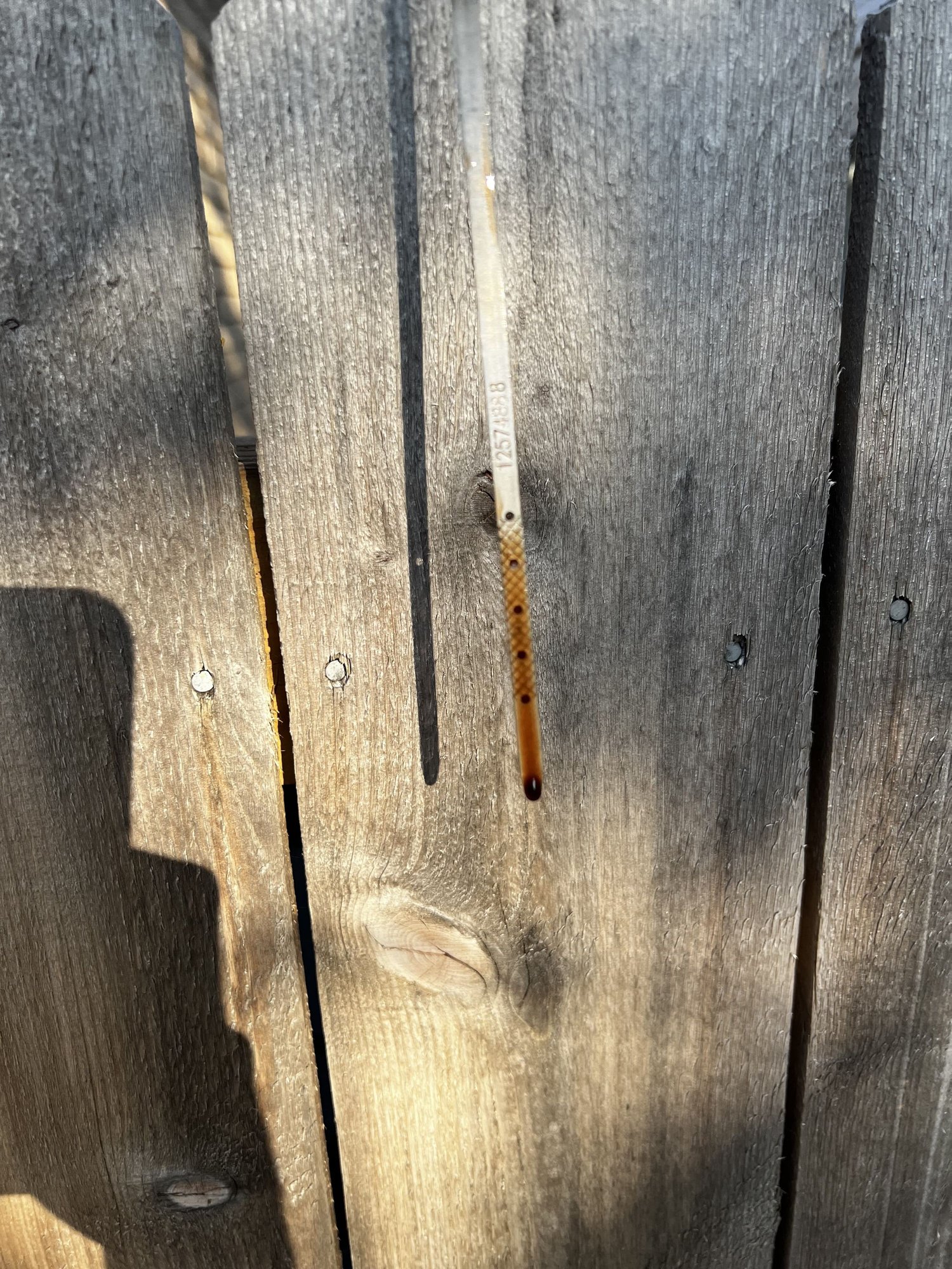

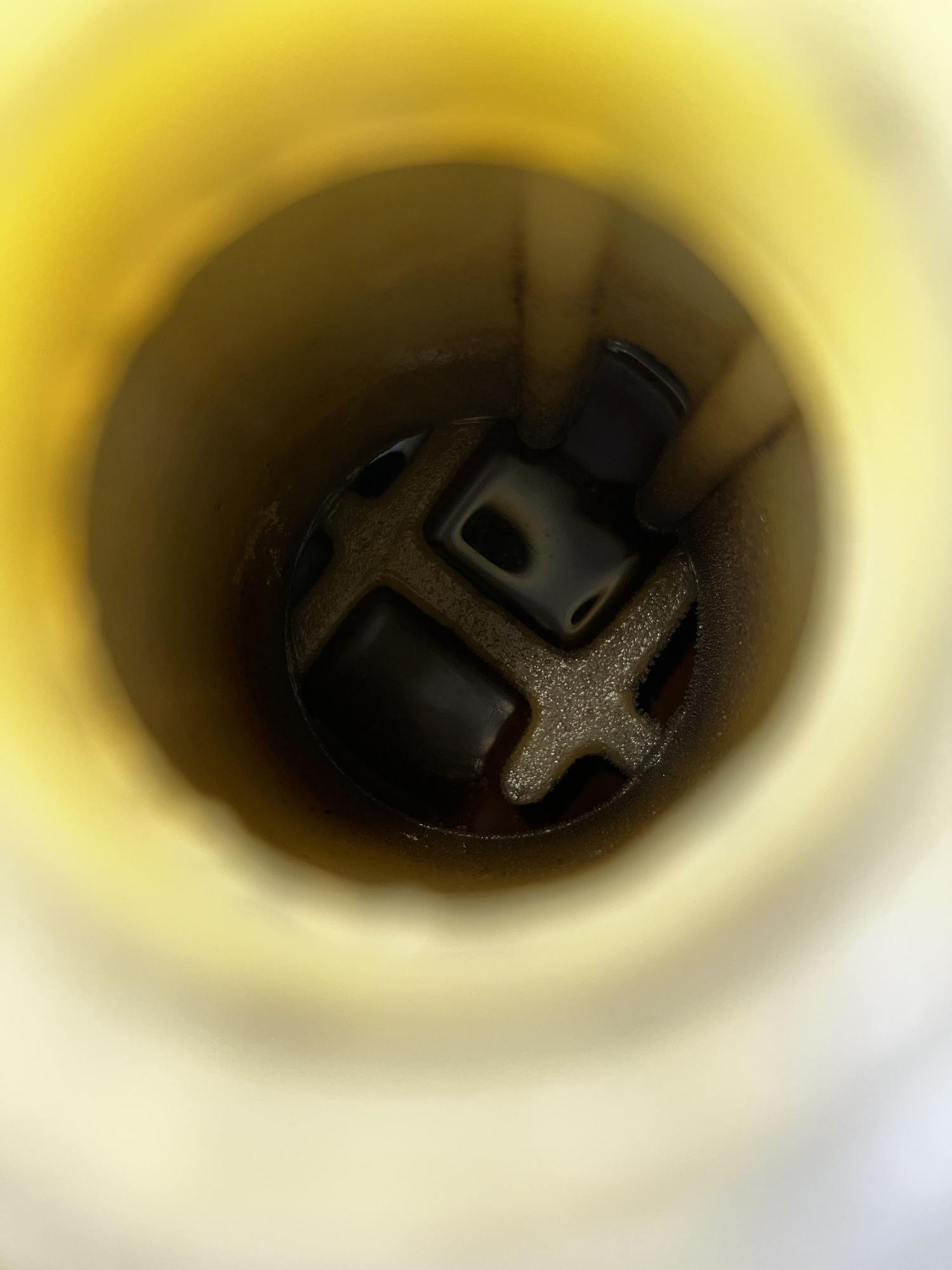

Oil and coolant look good to me. I am blowing so much smoke out of the tail pipe that you would think these would be major low

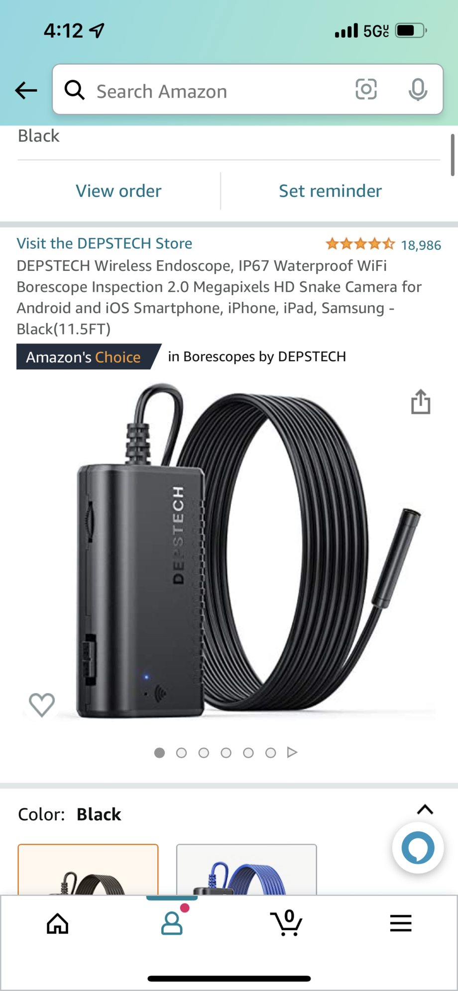

I have a $30 borescope that uses wifi to connect to your phone it works great for looking down holes
