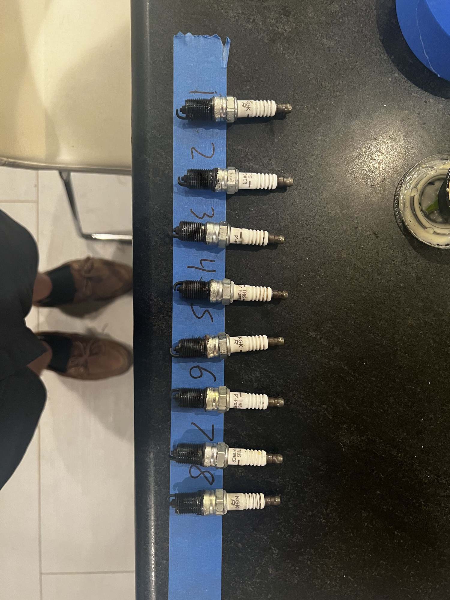

Nice and wet. Personally they smell somewhat like a mix of oil and gas. I don't know, my nose I guess may not be calibrated.
This kind of leads me back to thinking pressure regulator again. Also I had the pressure gauge hooked up for about an hour and it only dropped down to about 40 PSI in that time.
