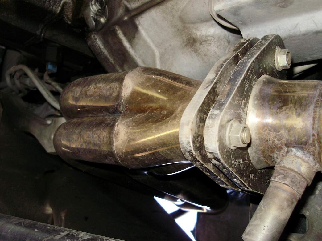

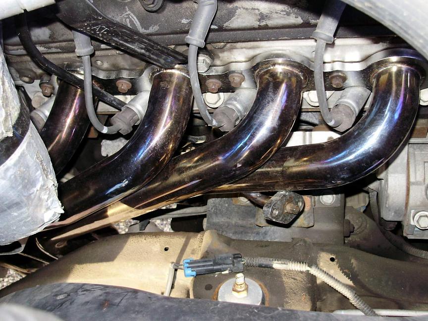

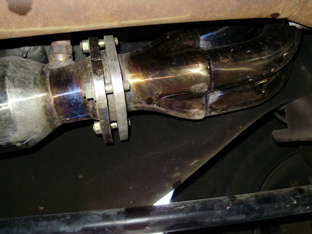

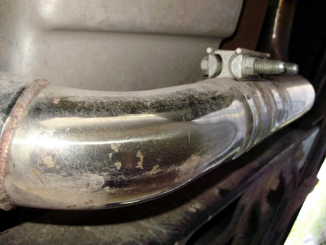

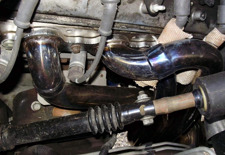

can you get some pics of how they are holding up? (coating)
Old 12-17-2009, 02:56 PM
  #49
11 Second Club
rel3rd's Avatar
Join Date: Nov 2005
Location: Baltimore, MD.
Posts: 1,643
Received 4 Likes on 4 Posts
Here's some I just took a half hour ago. They've lost that fake chrome look (which I didn't like too much anyway) and look like "real" stainless steel now.
Don't mind the crud, I work in a steel mill so my truck (and exhaust) is not "show worthy" , lol. But they look better in person, IMO.

they look nice. Those are the OBX headers or the $320 ebay ones?
